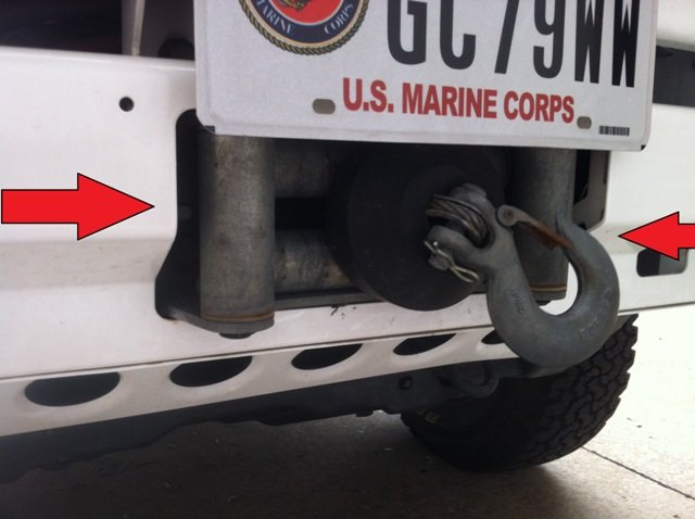

    I am going to replace my steel wire rope with synthetic, and I will need to replace my fairlead roller as it has some burs in it from the wire rope.
    But I'm not sure I should go with a hawse style fairlead, or go with new rollers for the synthetic rope. The ARB is not really designed for a hawse style, and I worry the winchline might rub on the sharp corners of the bumper. Anyone have any advice on this?

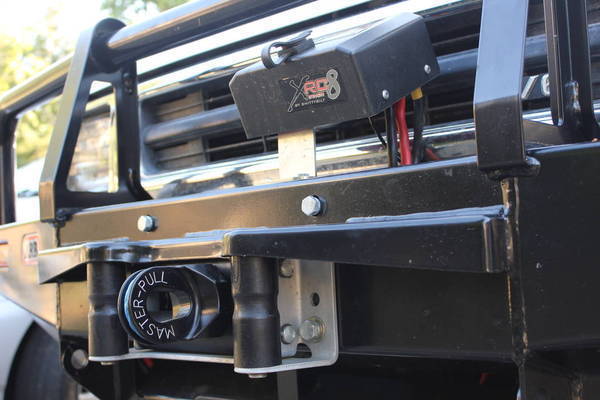

    Here's a pic of my fairlead from a different thread. The large bolt on the fairlead is the bolt that holds the winch to the bumper. You can see that it's lower than the centered, factory-drilled hole on the fairlead. The hole in the bumper that allows the rope through still lines up with the fairlead hole, but only with that lower bolt. I think that's a bit clearer.
    Of course, this isn't a tacoma, so it might be different. :notsure:

    Thanks for the reply, I think I will go with the synthetic rollers.
    Here is a pic of how my bumper looks currently with the steel rollers. I just dont think a hawse style will work being reccesed back into the bumper like that.
    The arrows point to the area Im concerned about the synthetic rope rubbing if I had a hawse style fairlead.

    :eek: Oh wow, that's really recessed back in there! Yeah, I would definitely go with rollers.
    You also might have a problem with your license plate there if you do a pull. Just something to consider.
