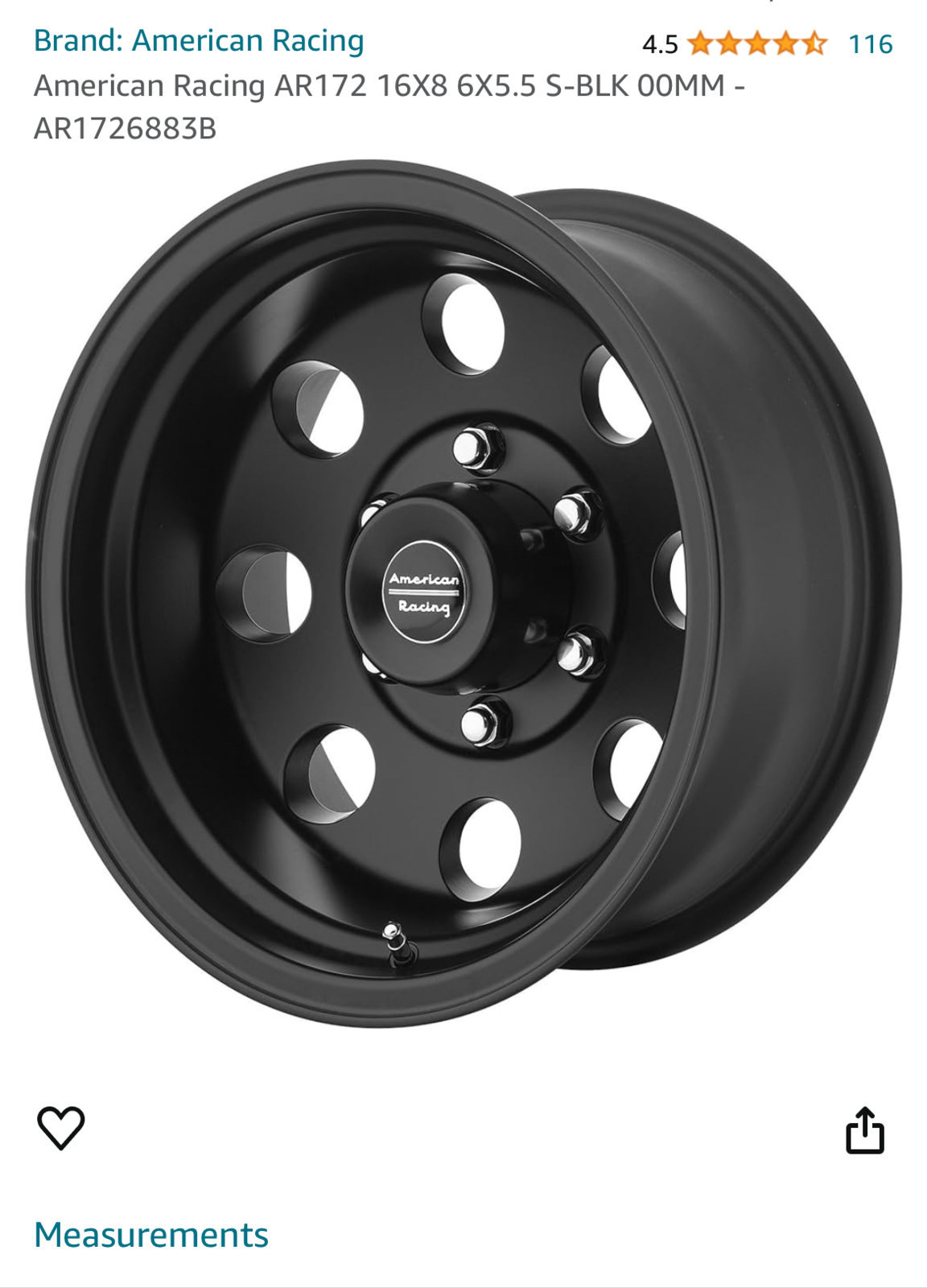

    I plan on running a 265/75/r16 on a set of 16x8 rims from Amazon and the offset appears to be 0 am I going to encounter any issues with rubbing?

    Welcome to Tacoma World. The answer is "probably not" but can't say for 100% sure since every truck has small variations from the assembly line and you never know for sure until you check fitment on your own truck. But very very low chance you have any problems, other than the typical changes associated with that size tire like having to modify or get rid of mudflaps in the front (nothing major though).
