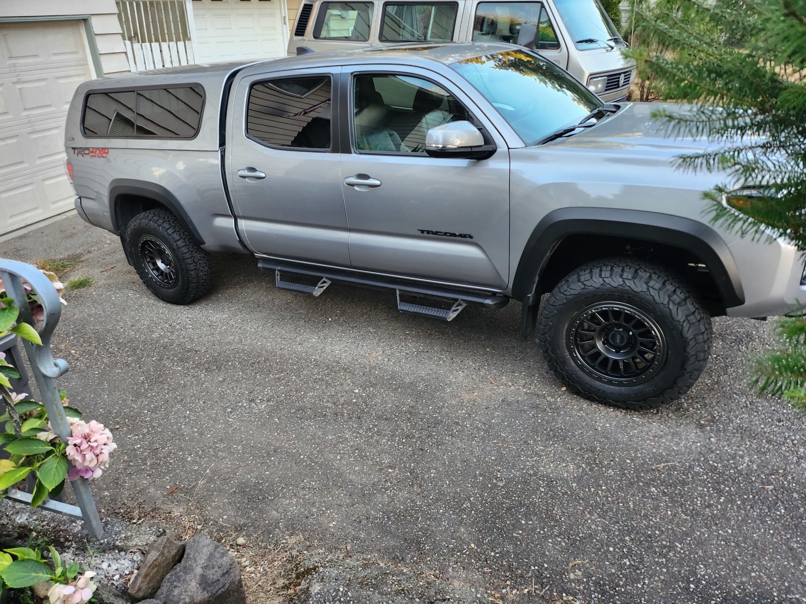

    My 265/70/17's with zero offset rub occasionally with 8.5" wheel. I trimmed the mud flaps and since then very few rubs. I spent countless hours researching and cross referencing and quite a few members claim no rub with the exact size tire offset and wheel I have. My 2 cents.

    I will take a front pic tomorrow when it's light if you like.

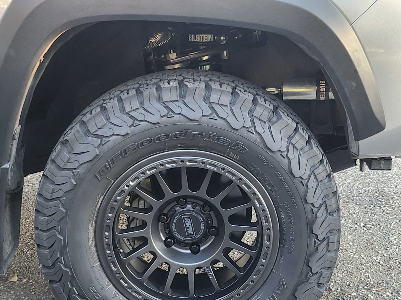

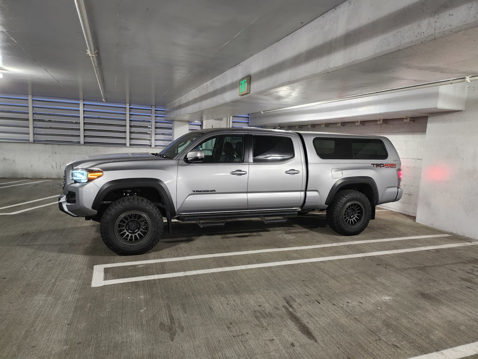

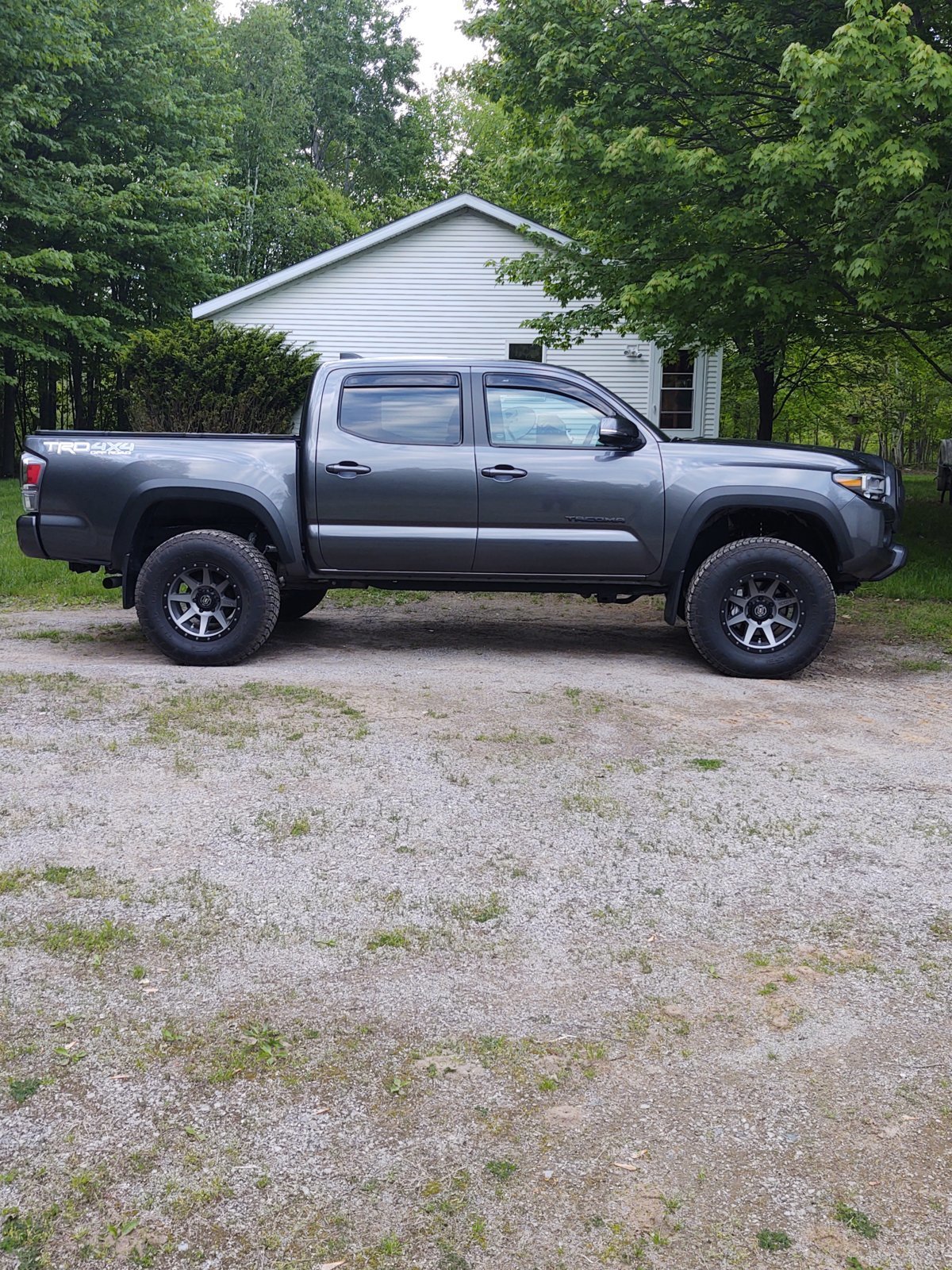

    Bilstein 6112's 5th clip 1/4" spacer driver's side. Icon tubular UCA's with Delta joint, wheelers superbumps, ECGS bushing. Allpro standard leaf packs, 5160's, U bolt flip kit with wheelers super bump's, extended stainless steel brake lines, carrier bearing drop. Icon rebounds 17" with Nitto terra grappler G2's 285/70/17's.
    IMG_20220523_201618060.jpg These wheels are 17x8.5 0 offset. 4.75" backspacing. The tires are 285/70/17"s and are listed as 11.5" wide. Should give you an idea of what it would look like.

    Do you have a lift? I was thinking the 285/65/17 as I do not have a lift, but they are listed as 11.2 wide. Your trruck has the stance I am looking for.
    I do have a 2 3/4" lift but I don't think it has as much to do with tire clearance as most people think. I have ICON tubular UCA's that allows an alignment with +4° positive castor, (adjusted at the LCA, very important,) which moves the wheel forward in the wheel well. This, along with the 0 offset wheels is what gives the clearance for the larger tires. IMG_20220523_201755891.jpg

    Ok, that makes sense.... Did not know about this.

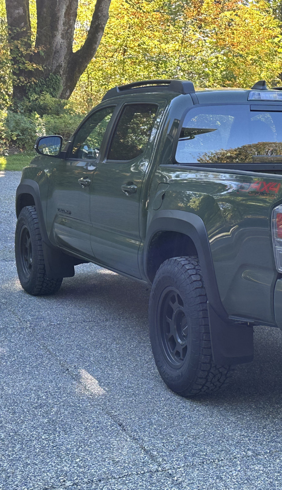

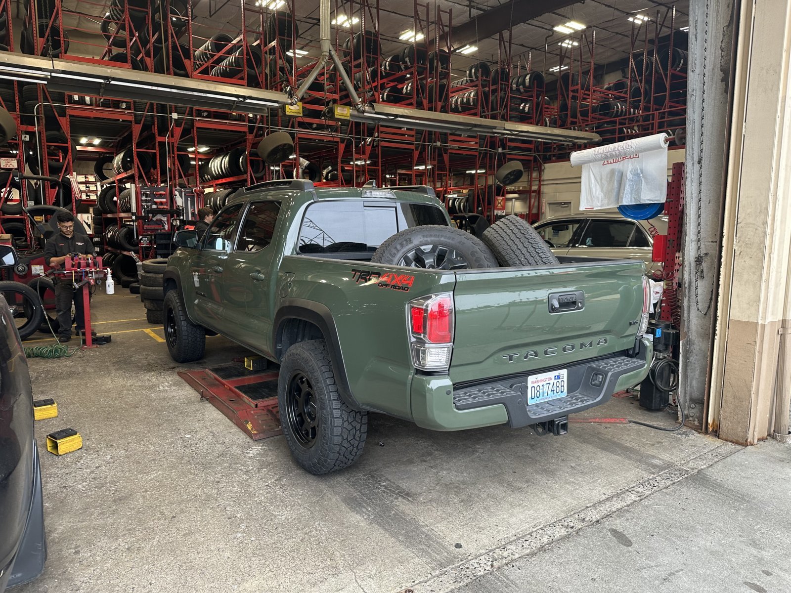

    265 70R/17 on 8.5” 0 offset Methods
    upload_2023-12-23_10-29-16.jpgupload_2023-12-23_10-31-26.jpgAdding an inch per wheel (from stock OR’s)gives me 2” and another inch and a half per the offset gives me 3 1/2” wider stance overall. They only poke out a little but the handling difference is gynormous
    Edit: they rubbed a little on my plastic mud flaps so I removed them and they rub very little on super tight slow speed turns but not enough for me to start chopping stuff. I kinda liked the mud guards so I still might mess around with it when I get my steps installed
