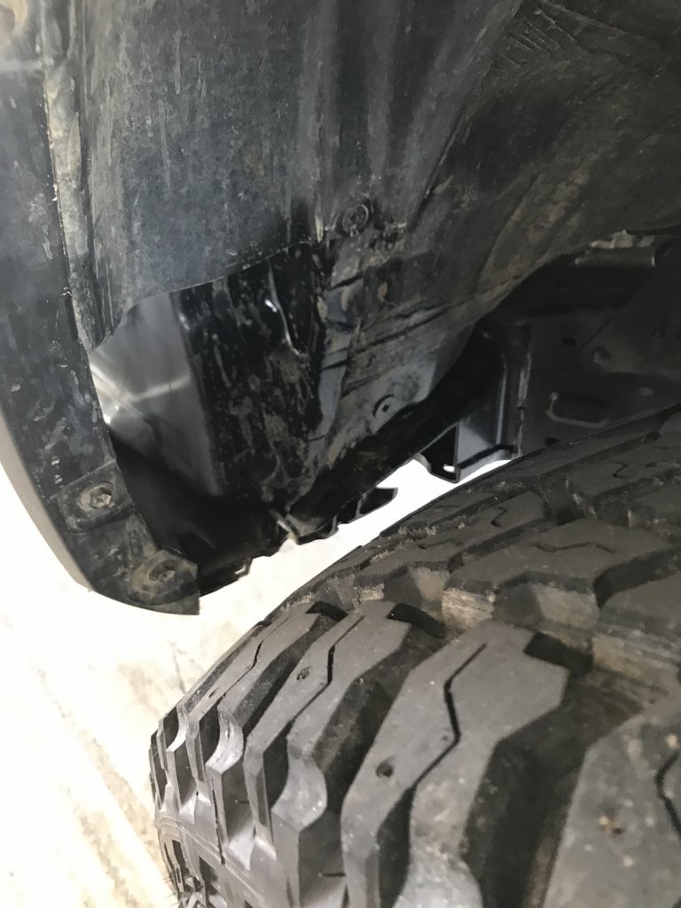

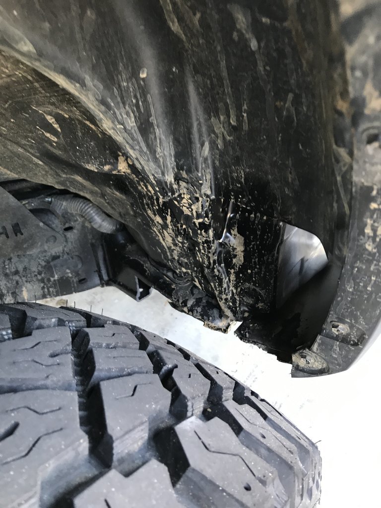

    About 1.5”, I have it set to the preset settings from icon. Running an icon stage 2 suspension, that in mind it’s the offset that is more important than the amount of life on the truck. The offset is what will make you rub on wheel well or cmc, gotta find that balance where you don’t have to trim so much

    I’ll post some pics of what is done

    Rubbing where?
    Wheel spacers will help backspacing clearances, but, makes it worse for cab mount/mud flap and pinch weld clearances.
    With 3" of lift, you'll likely need less backspace than stock, via spacers or new wheel width/offset.

    I had a 2-2.5" lift on my 2016 over two different brand lifts. 4.5B wheels. 285 tires.
    Outside of a little plastic trimming mine didn't rub. Even off road. :notsure:

    Thanks for the pics.
    So no rubbing on frame other than on the cab mount?
  14. Oct 4, 2017 at 4:46 PM
    #34
    chrisrocks300
    chrisrocks300 War Eagle
    Mar 11, 2017
    #212994
    7,419
    Brandon, MS
    2016 4x4 Tacoma DCSB Trd Off-road Superwhite
    Total Chaos UCA's, Raceline Raptor wheels (16x8) 4.5 BS, 285/75/16 Cooper S/T Maxx tires, Icon Stage 2 Lift Kit, Sos sliders w/ fill plates, exhaust reroute, mobtown offroad skid plates (ifs, transmission, transfer case), and diff breather mod
    No sir.
