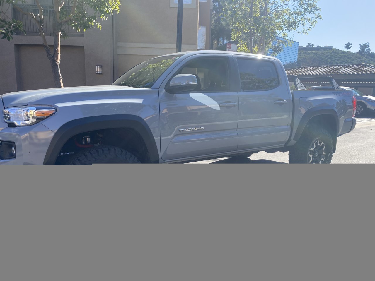

    I am literally trying to do the same thing. so this is perfect thread for me.
    I am curious if he had to add spacers.
    I have a 17 TRD off Rd.
    Just bought the Fox Level 2 Kit and am hoping to run some 285/75/16 with the trd wheels.

    this is sick man.. gives me hope that my Level 2 kit will fit with the 285/75/16's.
    I am hoping for a similar result. I think, once I put my kit on, I will only get 1" in the front, do you think it will rub?

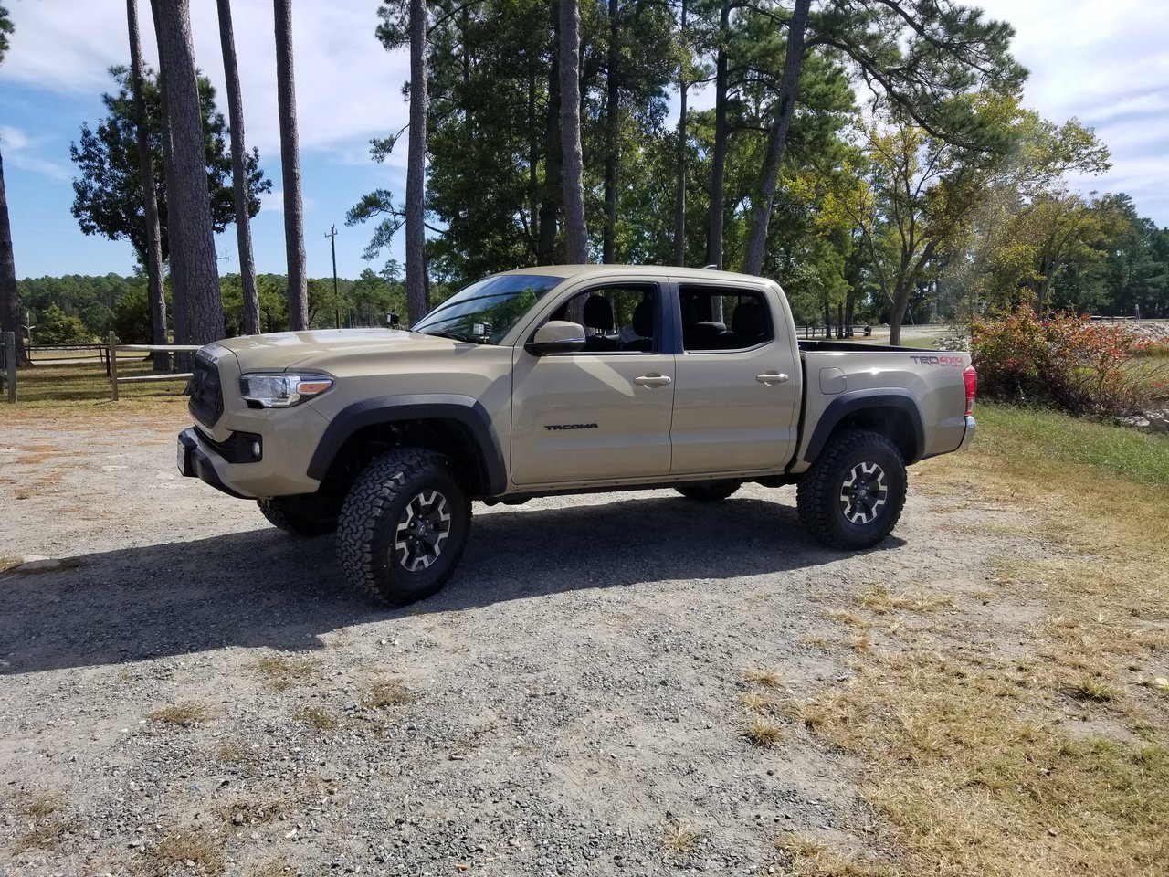

    2018 TRD OFF-Road
