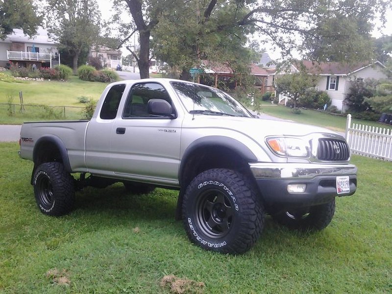

    $500.00 project 04 TRD 4x4 Lifted 4runner Stock Tacoma TRD Lifted 94 FZJ80 Stock 95 FZJ80
    Toytec Boss kit & OME leafs, 231mm tundra brakes SCS wheels...
    16x8 3.5 bs. with 265/75 duratracs.

    265/75r16. Not sure of the exact measurement but they are a little taller than the original equipment size 265/70r16.
