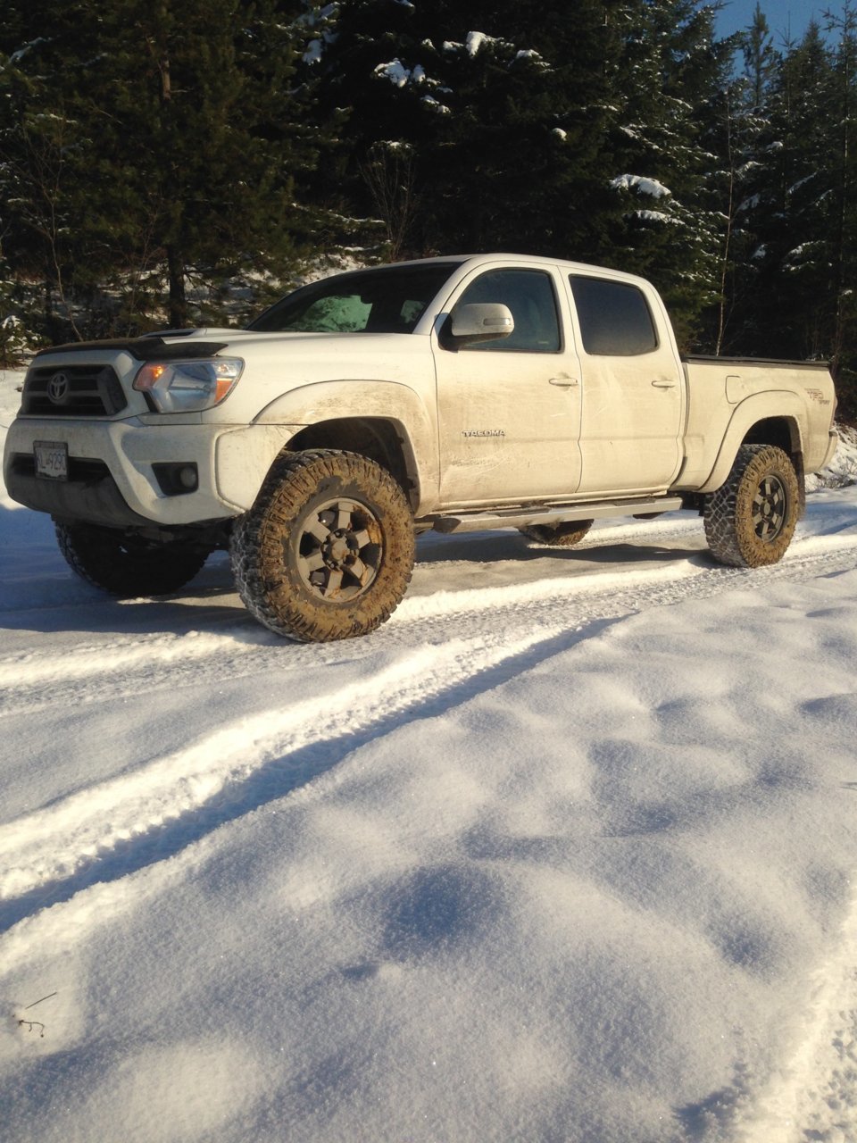

    My truck is regularly driven on rough, wash board roads. It has started to feel “looser” over the last three years with a couple squeaks and knocks here and there. It feels fine on pavement but there’s a few sounds that I have especially noticed this spring. I’m hoping for some recommendations on some of the regular things to check to maybe tighten up or lube. I miss that tight Tacoma feeling like when I first bought it three years ago and it didn’t make a sound off road. Thanks in advance for suggestions.
    CBF559DC-4E96-467B-B403-55F95A7C019F.jpg2” suspension lift all around with duratrac 285/75/16
