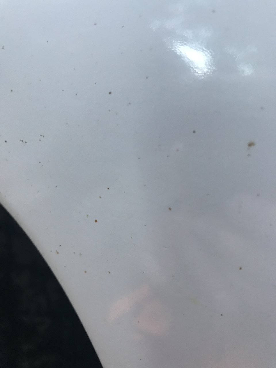

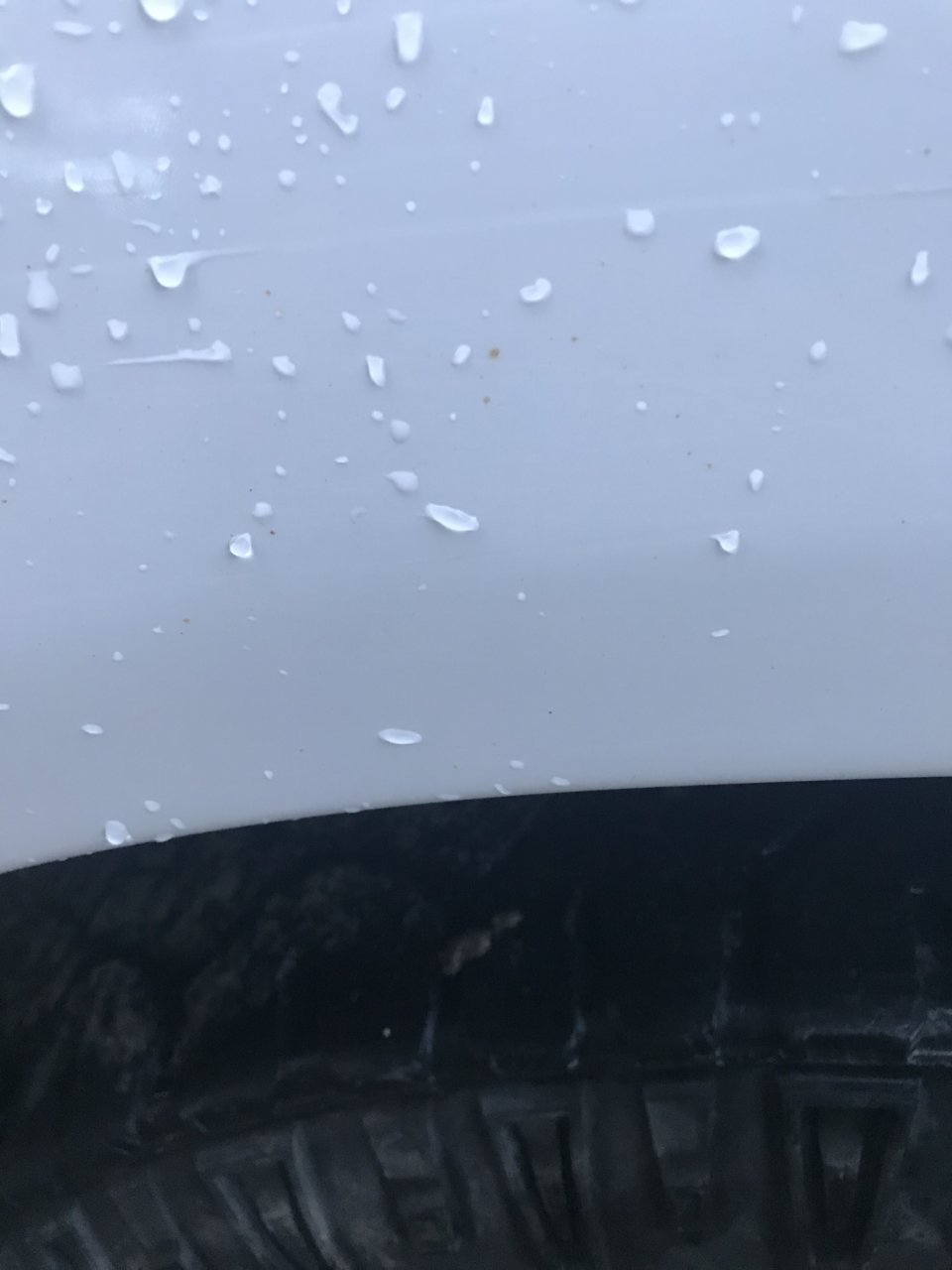

    It's housefly sh*t. Have to use a more agressive cleaner. Try Simple Green. Keep the truck waxed, even if it's dirty ten minutes later. Not for looks, for protection. The spray on waxes are fine.

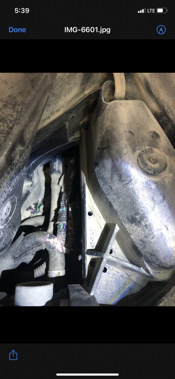

    Just had my truck in to do the secondary air injection pump. About a month ago the engine light came on and didn’t turn off and I’m burning a lot of fuel.
    they swapped out the air pump and found a chewed wire and the code for cam position sensor is thrown.
    they suggest I can get it fixed through insurance- is this something I can fix myself? Is it common?

    Here is the photo I just received from someone at the dealership. Can’t quite tell where this is but they said I have to take the intake off to get at it.. if the damage is just along a wire or two I’m hoping I can just spice ? Damn rodents. 16F6B23E-4723-4DA3-AA52-D1DF8DA1C3FE.jpg
