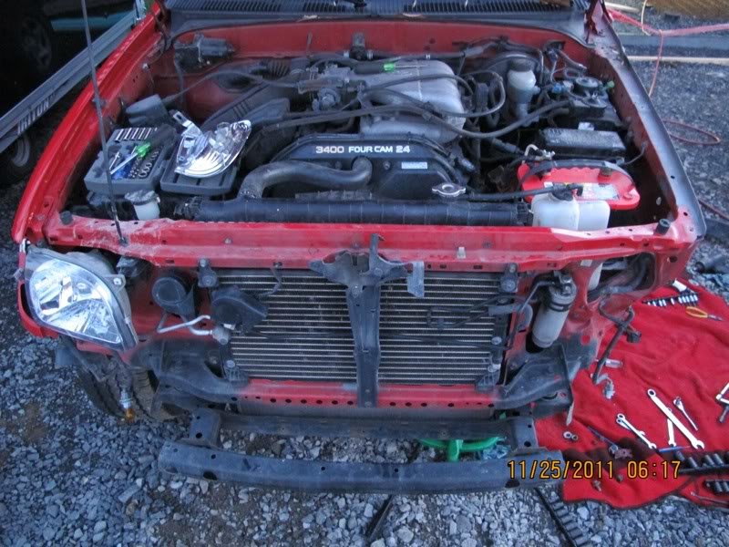

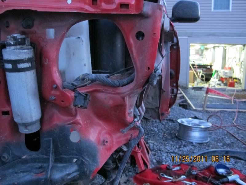

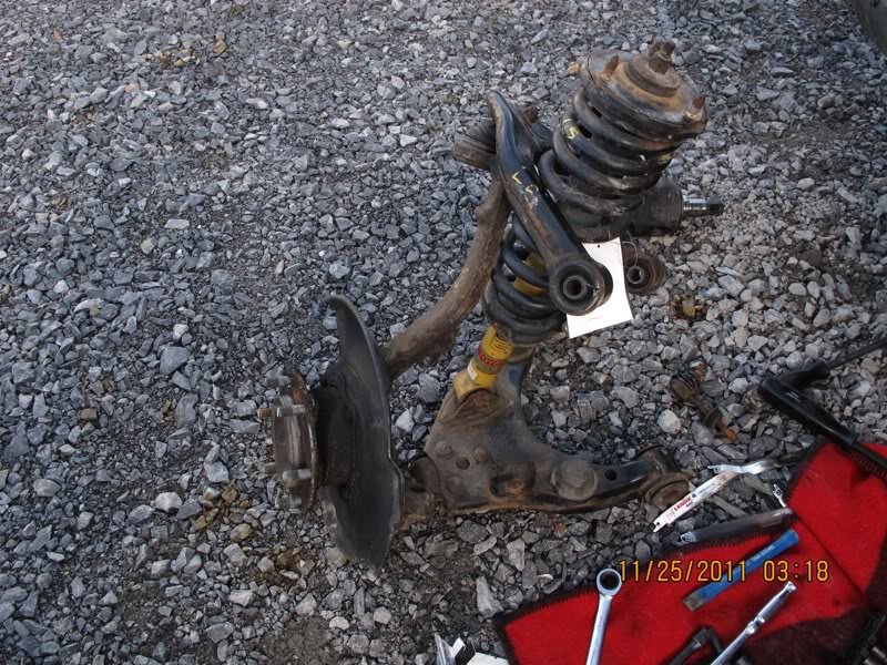

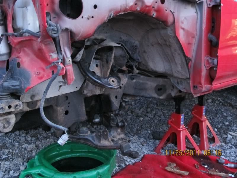

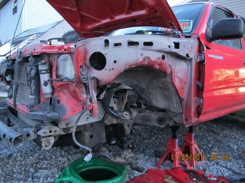

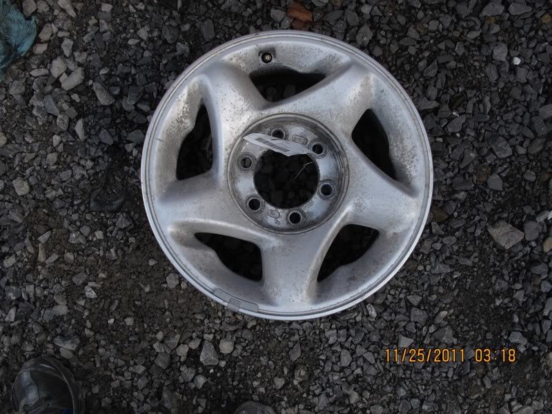

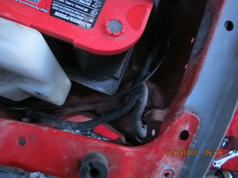

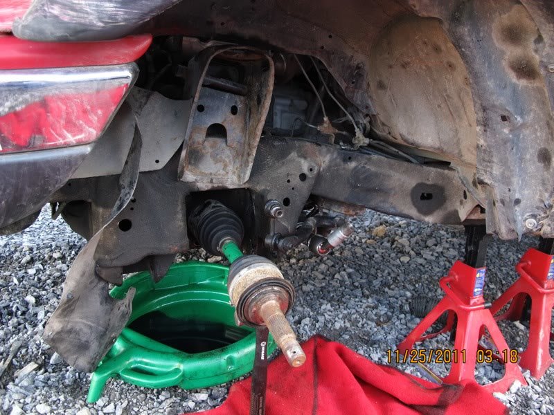

    I spent some time Wednesday afternoon pull off all the old bent and broken suspension and steering parts. Inner and outer tie rods were bent. Rack still moves perfectly smooth and does not leak, so I might be safe there. I ended up having to cut the rear lower a arm bushing out. The inner sleeve/cam was seized inside it.
    New used parts ready to go on...
    New used wheel...
    Worked on the truck again today. Got the upper and lower A arms on. Have to take the knuckle to get the prerunner spindle pressed out and the 4wd one pressed in. Also pulled off the bumper, fender, grill and other things. Rails are straight, no kinks. Truck actually has less structure damage than I originally thought.
    Should have the suspension done and it on 4 wheels and drivable Monday or Tuesday evening.
