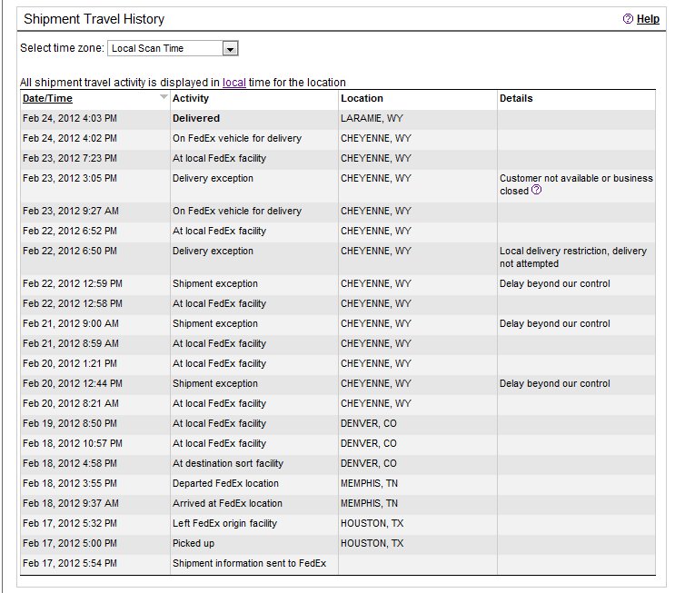

    Well it finally arrived and is working. For now.
    Took forever to get back to me. Stupid fedex.
