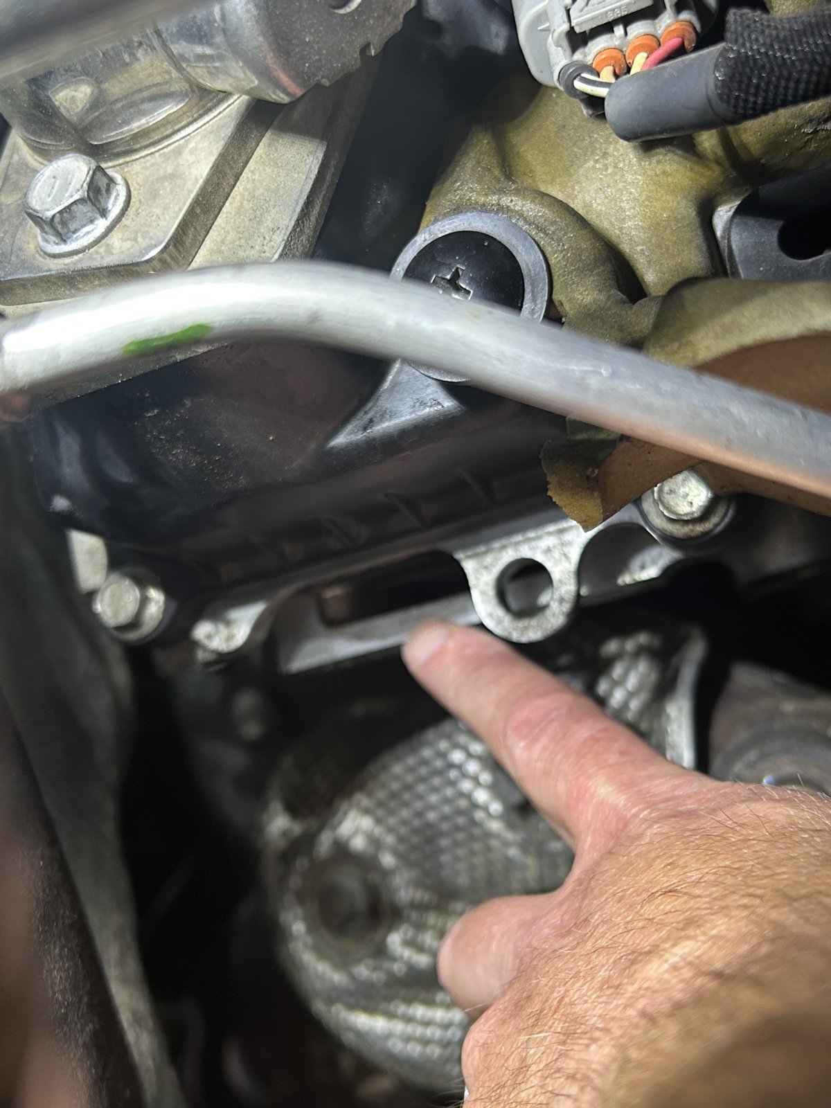

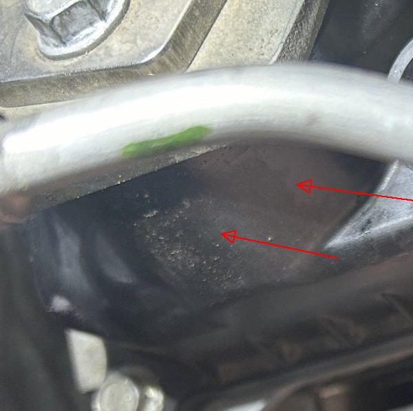

    I have had the timing chain cover leak fixed under warranty, then had to have it done again, out of warranty,last month some pump behind the oil pan was leaking and this month my radiator took a crap. And getting home today I noticed the smell of burning oil, I popped the hood and saw oil on top of the passenger side heat shield,upon further inspection I can see oil filling up in this aluminum recess on the head. My truck only has 86,000 miles and change on it. Has anyone else run into this? Thanks in advance.

    The leak appears to be from either the high-pressure fuel pump flange or the valve cover gasket. Suggest you clean the area with a mild degreaser and monitor.

    Looks like valve cover gasket. Shame to see these popping up on 2016-2017s. You had the timing cover done twice and they made you pay the second time?
    Motor out both times? Master tech ?

    I see this in the photo suggesting it may be from the fuel pump flange. Need to degrease and monitor to be sure:

    Umm, thx I guess . I needed a truck in 2016 and went with Toyota based on their reputation of good quality. I got burned sadly . I’ve cleaned the spot and am watching it . I don’t see oil up top it’s just below the valve cover . It actually looks like there’s a piece in between the head and the valve cover and I think that’s where it might be coming from.

    You better hope thats not the cam bridge leaking. 5.7 tundras are bad about it. Cams have to come out to reseal that.

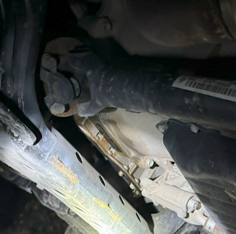

    But have you checked your rear main seal?!? Just found mine leaking on my 17’ with 73k miles.

    Definitely looks like the camshaft carrier leaking. It is sandwiched between the cylinder head and the valve cover. There is no "gasket" it is FIPGM or sealer. Bummer for sure.

    Not dripping yet I don't think. I'm not sure how long it's been leaking, but you can definitely tell. Found it when I removed my skid the other day. It's going to the dealer under warranty next weekend. Crossing fingers they wont deny the warranty claim (extended warranty)

    I saw that too, however the dust below that on the valve cover is well, dust and dry, also the darker or damp area does not appear to extend all the way down the valve cover it seems to end well before reaching the gasket area. The sealer is clearly wet, but to your point it could be coming around where we cannot see in the picture and it does look like fuel pump flange gasket is leaking at least a small amount.
