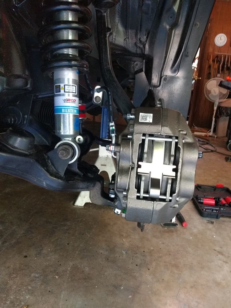

    While replacing the wheel bearings, I decided to just replace the brakes with whatever O'Reilly had on hand with only one requirement to run Wagner Thermoquiet brake pads. I run Wagner TQs on four cars already, so I might as well make it five. They are a clean and quiet modern pad GG stopping level pad that do not require shims. I gave up using shims about the time I stopped using CRT monitors.
    If I cannot get Wagner TQ, then I will settle for Akebono. Both are GG level pads that perform well for me. Its just a matter of convenience at the time of purchase.
    Outside of that, I got over boutique brand pads and rotors a few years ago.
    My 99 Prerunner, with me in it, weighs around 3,400 pounds. We're not talking about a 5,000 + pound vehicle. The stock brakes calipers have 4 pistons. It has plenty of stopping power for a vehicle of its weight. It will never be carrying much load or pulling a trailer.
    It does not have ABS brakes. After today's brake upgrade, I can easily lock up the front brakes -- more than I want. So it will take some adjustment on my part to keep from locking up the brakes after this upgrade.

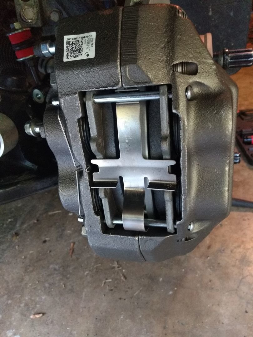

    I want to post some pictures of the differences between these new O'Reilly rebuilt calipers and the originals that may explain the sharp improvement in stopping power.
    The O'Reilly rebuilt calipers have some type of powder coating to for rust protection. Nothing flashy.

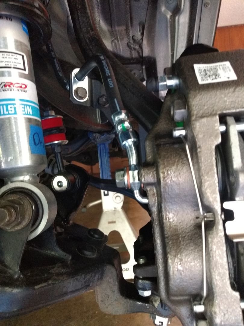

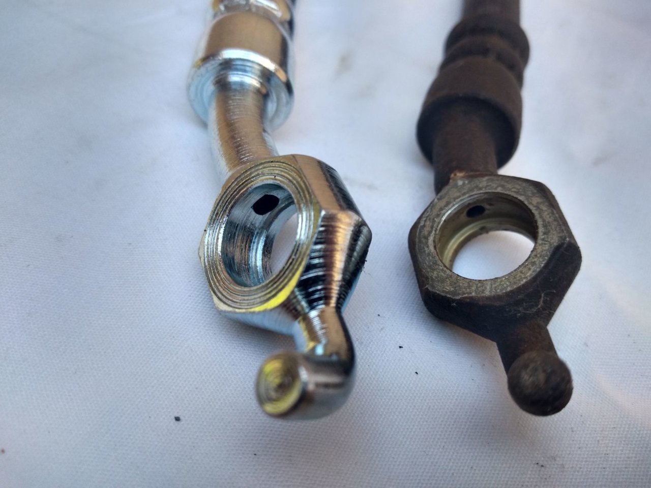

    I went with the O'Reilly brake hoses since the SS lines I ordered were wrong. Story in another thread.

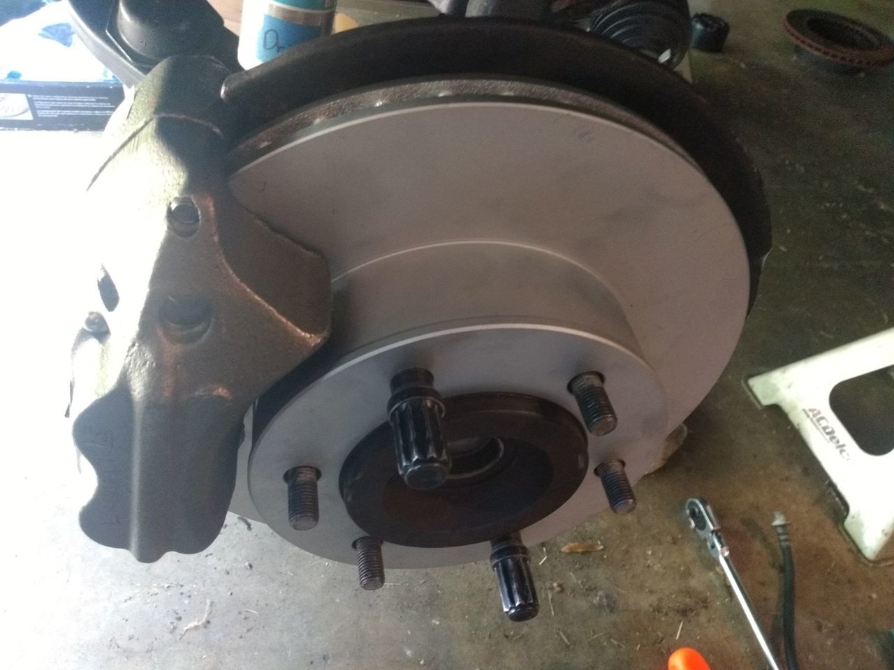

    Bosch Quietcast Rotors. The old rotors were causing vibration. These rotors made a big difference. They have some type of special coating to prevent rust.

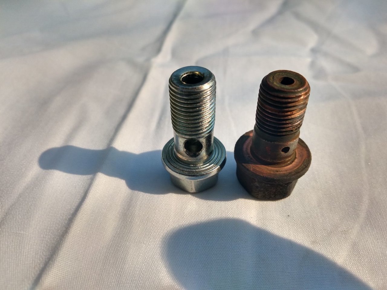

    The the banjo bolts that came with the O'Reilly calipers have a larger bore compared to the OEM. This may explain why its easier to lock up these brakes compared to the originals.
    The O'Reilly brake line has a larger fluid passage area compared to the OEM.

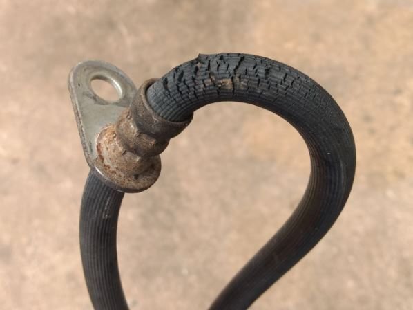

    Picture of the 20 year old old line at 228,000 miles that triggered the brake refresh.
    At the end of the day, I couldn't ask for more stopping power. If I intended to pull a heavy load, I might have different requirements. So far so good with this combination.

    Replacing all those parts will definitely make a difference.
    When I replaced just the stainless lines front and back there was a BIG difference.
    I then decided to replace the booster and brake cylinder just for the hell of it because of my miles and there was an even bigger difference. That was actually a nice surprise for me.
    Like you I can lock up my front tires and I have all the braking power I need and then some.
    Looks great.

    Here's a picture of the original line at 20 years and 228,000 miles that triggered the brake refresh.

    Yea, putting full brake force will expand those lines and give you a softer brake pedal,
    Your rears are probably the same, it’s just rubber that fails from time.
    Mine were the same Front and rear Like that with cracks

    Yes indeed. I thought it was kind of odd that the LCE kit didn't come with new banjo bolts considering the price.
    Since the O'Reilly calipers came with some BIG honking banjo bolts, I didn't care. But I still thought it was strange.
    EDIT - I would be interesting to see if a BIG bore banjo bolt can be ordered separately for the people who installed stainless lines and still running the OEM size.
