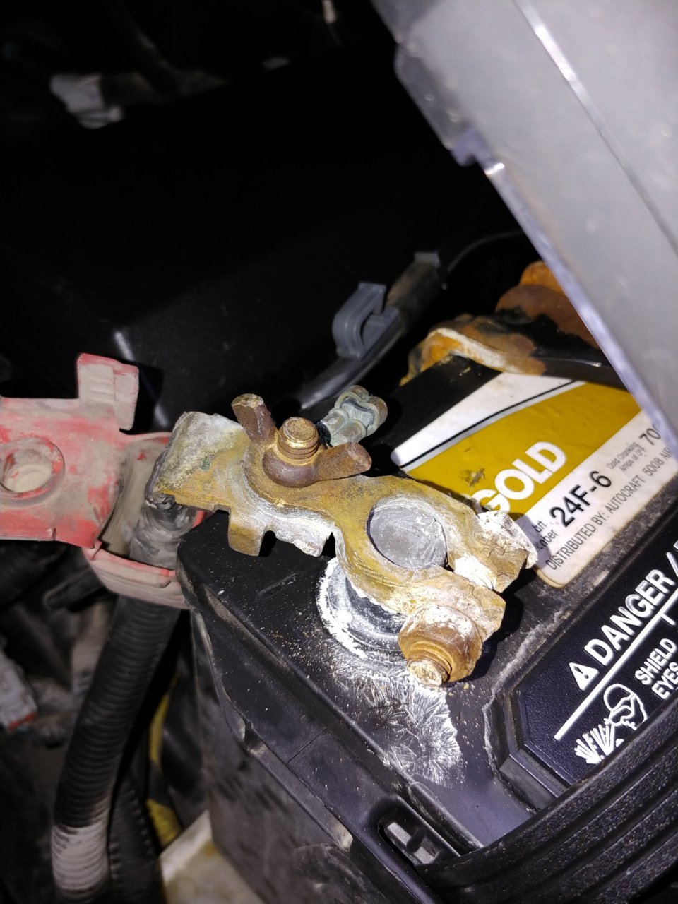

    Well first off, it started in the AM and we did make it home alright. Thank you for the response!
    I was looking at the battery because the positive connection was already jacked up when I bought it, however it has been working so far. It still cranks strong so I didn't really suspect that connection.
    This is when I first bought it, I cleaned off that corrosion. It looks like somebody tightened the connection down and then hammered it on to the battery terminal! :facepalm:
    The lack of cranking in this case was due to the Gulf States Alarm System being stupid. I addressed that here;
    https://www.tacomaworld.com/threads...-removal-that-little-red-devil-button.675634/
    I checked electrical connections and wires for loose or chewed wires, thankfully nothing was amiss there.
    I think I'm going to look into the big three wiring upgrade, that'll eliminate the battery and wiring as a weak point.

    So I bought a new positive terminal connector and battery today. I went to start it yesterday and it did the same thing, just one click. Multimeter indicated 8.2 volts.
    I took it in to have it charged and tested, it was toast.
    I went up a size to a 27F, Duralast Gold. I got a good deal through my Ford dealership buddy.
