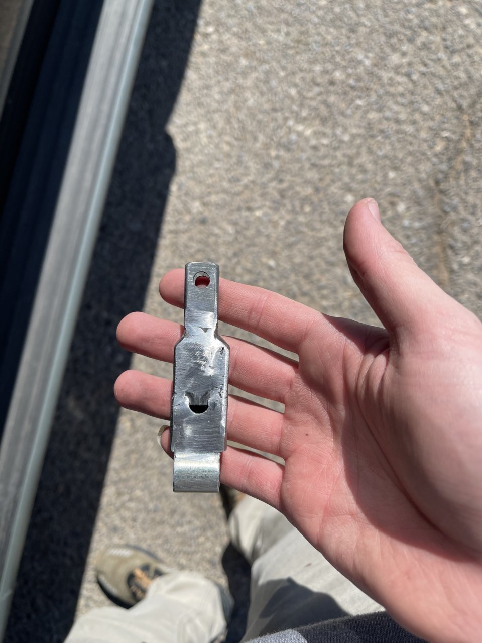

    Welded up the clevis bracket, it wasn’t perfect but who’s going to see it. Aside from the public pictures I’m posting here.
    C1D81636-E95F-40B9-82EF-23DB2D666E77.jpg EF407464-0CC8-40F6-BB29-E27C19FAD874.jpg BDDCE92D-4616-4B66-B855-EF4109E17730.jpg
    I tried to get a picture of the fluid inside the old booster but it was a weird angle. It was just about a pint and a half in there!
    I ended up having to extend the clevis more, it was just a bit too short and wouldn’t engage the brake light switch fully. So my lights were staying on. I cleaned it up a bit better this time around.

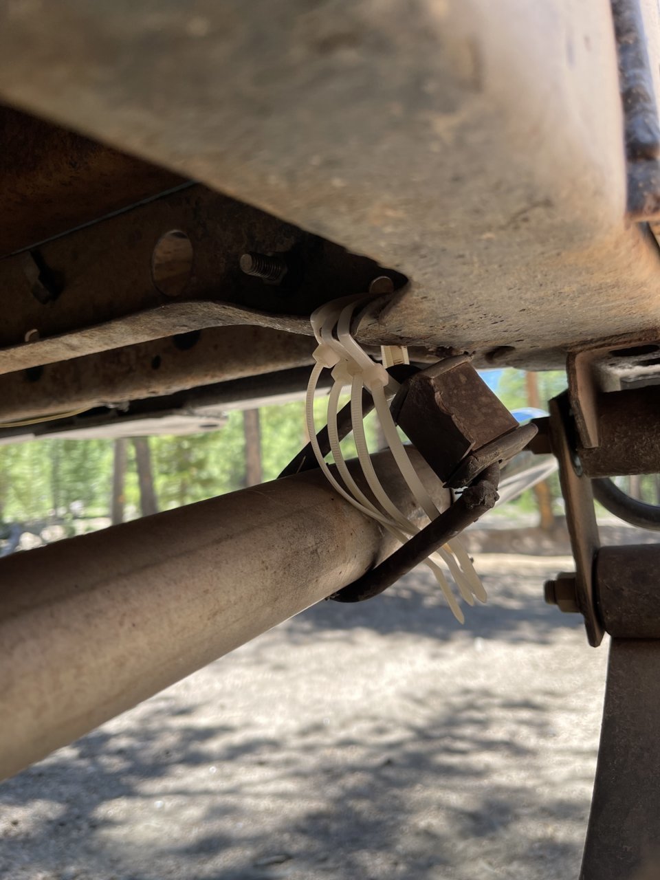

    Last day in Denver my Uncle took me up to the mountains in his bought-new-by-him in 1982 Toyota Pickup. Extensively modified.
    This last one is my truck then his friend’s Tahoe or suburban thing and then his Toyota.
    Quick trail repair :rofl:

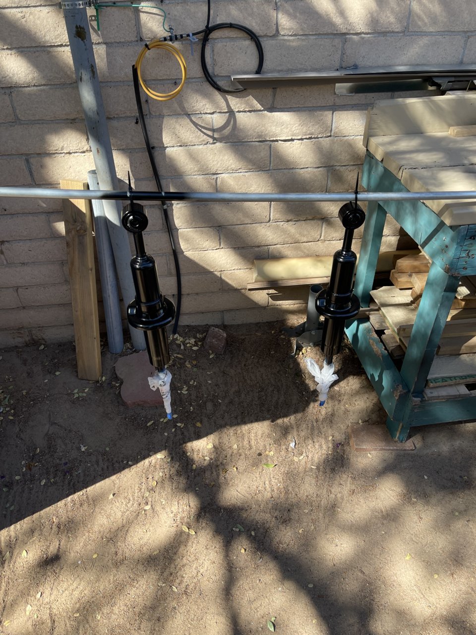

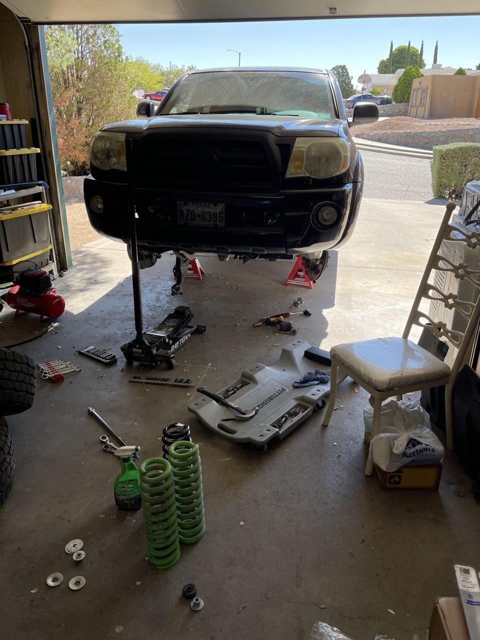

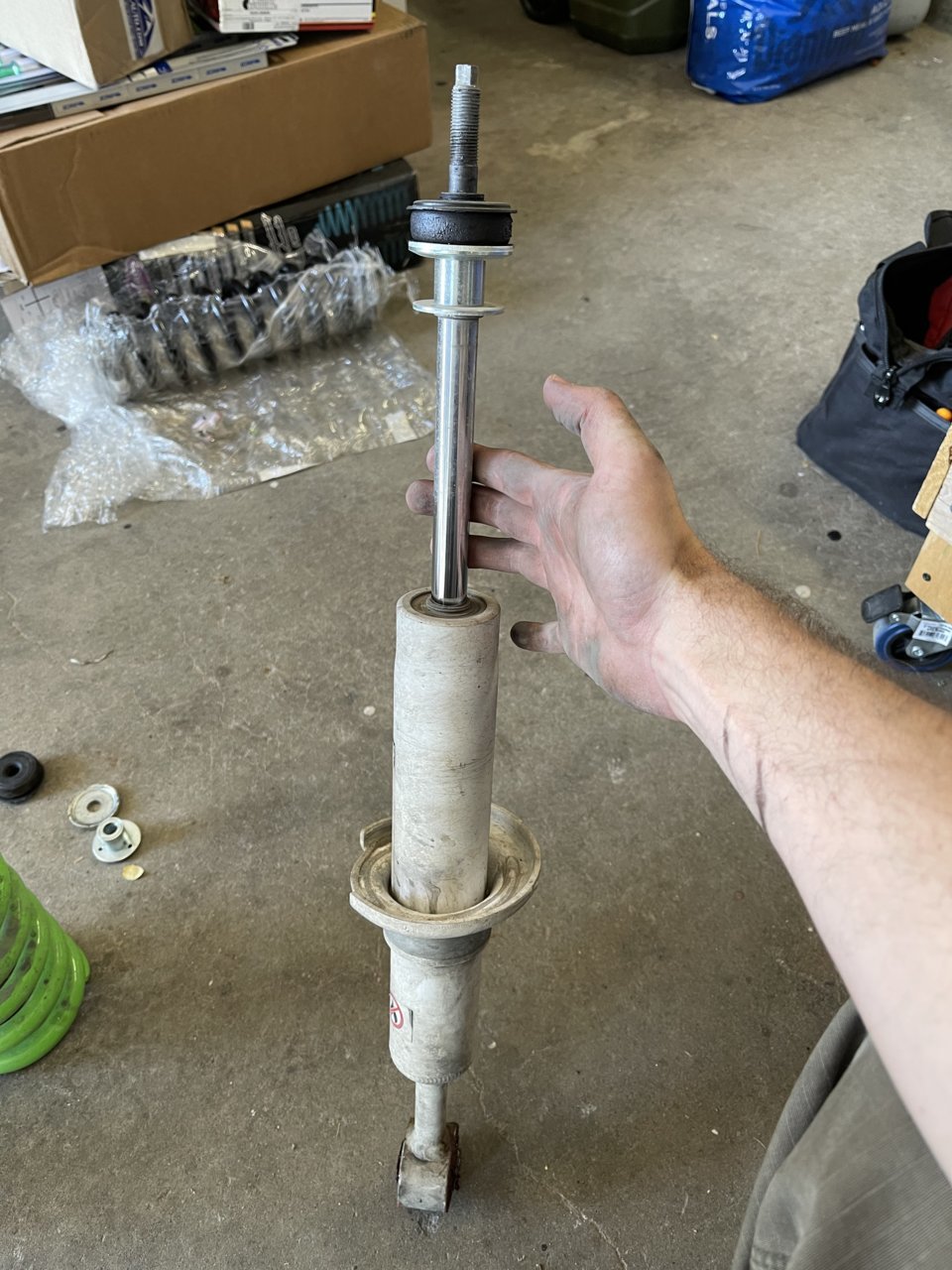

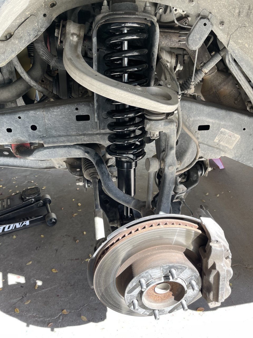

    Remember way back when I said “I’d love to install some zerks one day.”
    Well I did that today when I swapped my front coil springs out.

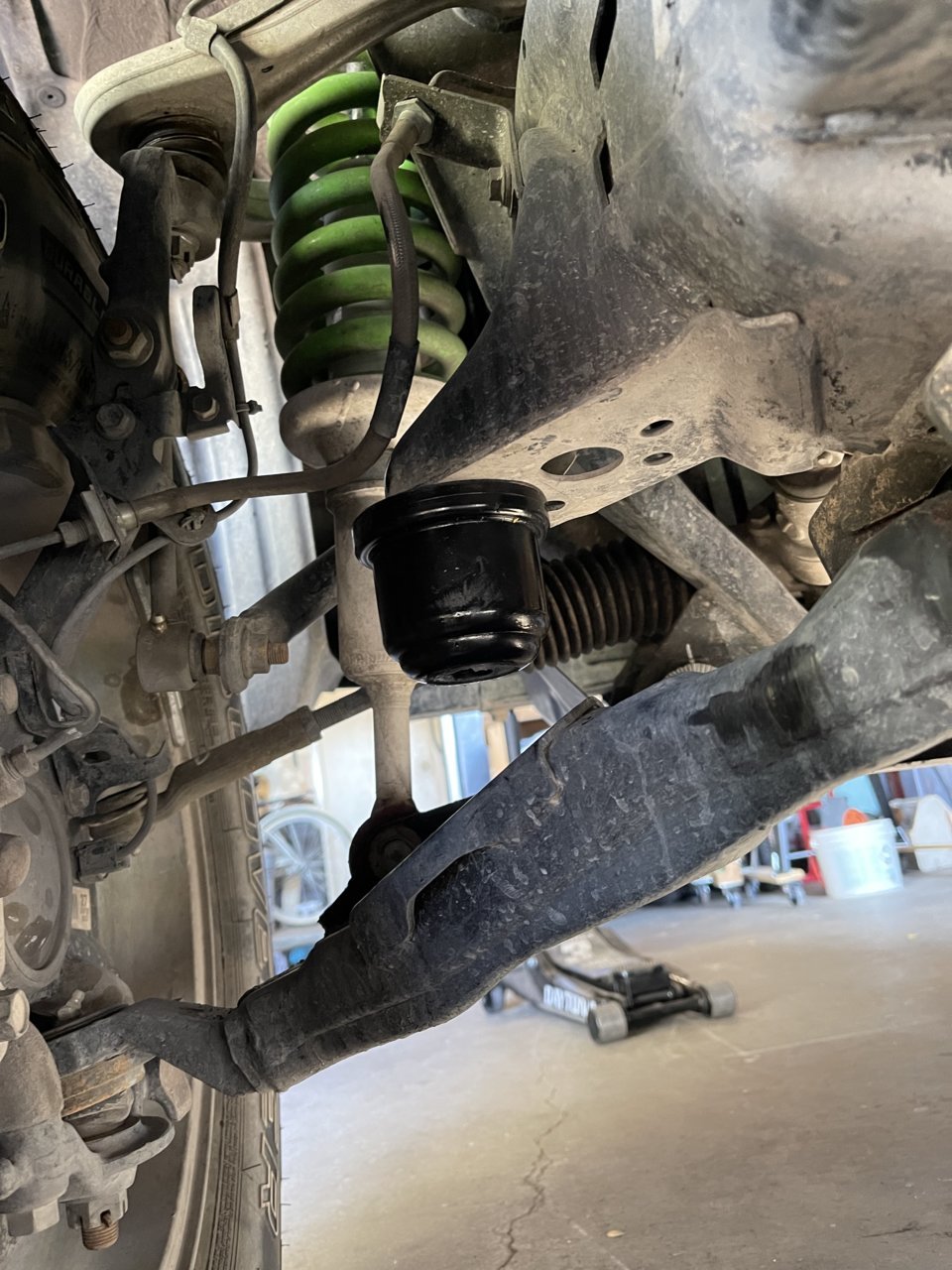

    Since the Ironman kit “meant for 4x4 vehicles” jacked my truck up almost 5.5” and gave me essentially no real useable suspension travel either direction I started looking for a way to fix that issue without buying an entirely new setup.
    So after a lot of thought and probably tons of unnecessary calculations I decided to pick up these coils and try them out. They should set me right about stock height, which I prefer.
    I’ll have to keep updating as I put more miles on them!
    Zerk fittings!
    Coilovers out, shocks aren’t too dirty. Still ugly white though.
    New coil springs next to the outgoing model, those are Dobinsons C59-238 coils. (14.75” free height and 586lbs/inch rate)
    No better opportunity than now to remedy the colour choice!
    Much better!
    Installed some Superbumps while I was under there, just in case I need them.
    Rezkid likes this.

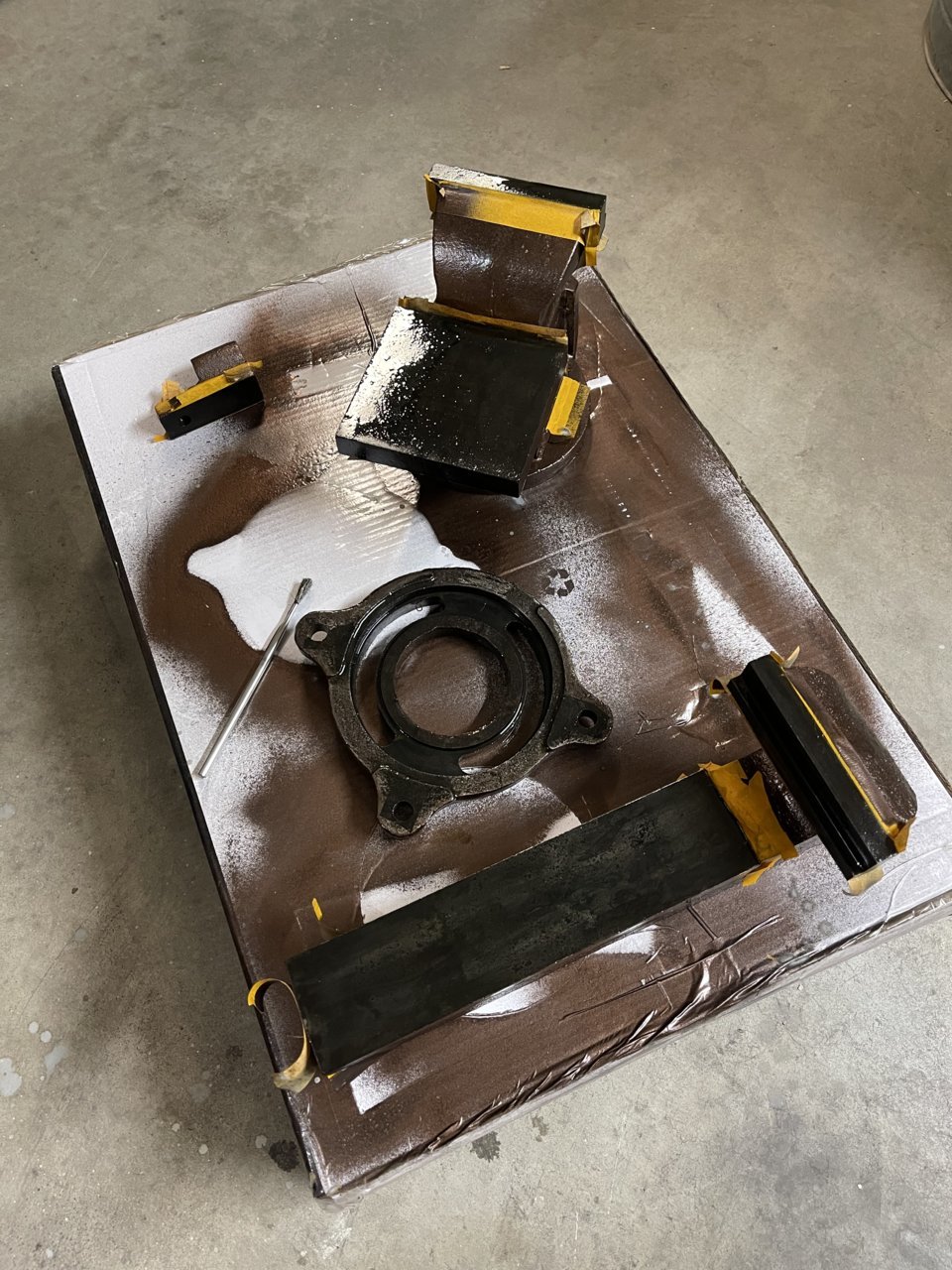

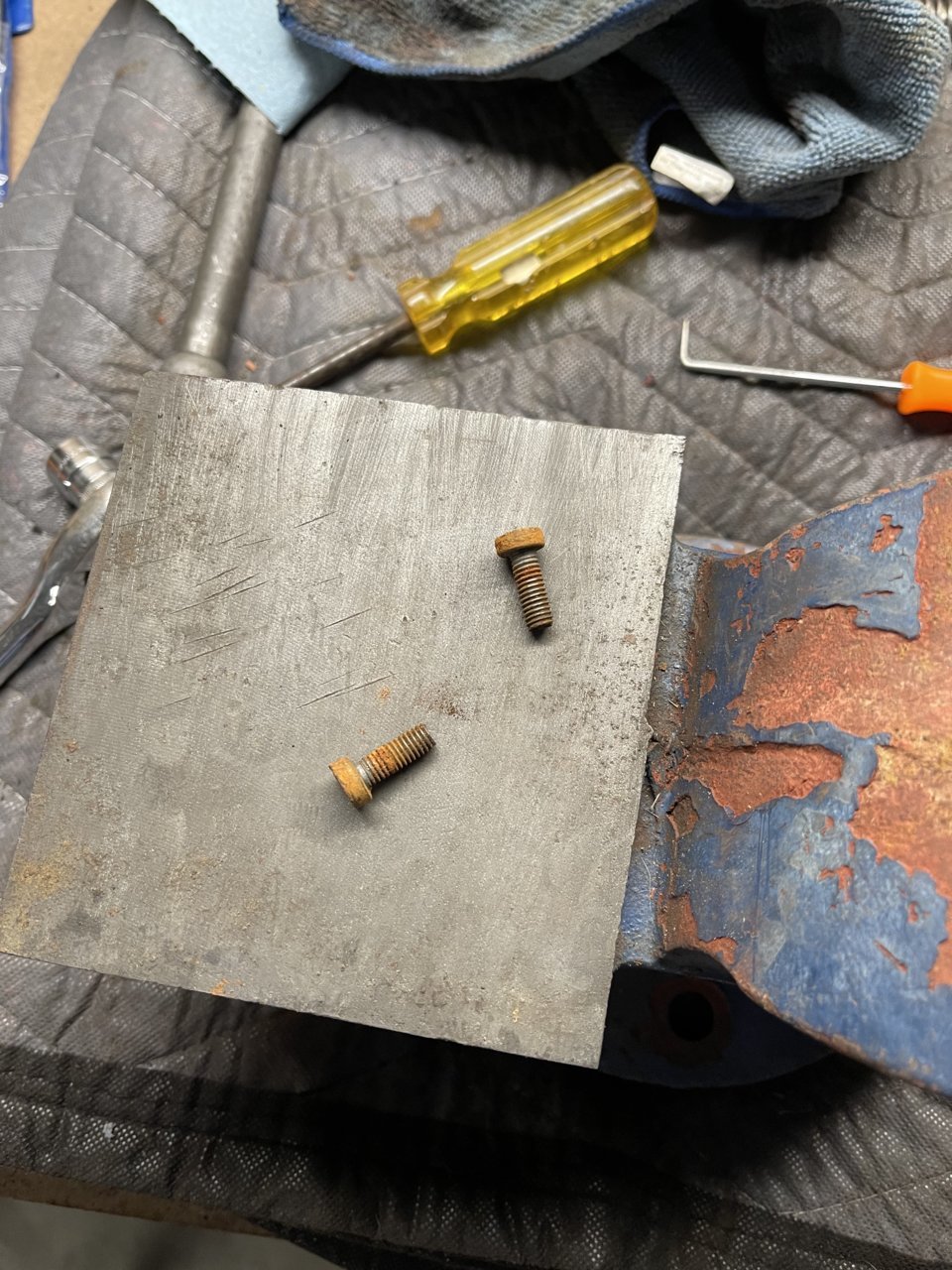

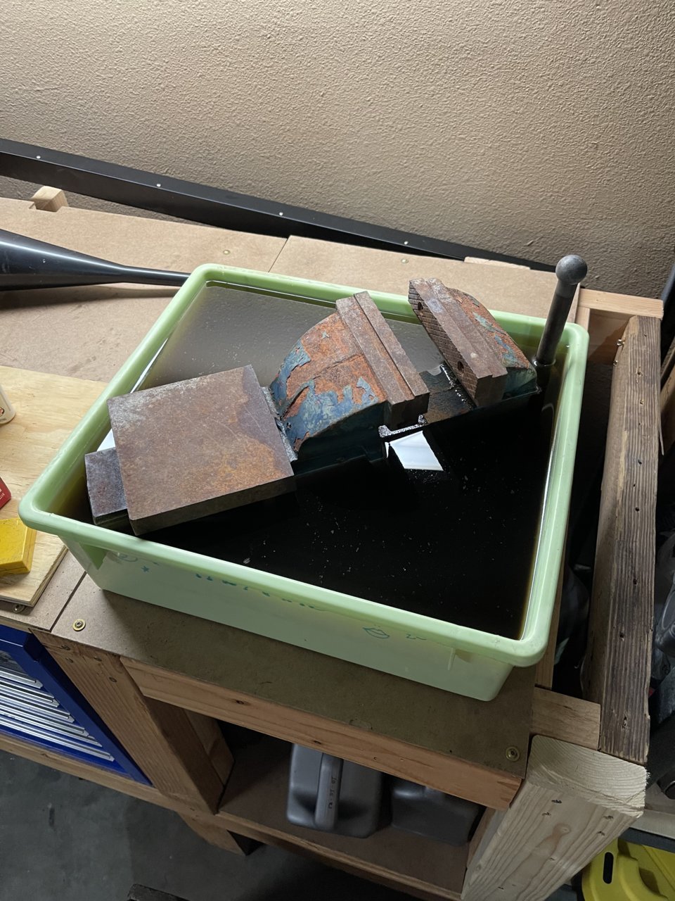

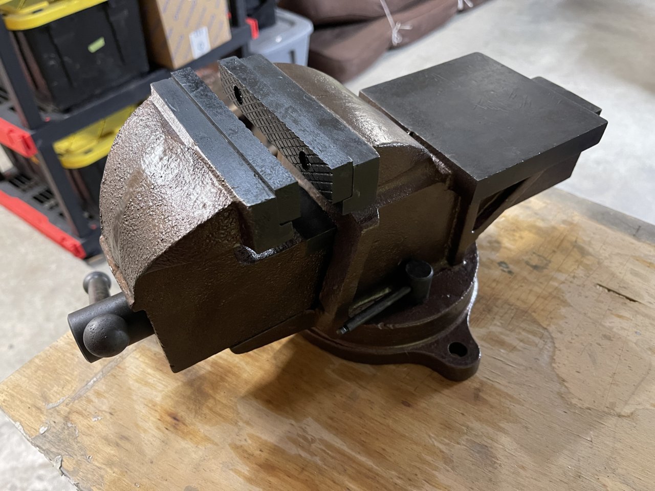

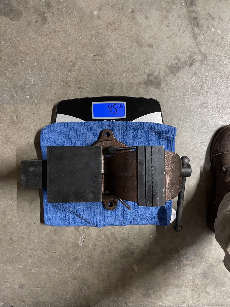

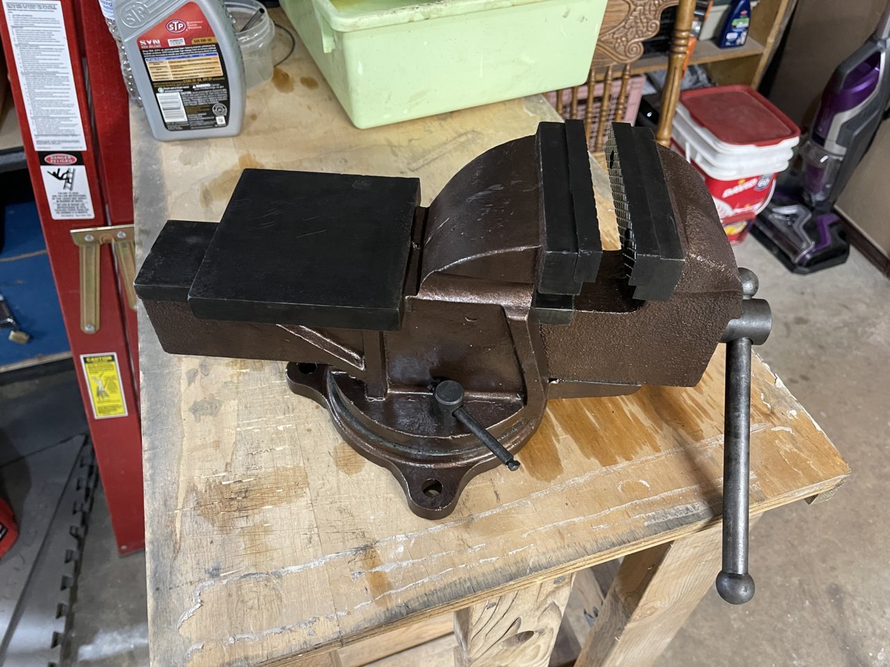

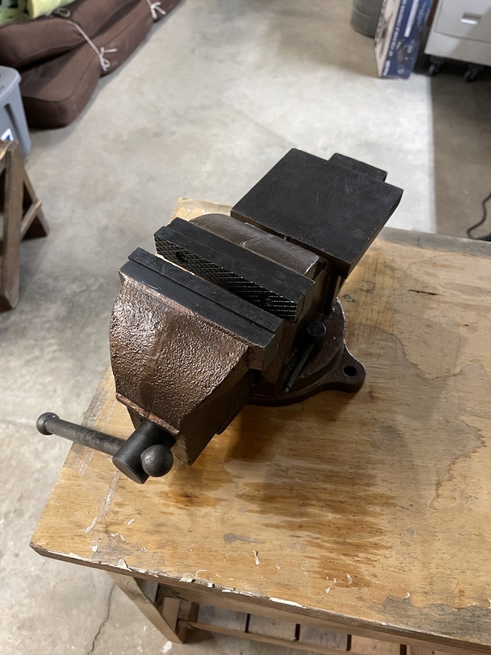

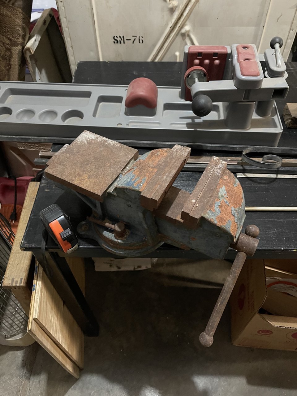

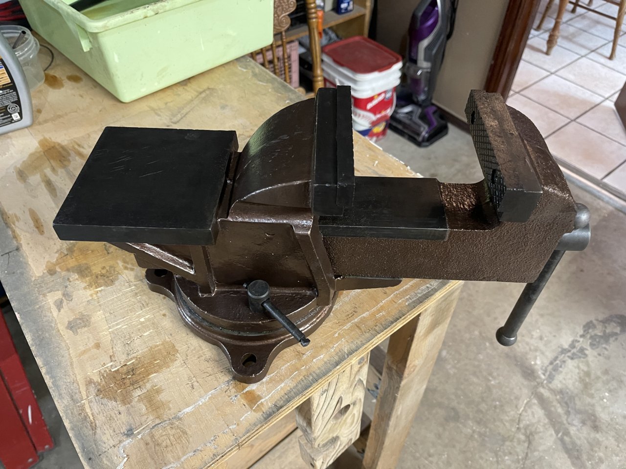

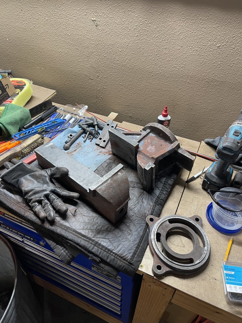

    Got a rusty bench vise for free a while back, I just finished fixing it up. I just did some cold bluing on the exposed metal bits and used some brown paint I had kicking around. I like how it turned out. It’s 45lbs.
    Here’s the journey!
    CFA29EDA-03B9-426D-B2B5-901AE571C6F5.jpg 202AFF1F-03A0-4DE1-BEC6-77846EE26793.jpg 7948518B-CCE9-4C67-AEB6-AD04C4194529.jpg 840284E8-8DB0-471F-B679-198ADB7A95AA.jpg 56FEA19E-E97E-4FB4-A81F-4F4F309C5273.jpg 7B5C9C64-E7CD-4EB0-A885-7AA9576582E3.jpg EEDB4C9B-0B03-455D-BE95-F4FCE719A1AB.jpg B141FC0A-24C9-4F5E-8E5E-0D1C21B1036D.jpg D65F7C94-12E2-4388-8D76-3D02A5CE1605.jpg 5822E736-04B6-45F9-9854-B8391EABE811.jpg 3C70C0C7-B853-44DD-A95C-306EE1542828.jpg CA552816-1B86-4D9A-A081-6197A830BA39.jpg 6AFFEF82-7617-42E3-8545-D18E665BD411.jpg
