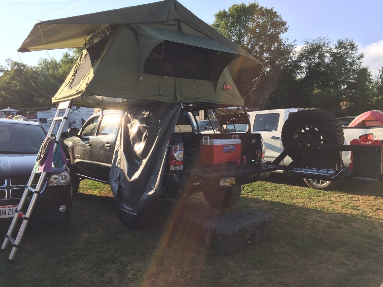

    Managed to find a way to get out this beautiful Labor Day weekend! 4e5d18ae910cabab744398dec2fb747d_286f43420a54c40aeef24e51082e1b9cb13f0a47.jpg
