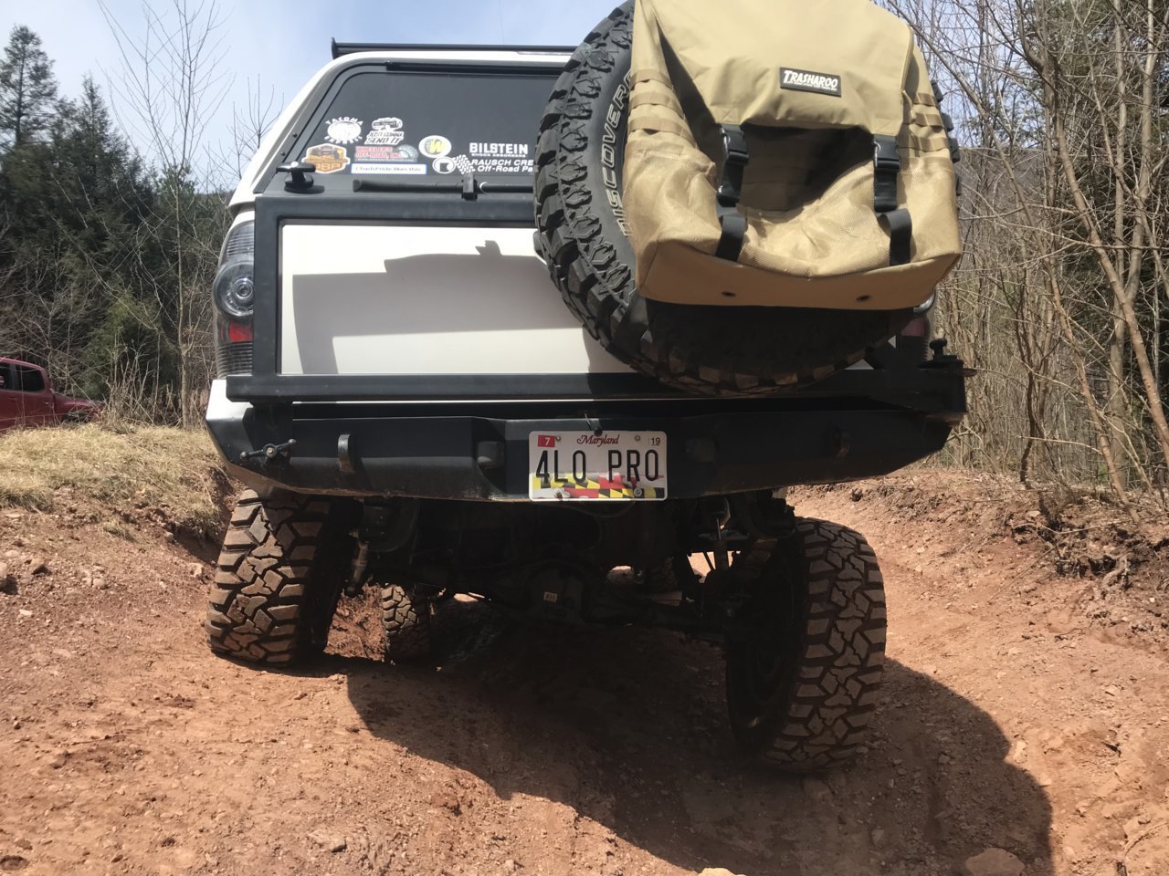

    Bilstein B110 are an excellent way to add droop to the rear. It's the longest shock you can fix in stock location and only need minimal bump stop modification. And you'll need extended brake lines. Only $200 for a pair.
    This is dakars and the B110. Everything is stock location (i.e. no shock relocate, stock shackles, etc)

    That's quite flexy!

    The B110 are only 3" longer than the regular 5100s, but it really makes a huge difference. I keep all 4 tires on the ground a lot more now.
