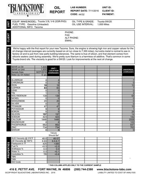

    Who here is going through the process of having their oil analyzed?
    If there are enough of us it would be a great resource of data to compile various members and their results. See what exactly these new engines are doing as they wear in. It's also good to see if the 10,000 mile changes are stretching the oil too far.
    If you're looking to do this yourself, www.blackstone-labs.com was recommended to me by "bob is the oil guy." They seem reasonable and give a pretty good narrative breakdown of what the results mean.
    See the attached picture of my recent results of the break in change.

    Your results make me think it might be a good idea to change the oil at 1K, then 3 or 4k, then go to the 10K changes. That way you catch a lot of the break in debris before it causes additional wear.

    I was thinking the same thing. This was just an oil drop, I left the filter. The results were surprising to me. I expected more iron and copper, the copper being a chief component of bearings. I'll do it again at 5k with a filter.

    Just out of curiosity why, other than just an abundance of caution? All properties were within spec, and the analyst's comments basically say everything's "normal" and they are "Happy with the first report for your new tacoma"

    Click here and fill it out accordingly. 28 bucks for the basic test, $10 more to test TBN, (total base number) which is the number of additives.
    I didn't do TBN because the change was at 1600 miles. I know I had plenty of additives left. One thing to consider with synthetics is the base structure never degrades provided you don't chemically or thermally damage it. The oil change interval depends on how saturated it becomes with contamination and how much of the additives are left. I plan on TBN when I start pushing the intervals out.

    I suspect it will be fine too. Only exception may be those who live in areas of high fine dust and those who off-road often. Maybe people who tow or push the engine fairly hard regularly. But it would be nice to have data to give people solid advice on.

    I'd think that the copper is usually in the core of the bearings with babbit protecting the copper from contact with the crank, cam or other rotating equipment. I'd think if you saw higher levels of copper, that'd be bad. There maybe some copper in the babbit, but not much.... might be the oil is doing a good job.

    Right, that aligns with what I said earlier. The point of my post was that in the journal bearings I have dealt with, the majority of the copper isn't in the babbit which is what is below the oil wedge that the crankshaft rides on. The majority is in the core of the bearing which should never see oil or crankshaft. If you get lots of copper, it's likely a bad thing..... need new bearings bad.
