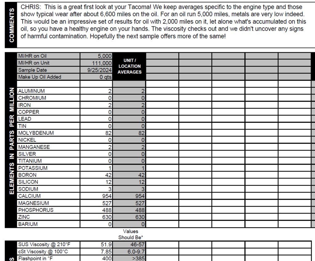

    I have used Mobil 1 0w20 Advanced Fuel Economy since mile 0, now at 124,000. I did an oil analysis about a year ago and the truck had a perfect bill of health. I ran the same flavor of Mobil 1 in my Honda Civic for 200,000 miles from 77K to 277k, no issues.
    I've been able to get pretty good fuel economy on long trips and long durations on the freeway, the gauge has read high 25s low 26s mpg. Certainly wind was also probably a factor.
    But you get the idea. There's so many oils and so many good ones, it's pretty hard to go wrong with any of the top MFG of oils. I just stick with what has always worked.
    You can't go wrong with Mobil 1.
