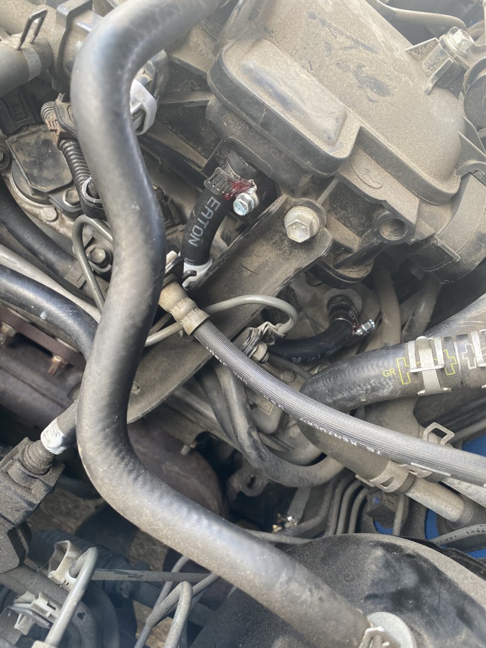

    I replaced mine, because I like spending money and replacing parts for no reason. Being a smartass. I also replaced the hose and got rid of the spring clamps replacing them with worm gear hose clamps.
    Shelf Life and Island Cruiser like this.

    whats the red goo?

    Grease. I’ve had them strip or stick several times. So I put a little on the band, open and close it, clean off the excess, then put it to use.
