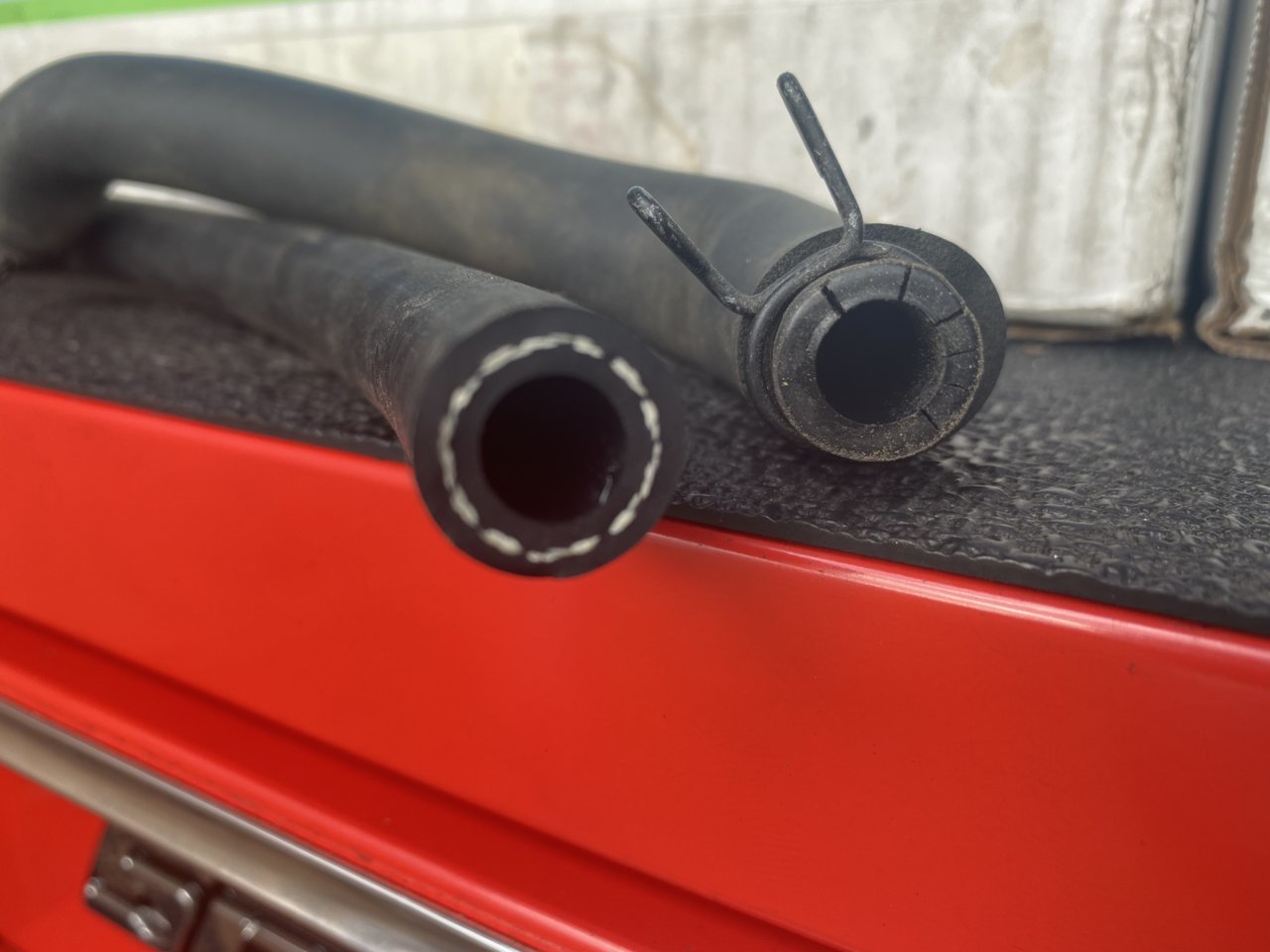

    I wanna say my local dealer only wanted about $3.50, it was insignificantly cheap is what I remember. About the same price for a can of brake cleaner. I think I spent more for the new hose & hose clamps.
    If you need to replace the hose like I did, the Toyota one is nicely formed and it’s a hose in a hose, so abrasion protected. I didn’t feel like dealing with the stupid parking lot at my dealership for a hose. So when I needed to stop at a parts store, I picked up 2’ of 3/8” hose and a pair of hose clamps. 1’ might have been enough, I didn’t measure but I’d rather have too much than not enough. I wrapped it with a zip tie where it wants to rub.
