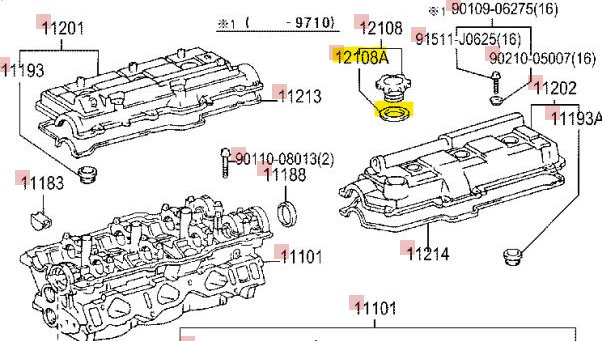

    3.4L Diagram
    Gasket part number: 9043037140 GASKET(FOR OIL FILLER CAP)
    Cap part number: 1218022011 CAP SUB-ASSEMBLY, OIL FILLER
    They are in the Engine - Cylinder Head section on parts.toyota.com.
    Edit:
    I don't see one on the PS cap (but that doesn't mean it's not part of the cap itself):
    Cap part number: 4430550020 CAP SUB-ASSEMBLY, RESERV
    Reservoir part number: 4430635240 RESERVOIR ASSEMBLY; RESERVOIR SUB-ASSEMBLY
    Found in the Brakes & Suspension - Vane Pump & Reservoir (Power Steering) section

    They both should have a seal. Only the Oil Cap has a separate one.
