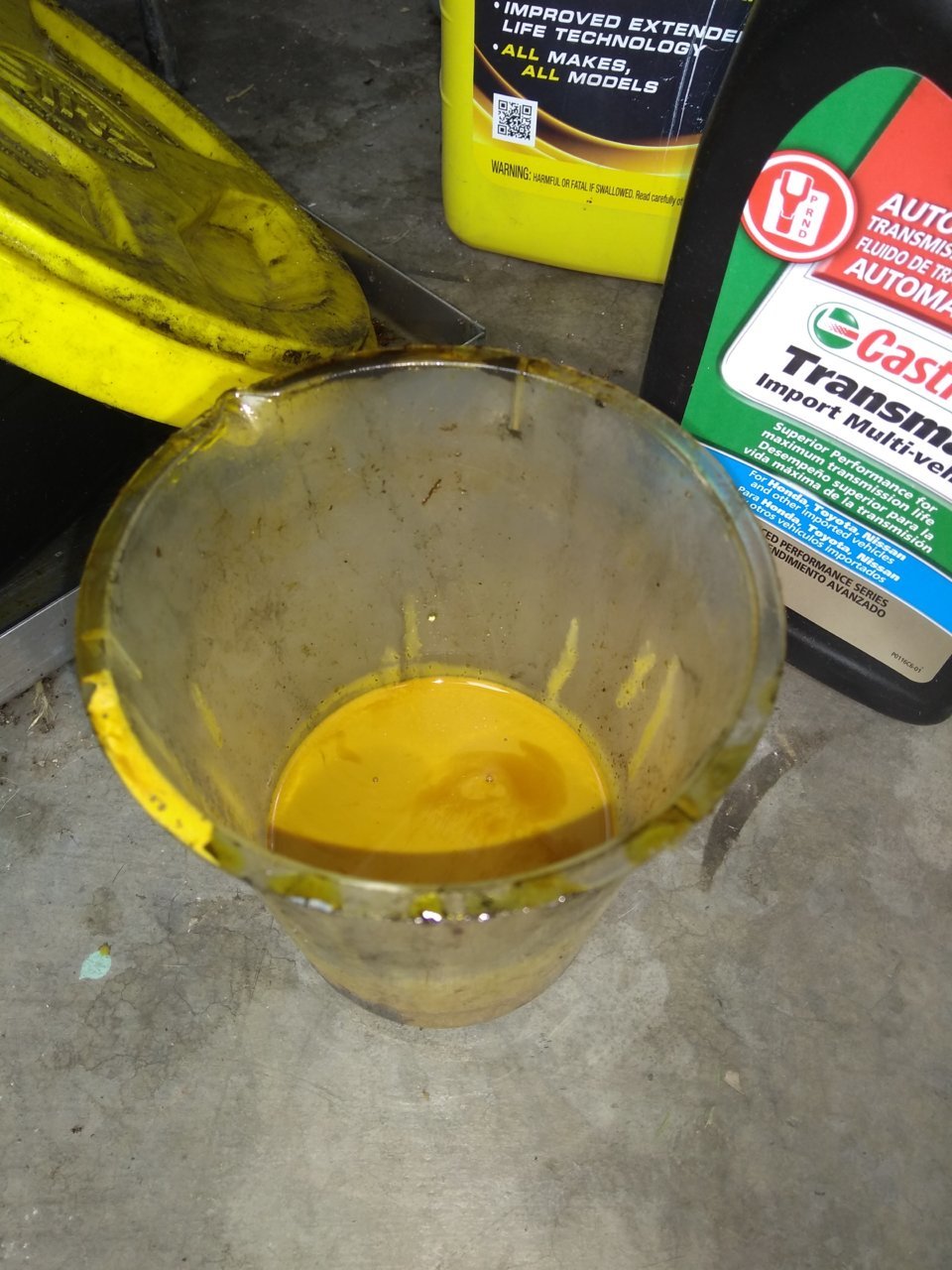

    IMG_20181223_145022780.jpg I believe Oil Catch Can collect this stuff .
