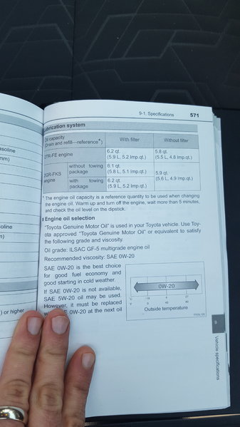

    Changing the oil at 5000 in my 16 OR. It's the 3.5 V6. Anyone know exactly how many quarts it takes? Dealer gave me 7 quarts.

    6.2 qts. Page 571 owners manual.

    So is the manual accurate?

    Oil so damn clear it hard to tell I put it 6 quarts a it looks ok. Will check again after it dirtiest up a little.
