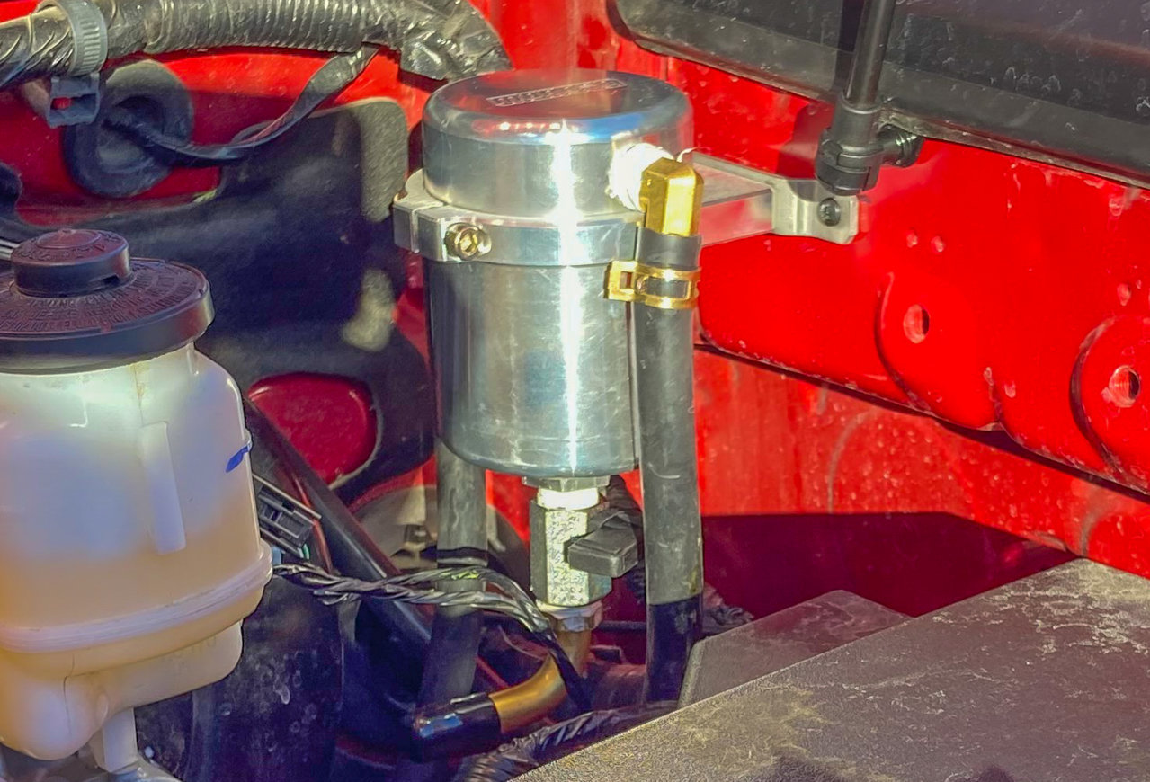

    There's even better.

    I get 2 oz of oil in a 6k mile change. But in the winter I get 5oz of water in 6k miles.

    What brand is that?

    SH7mi[QUOTED][OP] likes this.
