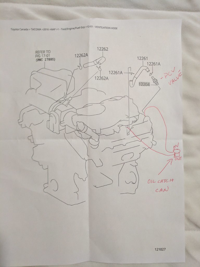

    Not trolling. I'd venture to say that the oil on the outside of the throttle body is coming from breather hose (12262 in the diagram). All of the catch cans I've seen have only been on 12261 or the PCV valve side of things.
    I can't see oil going into the intake on the PCV side and then being blown back out past the throttle body to only be sucked back onto the outside of the throttle body. That's the only point I was making. If you want to run a can that's fine but there will still be oil intrusion from the breather or whatever Toyota calls it.
