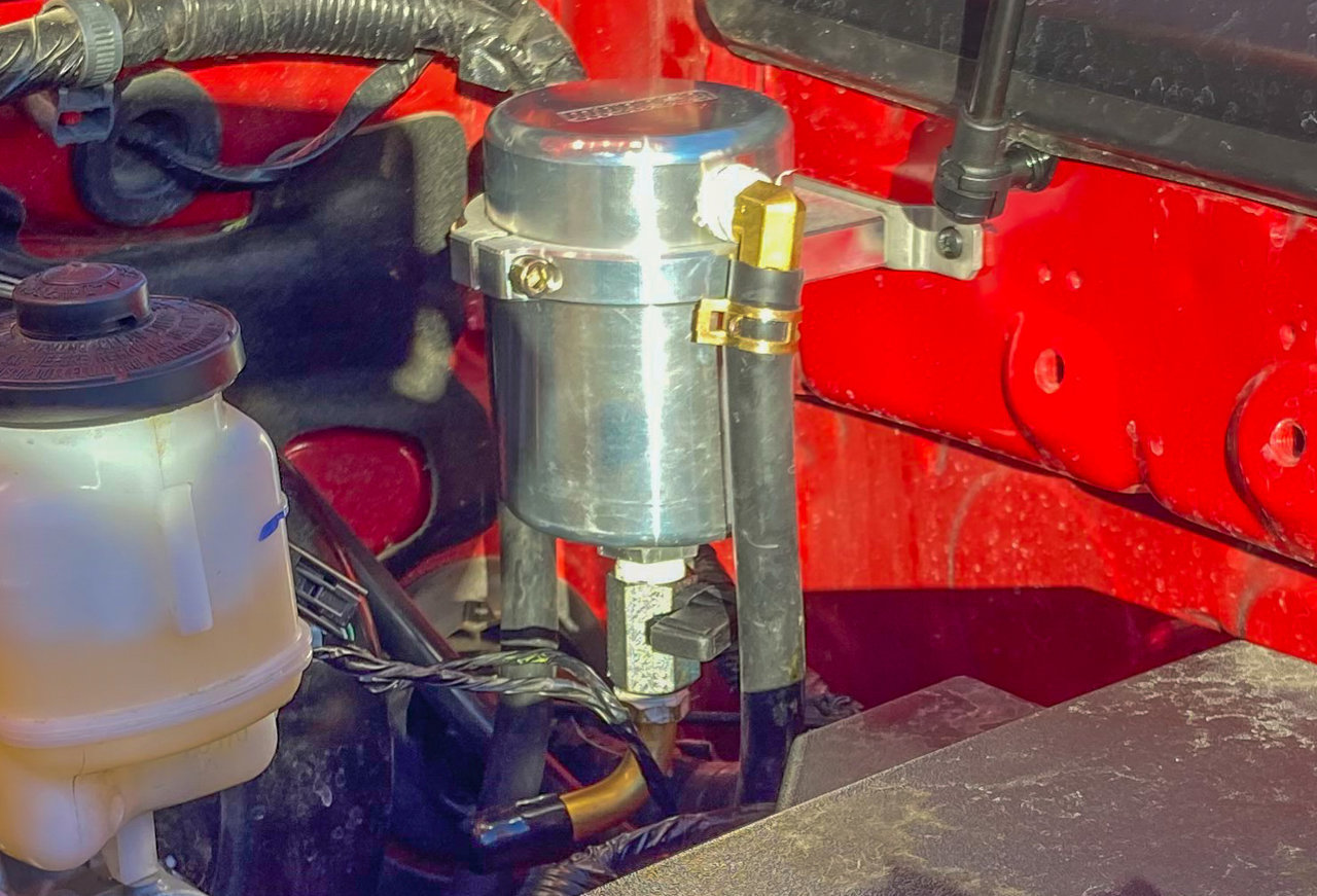

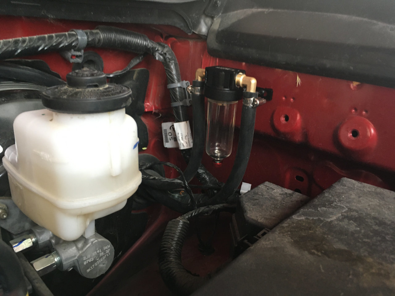

    Hold up I have not heard of a catch can freezing and causing a valve cover leak. Has anyone else heard of this? I live in MN and we get weeks of sub zero temps and I wouldn't want to risk it blowing up my engine but I do want to get rid of the oil in the intake.

    I like the $150. one over the smelly $30. one.

    Wow, would that serve another purpose too? Route hose under truck for mock catch can AND coat frame with oil to prevent frame rust? :thumbsup:

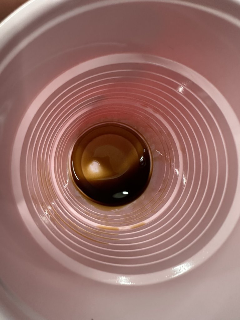

    Who wants this going into their intake? That's proof it's not nothing but it's also not a huge amount over time.

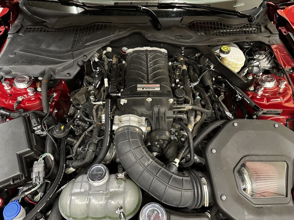

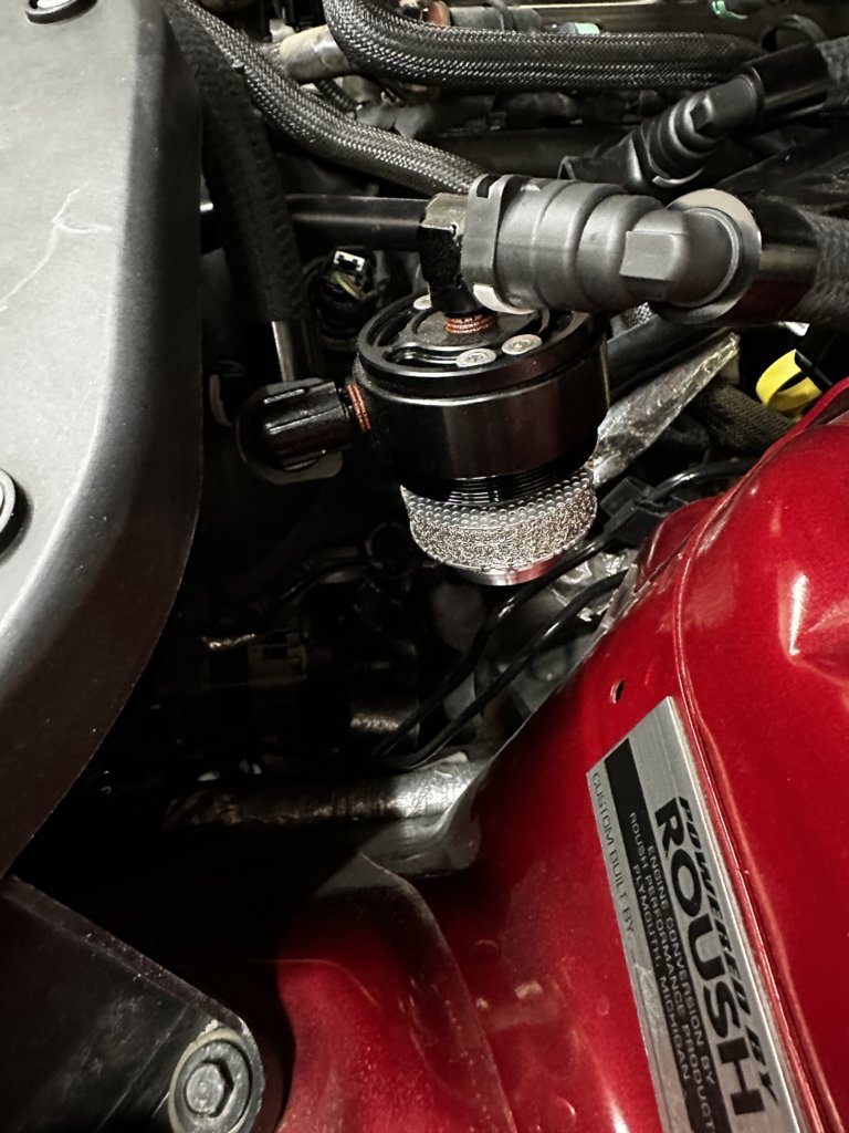

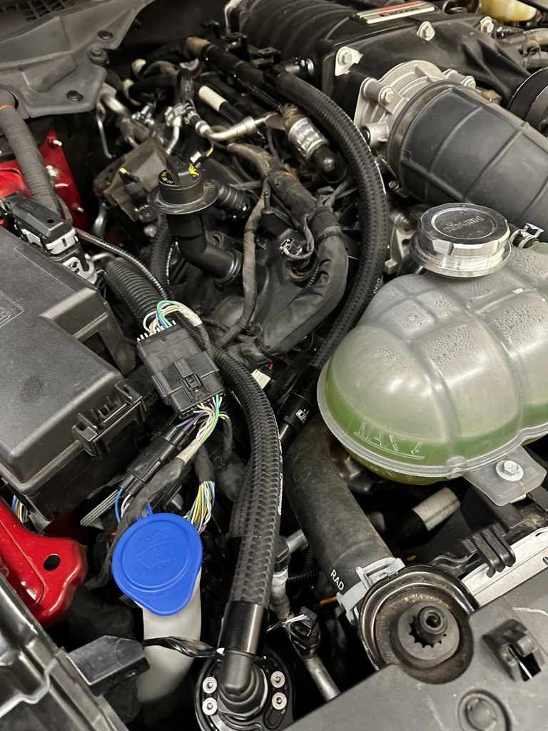

    DI/Boosted a catch can is a great idea. We are pretty dry in CO, so there won't be a lot of moisture in the catch can.
    I have two on my Mustang. Dirty/Clean side. Not all "catch cans" are created equal either.IMG_7339.jpg IMG_7341.jpg
    200 miles there is about a tablespoon of 5W-50.
    The clean side doesn't get bad unless the car is pushed hard.
    With all the other hoses and BS....can't even tell I have two.
