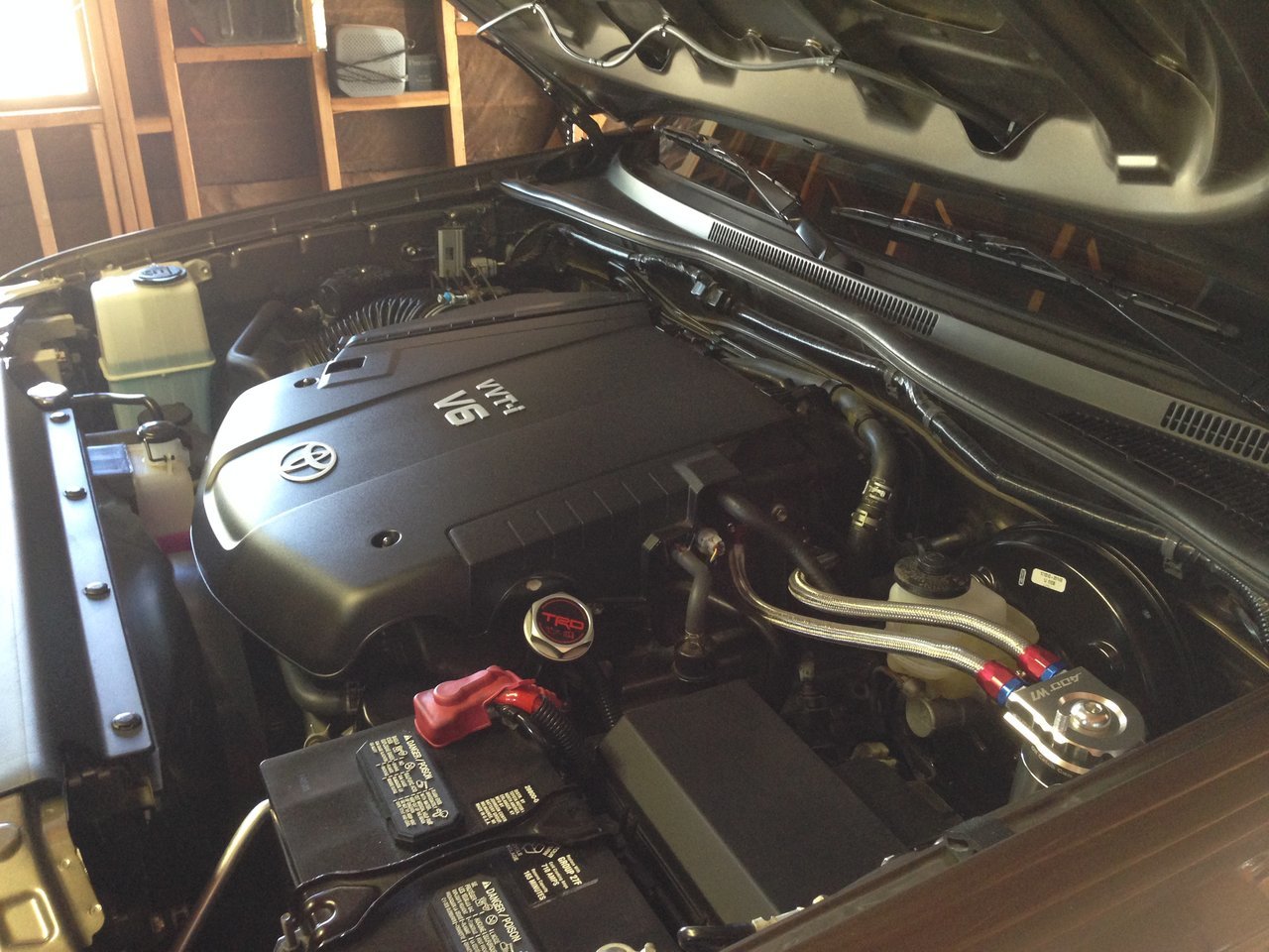

    I have been running one now for over 29K miles. I can say every time I empty it, I am glad that goop is not going in my engine, and yes, get a good one or you till throw a code. Never been a problem with my set up.
