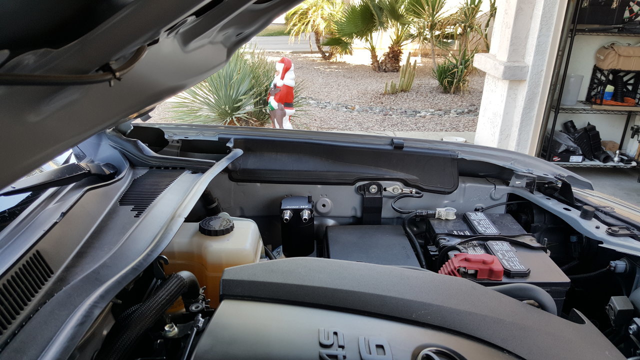

    Great to see, so much cleaner! Nice install.

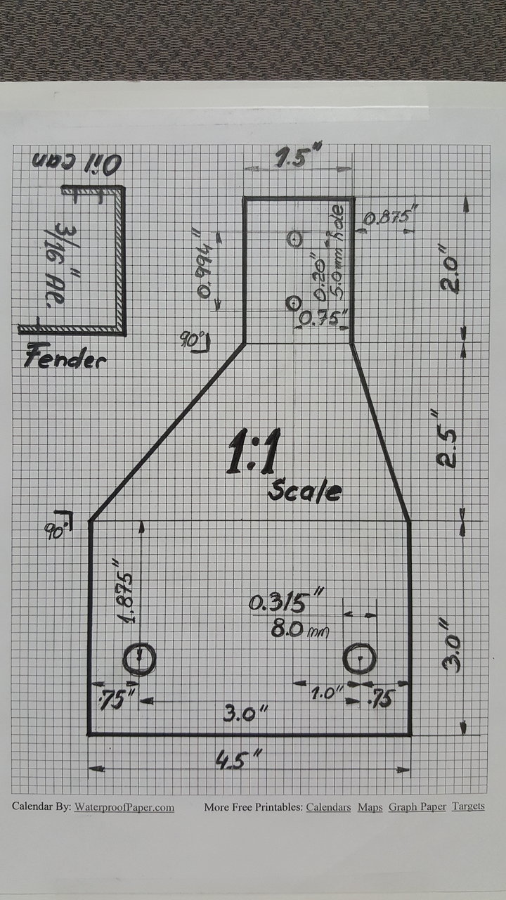

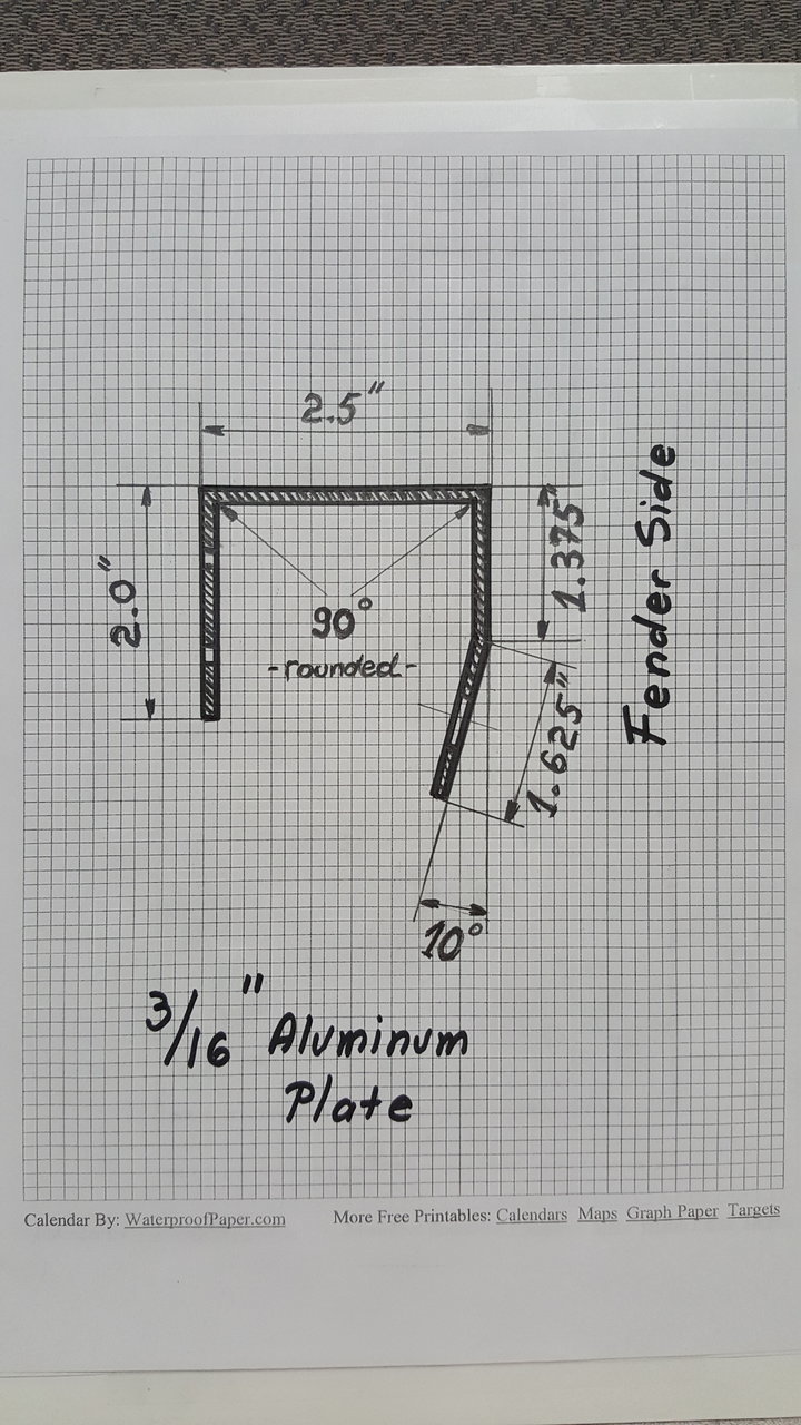

    Can already bought. Waiting for a custom bracket to be made since OCD is demanding perfection. Oil particles get crazy if the can is not supported by a PRO bracket.
