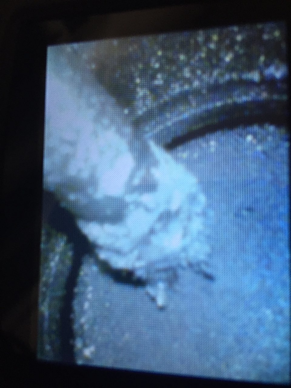

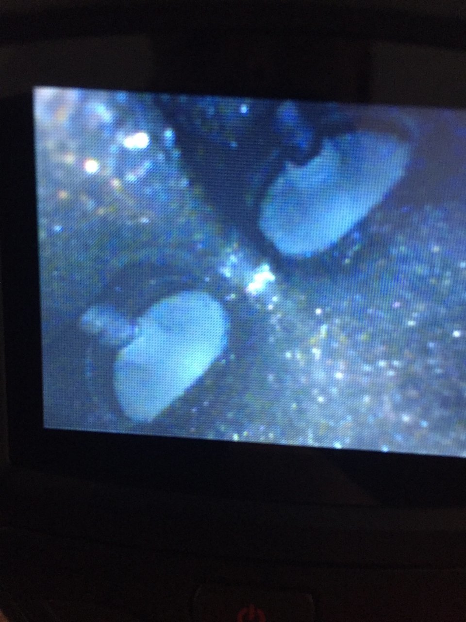

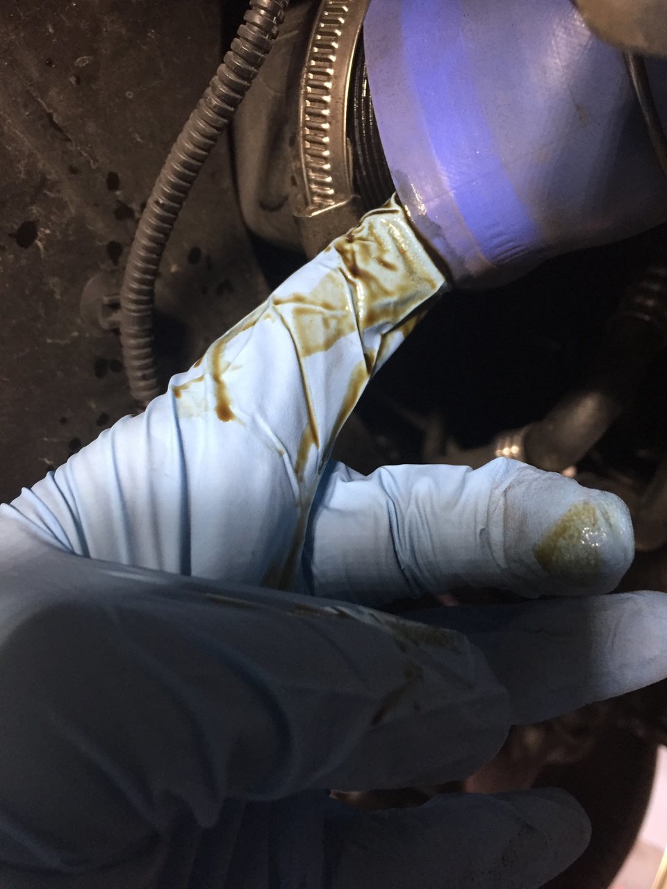

    504F3EC2-3696-4767-BEC7-6796796B4487.jpg 18C33194-4B8A-4A89-95D4-052C707FAED1.jpg 5D2AA194-6EAD-46D1-AF8C-88A99982ECAC.jpg I really liked my 2016 F150 Lariat 4x4 with 2.7 during the 13 months I owned it. Excellent engine power and torque, practical room and nice features were enjoyable. Frozen locks and doors that wouldn’t latch in freezing weather along with a stuck blow off valve? causing check engine light to illuminate were items that were fixed under warranty and will hopefully perform for the person who is driving it now.
    It had been brought in to the dealer twice, each time for several days as extra parts were ordered.
    It also started stumbling a little at stoplights while idling at around 11,000 miles.
    I purchased a borescope, removed the intake pipe at the top of the engine, held open the flap and fished around to various cylinders. The carbon buildup on the back of the valves and stems at around 12,000 miles was interesting to see.
    I decided to sell it at 13,000 miles when I just happened to be looking around the engine compartment and decided to check the air filter. When removed, the back side (or clean side) was fouled with oil (Mobil 1 since under 1,000 miles) which was surprising. I guess that either it was still not functioning properly or the oil was just from PCV mist circulating in the system. I had read that when lifting off the throttle, the intake flap closes and there is still air under pressure in the system, so it possibly backed up to the outside air intake. The mechanics reading this could probably inform us about it.
    I removed the lower intercooler inlet pipe and found there to be a bit of oil inside. How much is too much, I do not know. I’ve read that, E218E74A-8737-4A26-8C75-FD334C11D0DC.jpg some say that some oil is ok, and other people say that some oil is not ok.
    I don’t know. I tried at length to research it, and of course read many differing opinions. I’m not a mechanic but I take care of my own maintenance.
    Posting pictures of oil running out of lower intercooler inlet, fouled air filter and carbon buildup.
    I had been thinking of purchasing a good catch can figuring it couldn’t hurt, but then traded it in on the Tacoma. I had also thought about purchasing a newer model F150 with the redesigned motor, but a Tacoma is what I had been looking at before purchasing the F150.
    I owned several Ford Trucks before over many years and I guess I had just been lucky in that I never had any problems and not even a single squeak, rattle or buzz in any of them.
    My Tacoma is solid at 2,000 miles and it’s dialed in to be quiet now. Like I keep saying, just check your fluids.

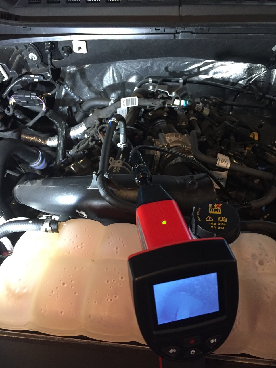

    Just a cheap borescope with color screen purchased with coupon from Harbor Freight. A neat tool to have if you want to check your valves or see into other hard to reach places on your Tacoma.
    Checking out the valves on the 2.7 turbo.39510090-5EDD-4D66-8C1A-F4948776A920.jpg
