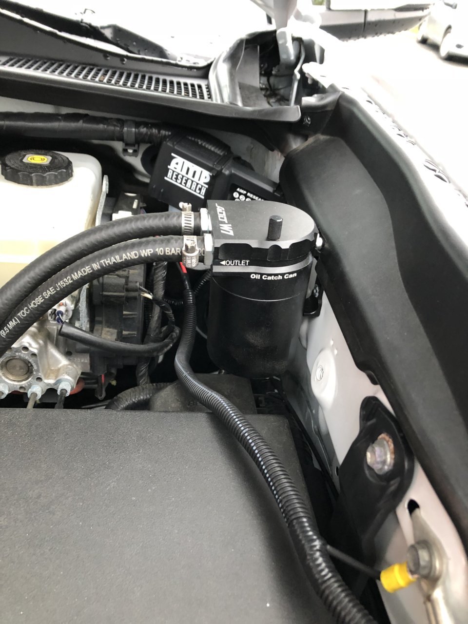

    Side pic.

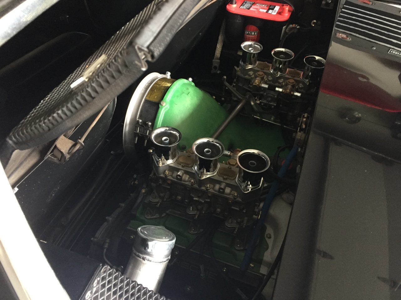

    I run one on my 914-6 Porsche engine, but I don't see the need on a modern 2019 automotive engine.IMG_5328.jpg

    As you have a 914-6, I have to officially hate you.
    Seriously, I am very jealous.

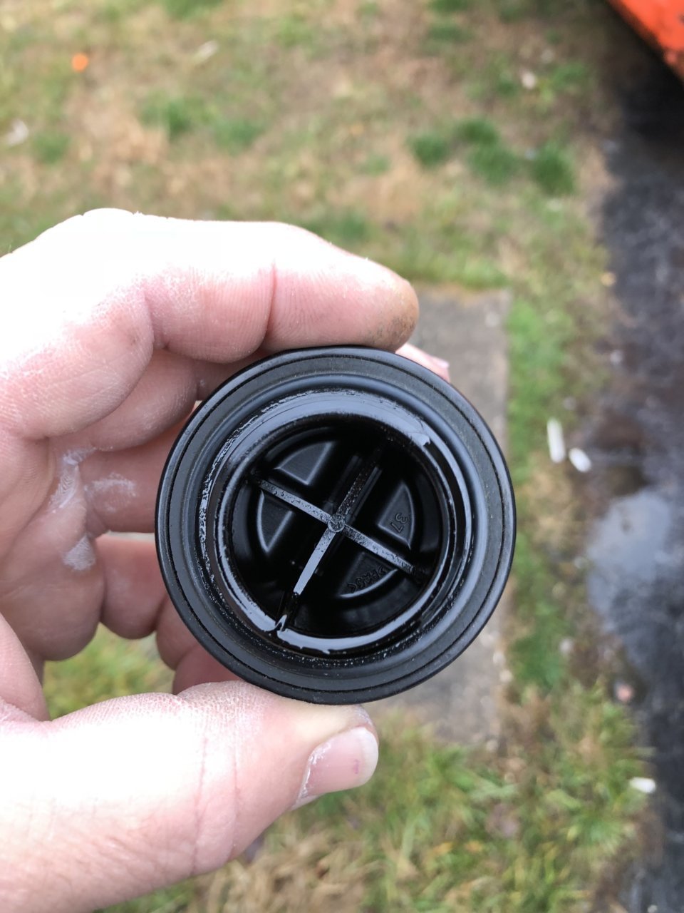

    Get the oil filter for Prius and put it in the can. Stops the catched oil from sloshing around.

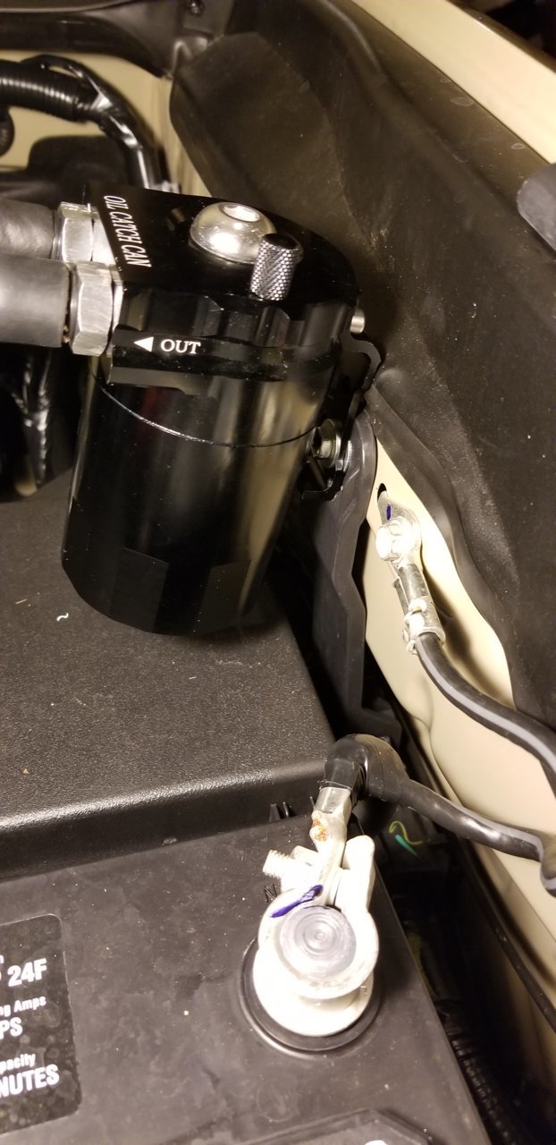

    EC48698D-53F7-4488-A81E-9C32C22624F6.jpg 2E09FEE4-7DBE-49E8-8684-EB977E83704B.jpg

    I use one too, it's a very inexpensive mod and it gives me piece of mind. In the cold weather in CT the liquid in the can looks like coffee.

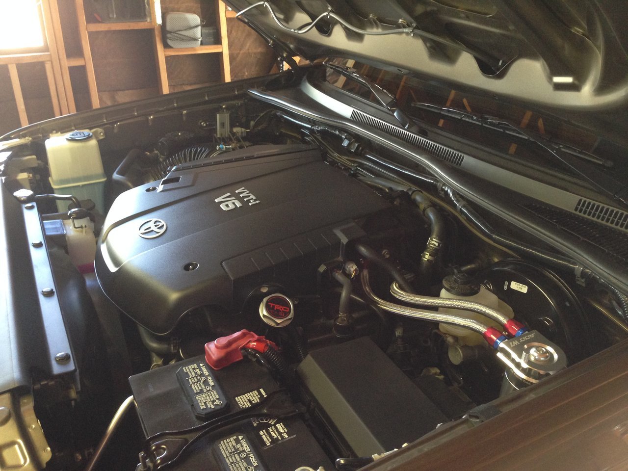

    Back to the topic.
    DO you NEED the oil catch can, probably not.
    If you don't do your own maintenance...move along.

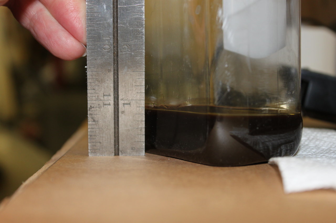

    I will add my experience.
    After 10 months (I average about 5k miles per year on this V6 T4R 1GR-FE).
    Bottom of a pint Gordons, where is that oil going? Into your intake to be burned and spit out into your kidos lungs? None the less it is added to the environment.

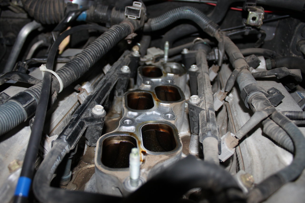

    Oil in to your intake will do this.
    Intake at about 70k miles.

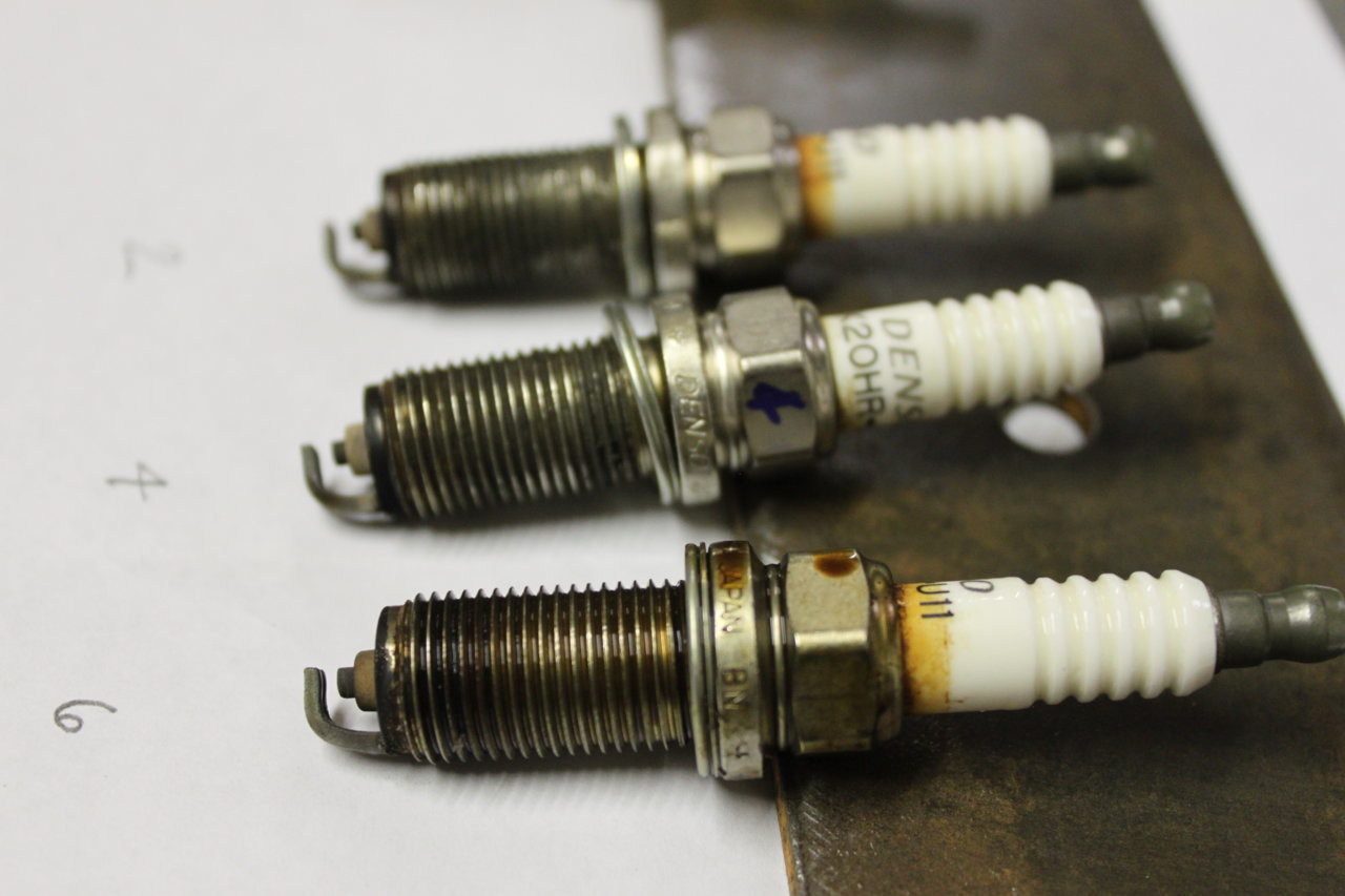

    Spark plugs after 30k.
