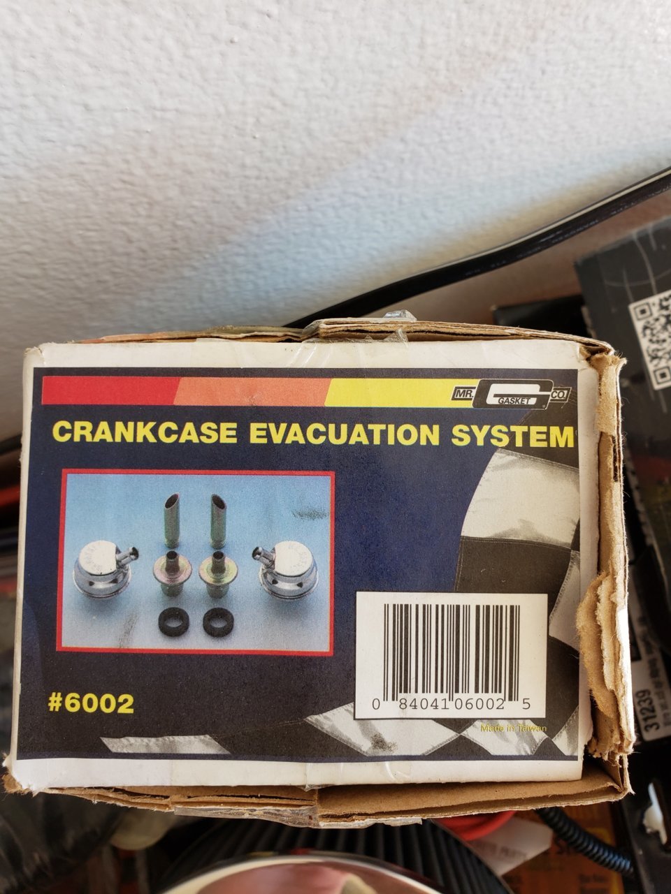

    Oil contamination was a problem on older cars and trucks where the PCV was the culprit . You would see oil oil / carbon build up in the valve pockets , heads of EA valve and top of the pistons . This would cause hot spots that could allow spark knock

    You need this as a replacement for a PCV

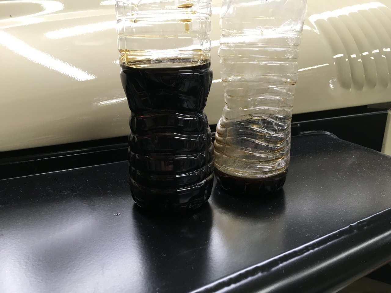

    I’m not convinced catch cans are absolutely necessary, but these are my results. The bottle with more oil is 16400 miles on my RAM with a 5.7 Hemi. The bottle with the small amount of oil is from my Tacoma with 6000miles. I usually empty the catch cans every 3000 miles. The majority of the miles on the RAM are highway miles with some towing. The Tacoma is mixed city/highway.
