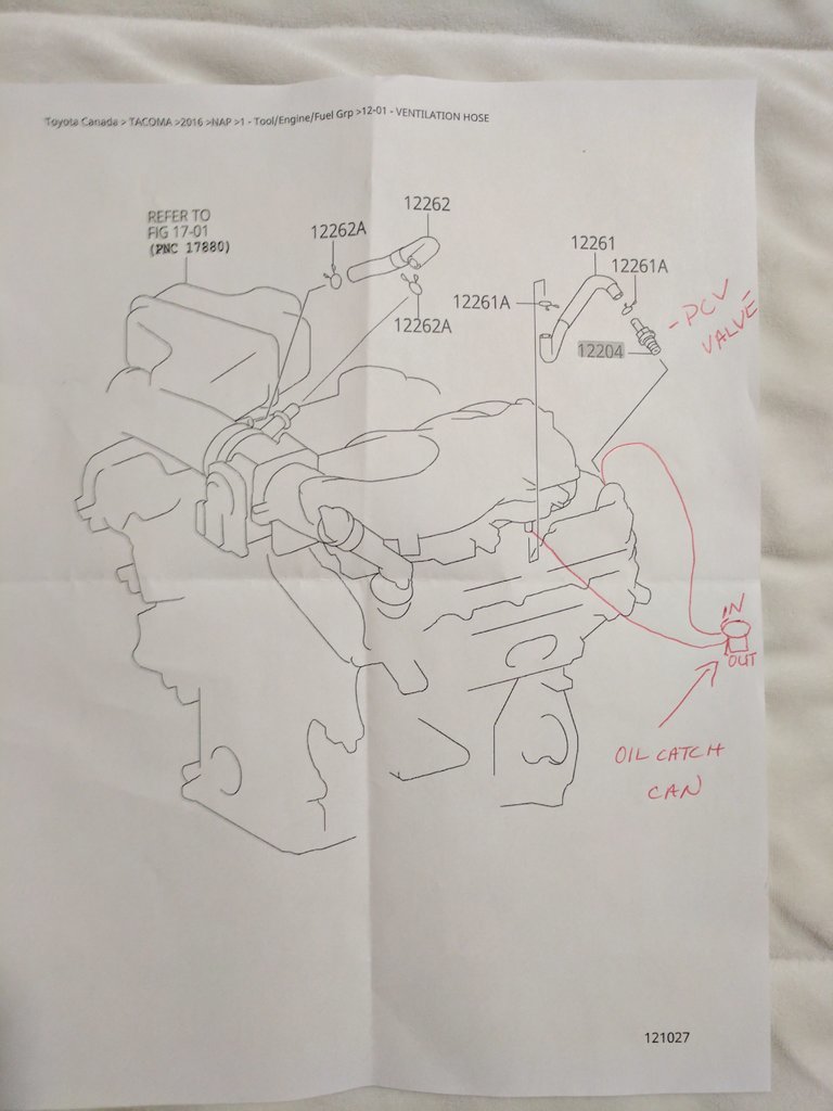

    I don't think the catch can will do much for the throttle body or upper plenum. I bet most of that comes from the breather tube right before it? Part 12262. But there are reports of it fixing the smoking so if you have that issue I can see a use for it. Or if you just wanna have one...
