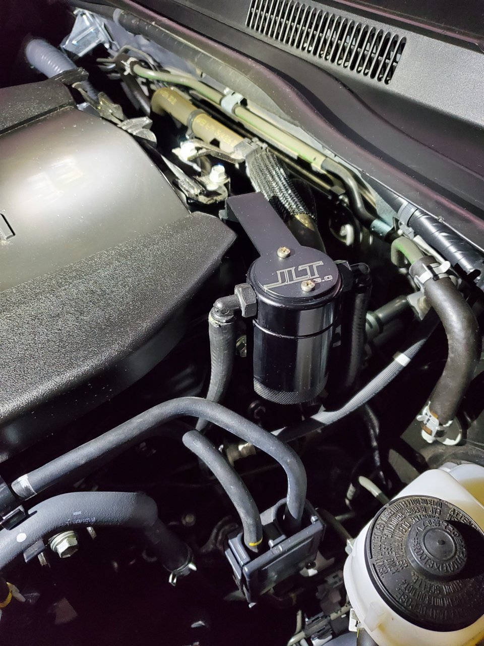

    There's a fresh air side and the crankcase vapor side. The side in your pic looks like the fresh air side.

    You are correct. Fresh airside is before the tbody.

    Well I put one in for the hell of it.
