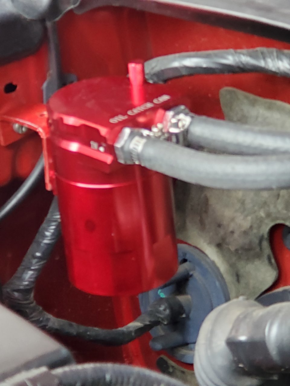

    Exactly, and you don't need to spend $100 or more for one. I got one from Amazon for $31 :)canada:) and to be honest it's a good value. My truck is red and so is the catch can.
    When I started looking for the best value I browsed AliExpress and Alibaba. Some are cheaper yet and color options. If purchased in bulk price drops down to $13:kona:and they will even engrave any logo...funny thing is that a certain $150 can looks a lot like an under $20...just saying, so I'm fine with generic...I may slap a TRD decal on it at some point...It may not have the brass filter but hey saving $100 is saving $100 that i can spend on something else :cheers:!

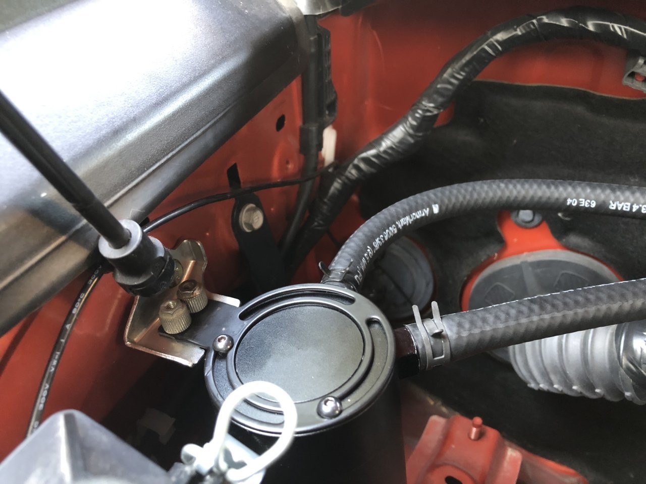

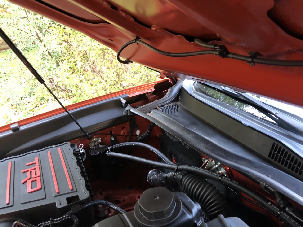

    Do you need a catch can? No. You don’t even need one with FI unless you are really over boosting this truck.
    is it fun to install things that make no difference, but allow you to take a photo of how much oil you collected? Yes
    My intake was fully doused in oil when I replaced the lower and upper intakes to put on my SC. The oil doesn’t really hurt anything though. The engine is designed for it.
    I put a catch can on anyways because it was fun and easy to do for $25.
    I used an existing m6 bolt hole by the air box and used a bracket that was removed during my supercharger install.
    DAS Taco and Bascoma like this.
