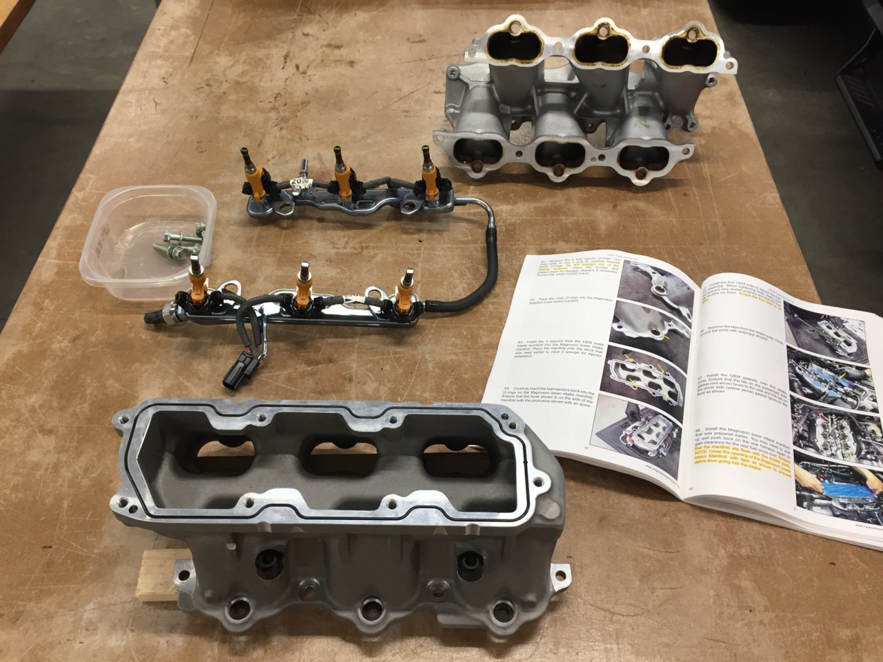

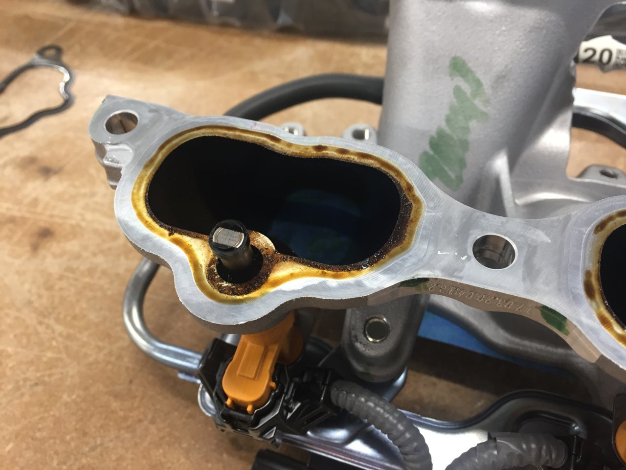

    I’ve got my 2020 apart to install a super charger.
    Check out the pictures of the stock intake after 3,700 miles. That’s 3,700, not 37,000!
    I’ve got a JLT on the bench waiting to go on at the same time. I figured it would be even MORE important on a boosted engine.
    B2F99542-F743-4013-927D-3A69186EE9B6.jpg 67904B75-330D-4396-A820-DE4F00CA5381.jpg

    That crazy. A lot of people say the can is not needed for a NA engine. I've had a can for about 20k now. I empty it about every 2k and it's 1/3 full.

    I JUST noticed the difference in the two banks in the first pic and I don’t remember wiping any of the surfaces. You can even see the difference on the tips of the injectors. The dirty bank must be the side where the PVC attached?

    The photos in this thread are discouraging. No wonder Toyota didn’t do full direct injection. Our Tacomas would need walnut blasted every oil change
