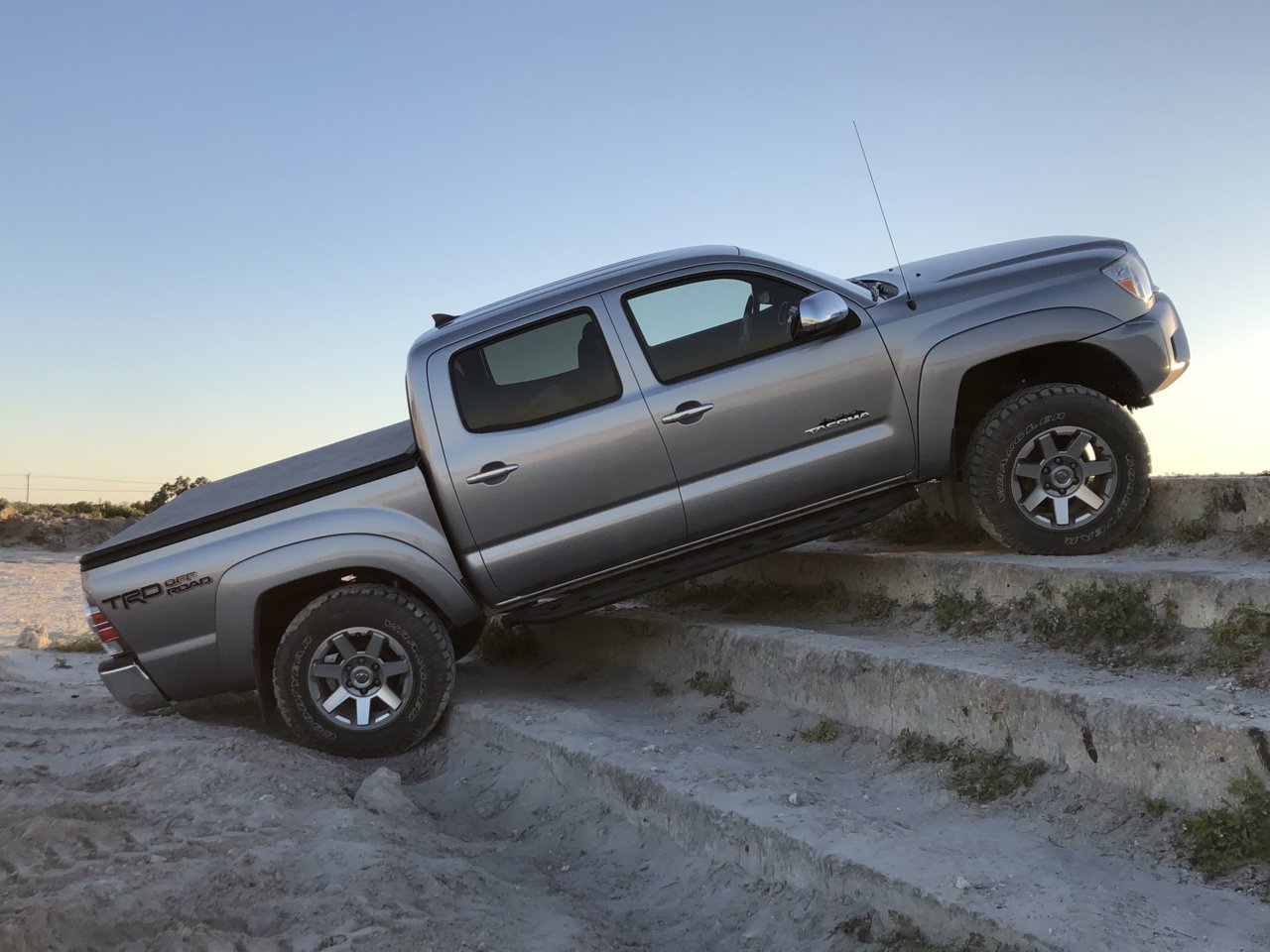

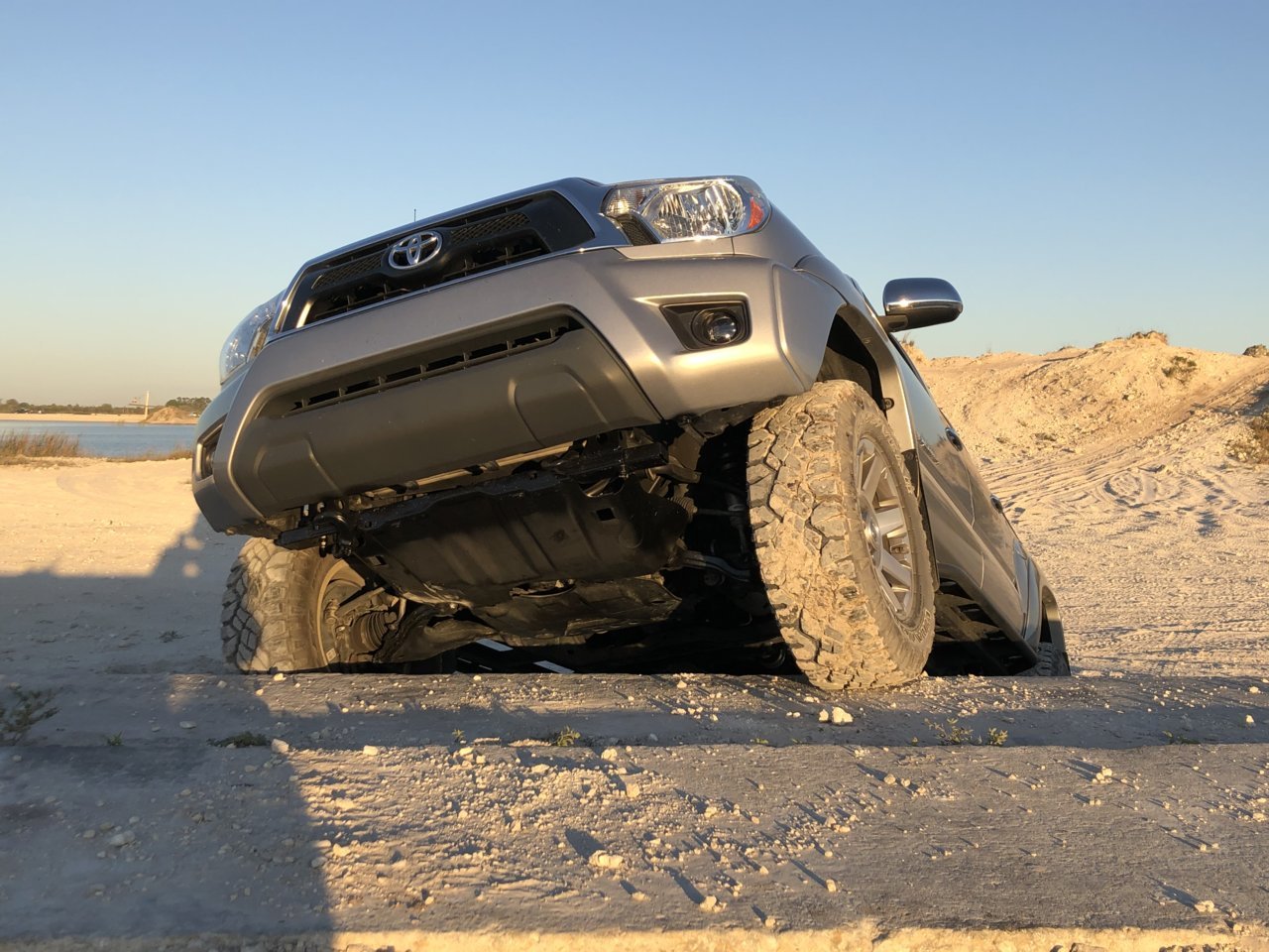

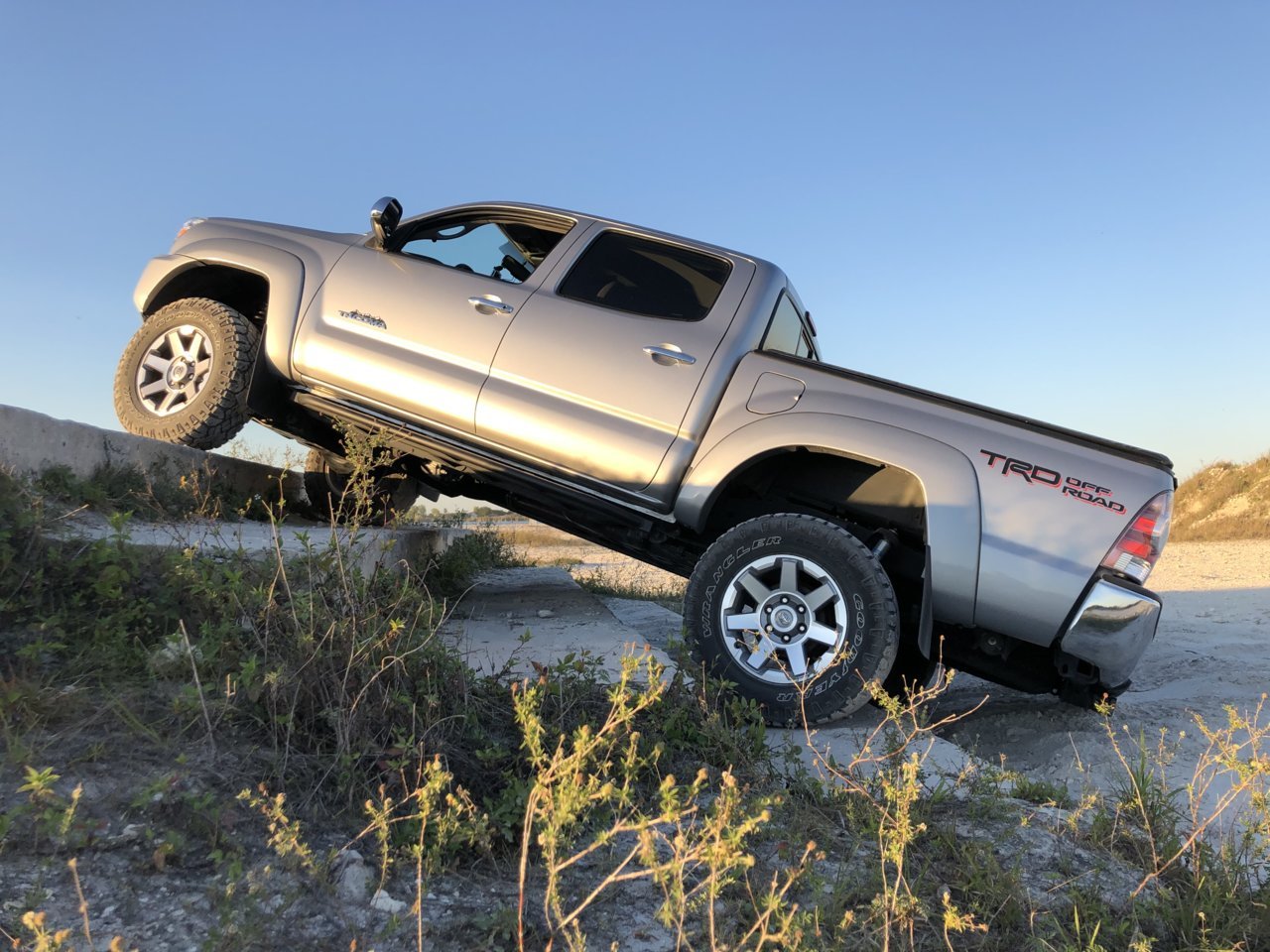

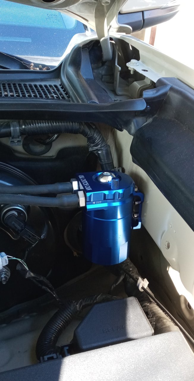

    I've always heard that catch cans are for high performance & forced induction engines. I do not know if a naturally aspirated non-high-performance motor will see any long term benefits to having one so I'm not here to argue that. I do know a few people with 392 Hemi engines that swear by them. Same as some people with turbo & super charged engines.
    What I DO see is that the catch can is solving a lot of peoples issues with their 3rd Gens in steep incline/decline situations. I've seen a few Jeep videos where the catch can has saved their engines as well. That's enough reason for me to buy one, if I had a 3.5 3rd Gen. You can't argue with results. Yes, if you install a catch can & forget about it then you're only prolonging the inevitable. I'm meticulous with maintenance & have no issues with checking the can for oil residue after any wheeling trip, during each oil change or better yet, buy a clear catch can.
    EXACTLY! I have yet to see 1 case of a 3rd gen with a catch can having the smoke-out-of-the-exhaust issue happen again.
    We can argue as to WHY @SRBenjamin had this issue but again, the catch can worked. Catalytic converters and mufflers are not designed to filter engine oil.
    BTW, who's running a clear catch can? How's it performing? I like the clear can better than the black one.
    I read somewhere on TW that the reason 3rd Gens have this issue is because the PCV baffle on the 3.5 is on the rear of the valve cover right under the PCV valve itself. On the 4.0 even though the PCV is located in the same area the baffle is located toward the front of the valve cover. You'd think Toyota would redesign that valve cover baffle location IF this is the cause of this issue but no one knows how much longer the Tacomas will bring these 3.5's since a redesign is probably around the corner.
    In pictures 1-3 (no idea on degrees of this angle) I had my truck in this position for almost 15 minutes with the engine idling. In that time I was taking pictures and guiding someone down the other side of the stairs before I got back in my truck & drove over. No smoke issues at all.
    In the 4th picture (no idea on degrees of this angle) I was in the truck, in drive with my foot on the brake & e-brake applied for almost 10 minutes because a truck on top of this ramp got stuck. No smoke at all.
    I'm not bashing 3rd Gens. Putting this issue & that stupid plastic coolant bypass piece between the 2 heads on the rear of the engine aside, these are great trucks. Just saying that the catch can has so far proven to eliminate the oil burning issue.
