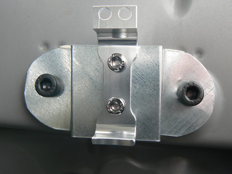

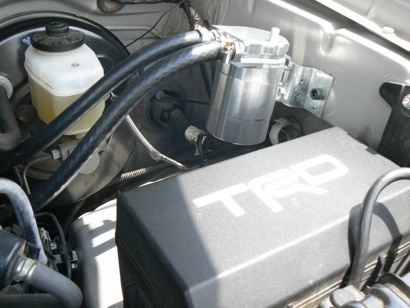

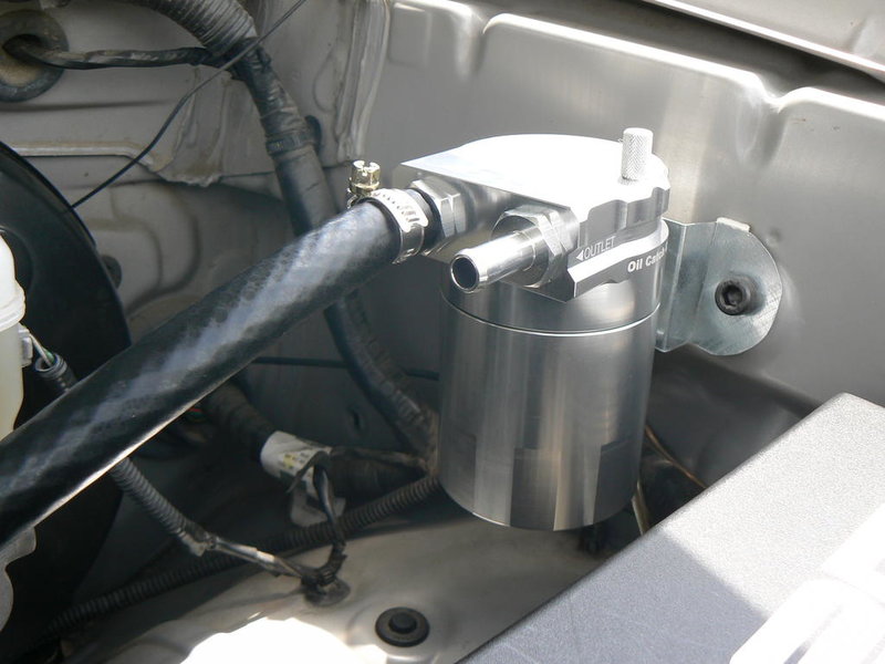

    Thanks to Detective Dan, I was able to install my Oil Catch Can with only a couple of hitches along the way.
    First I made a bracket to attach the Oil Catch Can bracket too. I made my first bracket out of a piece of aluminum flashing I had laying around. It came out great! I attached it to the pre-existing holes with M8-1.25 screws.
    Until I connected both hoses, then it began to sag. I was afraid it would continue to fall with driving conditions and start to hit the side fender wall.
    So, I made a second bracket out of a piece of stainless steel I picked up at Lowe’s in their lumber/fencing department. I’ve used these brackets for many other projects, and they work great.

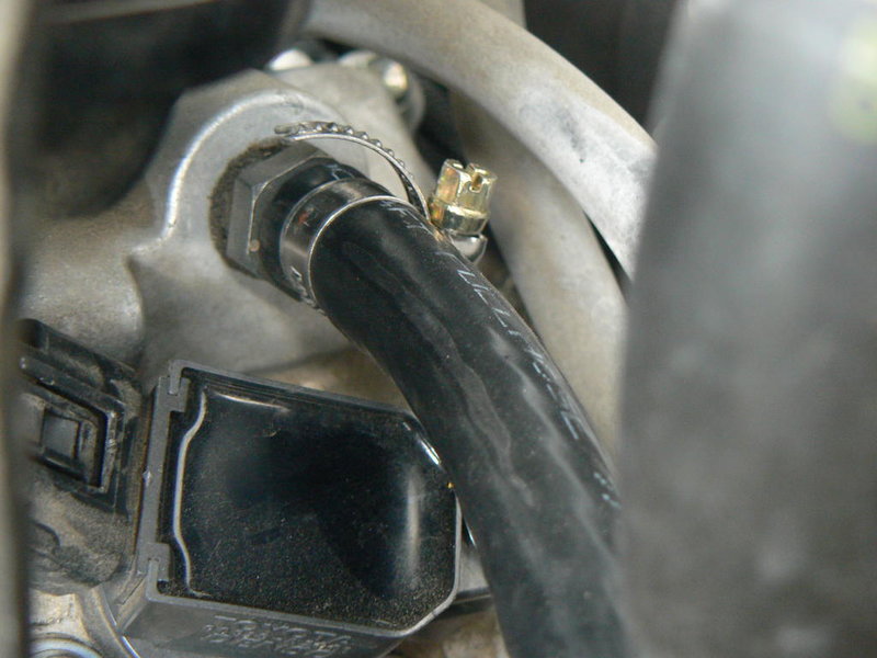

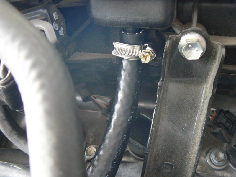

    Attaching the 7/16” hoses to the engine was not difficult.
    The hose I attached to the Inlet of the Oil Catch Can measured 19½ “.
    The hose I attached to the Outlet of the Oil Catch Can measured 18”.
    The only other hitch I had along the way was that I purchased 8 feet of 7/16" hose. Advanced Auto was great, and they allowed me to return the extra 5 feet of hose. Overall, a very easy project which I hope will prolong my engine life.

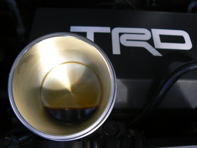

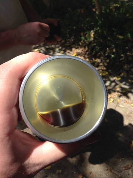

    Pretty astonished by the accumulation of oil I had in my Oil Catch Can after only 100 miles!

    I had just half of that amount after only 45 miles!. Amazing how much of this stuff actually gose into a engine. Love my oil catch can!

    167 miles !!!!! Good God!!!

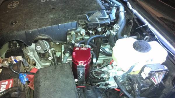

    Got mine installed two sundays ago. THe brakcet was actually a bit....interesting. Made it all nice to just bolt under the fuse box but the damn bolt wouldnt go in. So hand bent it (just 1/4" aluminum) to fit hole on the fender.
    Was a bit interesting though. Checked it after ~50 miles and found it was a almost beige color liquid with sludge in the bottom (not much just like a tsp). Cleaned it out and just went ~250 miles and its now looking like everyone elses (just oil!)

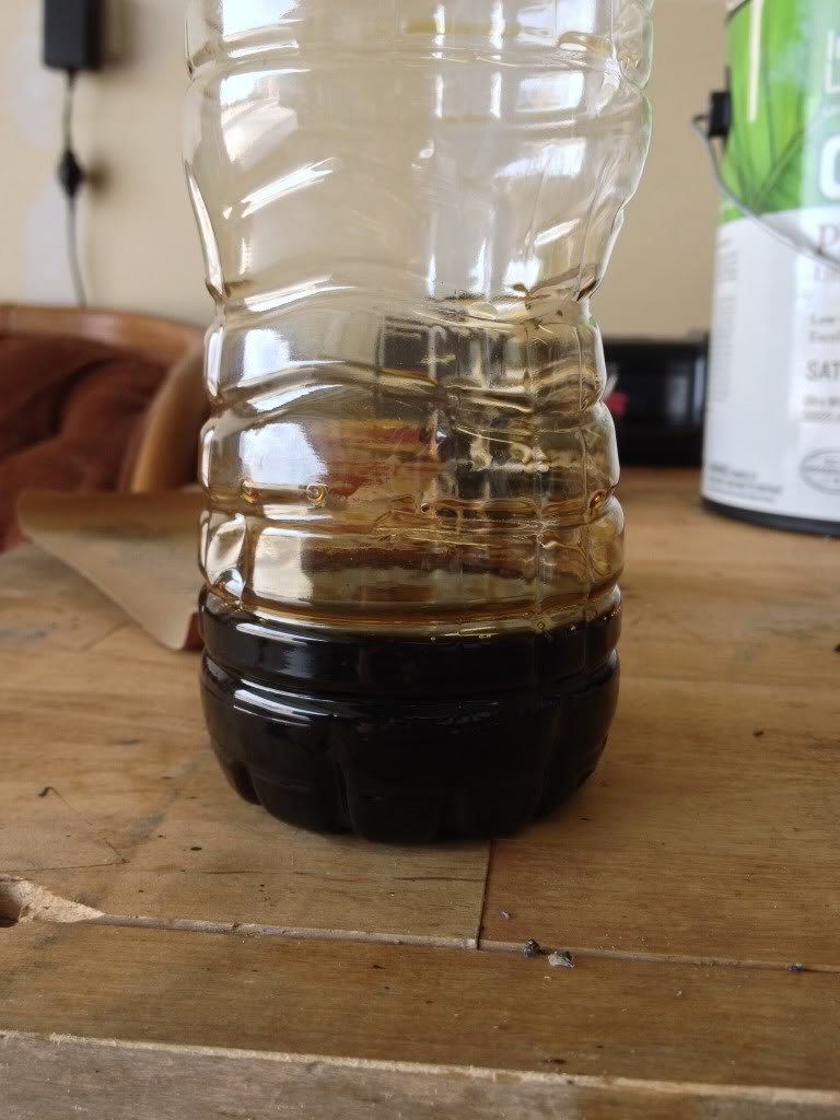

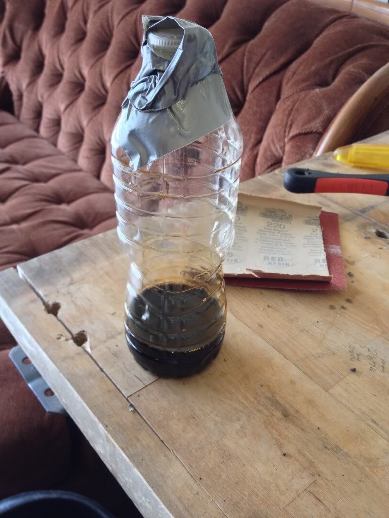

    heres what ive got after 2,500 miles exactly. this is a normal sized nestle water bottle. (duct tape is on it so it doesnt leak because im moving lol)

    Damn that is a clean ass picture dude. :thumbsup:
    Normally designed to clog up the cats. :/ One of these days, I'll get one on my Subi as well.
