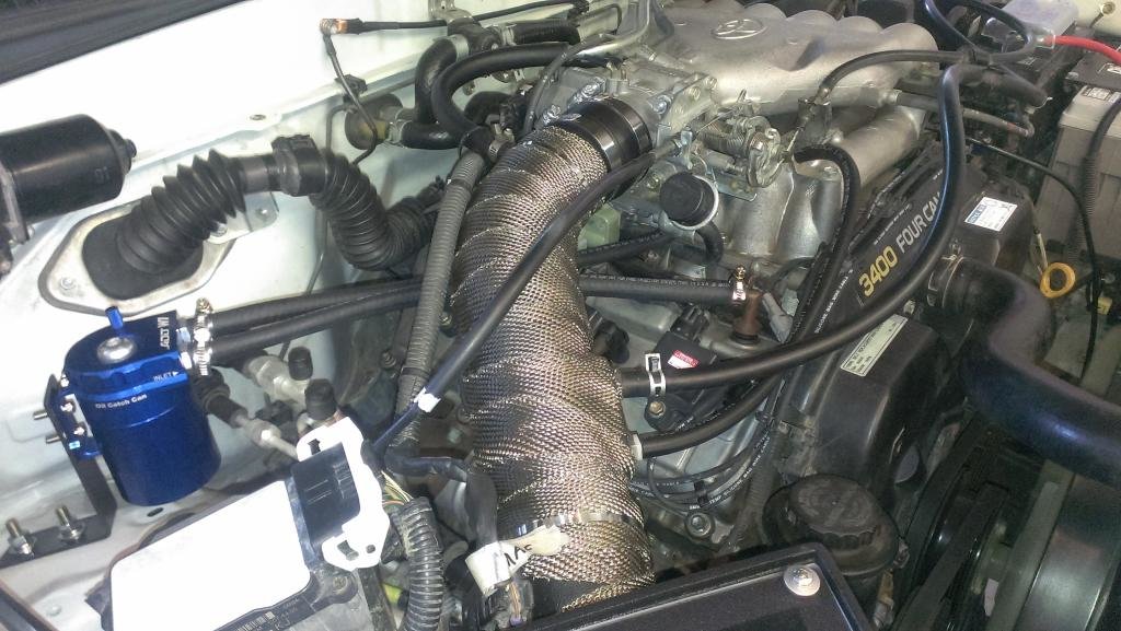

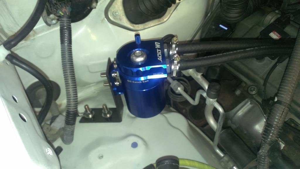

    Finally got the catch can installed. Looked at a few different install options and just decided to fab a bracket to bolt to a hole that was plugged with a rubber plug on the fender well.
    Here is a picture of the bracket I made attached to the catch can. I drilled several holes to bolt to the can in case I needed to raise or lower the height.
    Here is another shot of the can and bracket. I also install a rubber buffer so that the can would sit level and to take up some shock absorption.
    Here are some pics of the can installed. I did cover a couple of the various vacuum lines with some wire loom to protect them from rubbing against the braided SS line.
    Too bad the pics didn't show the SS line and anodized end links, it turned out really good and looks great.
    Thanks to everyone who helped. Thanks to Awf Rowd for the part numbers and Detective Dan for the tips on the ADD W1.
