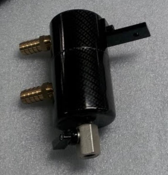

    Probably going to get version 2. I believe it had a DUAL chamber now

    Get the Version 1...you do not need the breather model..susceptible to CEL's...and is uneccessary..

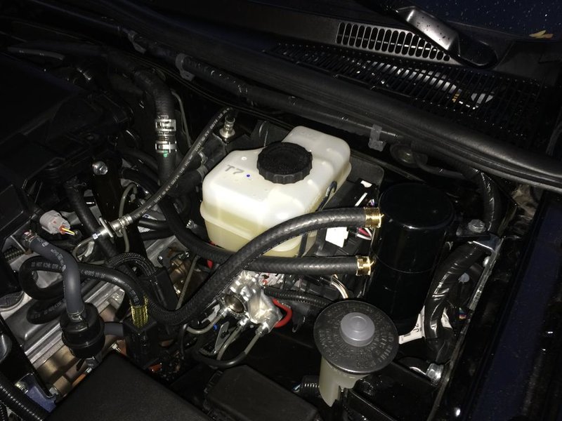

    I had a catch can from Bob's Auto Sports that I took off another vehicle and it was collecting dust. Put it on the Tacoma. Nice fit in the corner with an L-bracket.
    I'm a big fan of Bob's. I like the design of the air flowing up from the bottom and out of the top.
    I'm going to dress it up a bit with better fittings and hose, but it will do for now for sure.

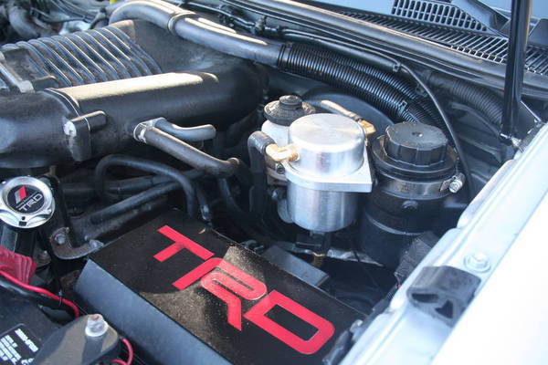

    Found a way to install my catch can in the limited space cause the cooling circuit of the SC.

    Very nice! What's holding it up?

    looks like a hose clamp on the black thing "not sure what it is" next to it.

    The black thing is the coolant reservoir for the intercooler.

    Yep it's a SS hose clamp welded to the Moroso can support and tightened to the coolant reservoir.
