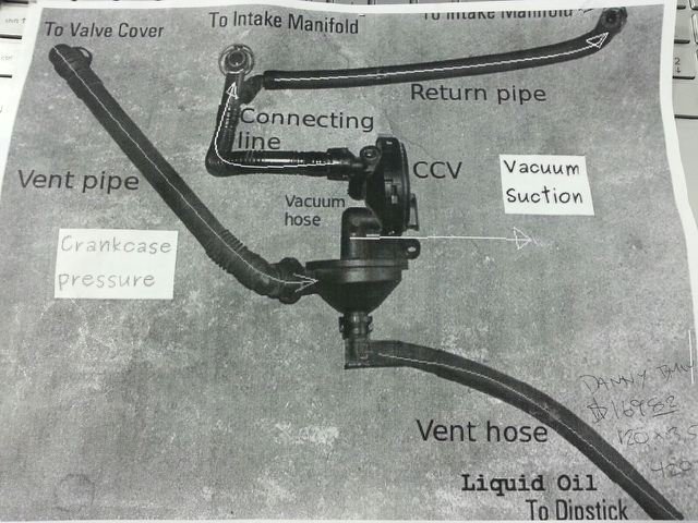

    OEM BMW. Doesn't waste the oil either. Very nice feature.
