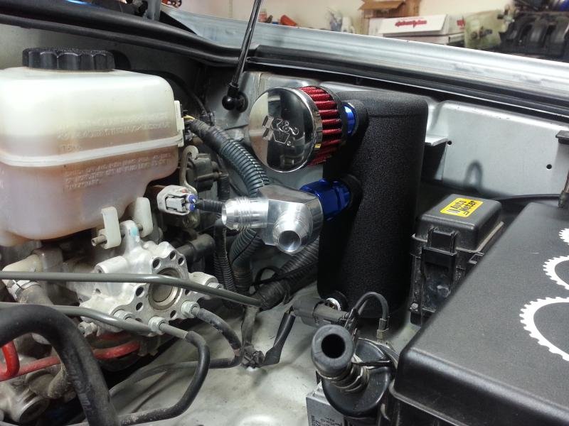

    DO NOT use the breather!
    Driver side valve cover, into can. Can into s/c. Top picture is the picture you need to follow, Conundrum. :thumbsup:

    Thanks, will check for mounting etc tomorrow, buy better hose then build a bracket. Have lath and mill at work and a good machinist. Just gotta find the right spot. Not as nice as yours Torspd, your engine bay looks awesome.
    Lord H don't know, he ain't got a S/C. I figured I wouldn't use the breather, our PVC loop is under vacuum, not like a non S/C engine.

    Thanks for the compliments, but those aren't my engine bay pics. Mine looks just a weeeee different.
    Now, as far as the similarities between the vacuum on the N/A and TRD S/C, they both suck the same. Literally. You cannot use a breather unless you separate the PCV system from the intake. Or a huge vacuum leak will be created.

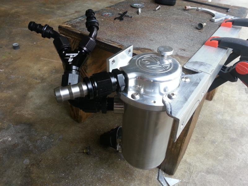

    Catch can routed specifically for turbo setup. Finally finished. :woot:

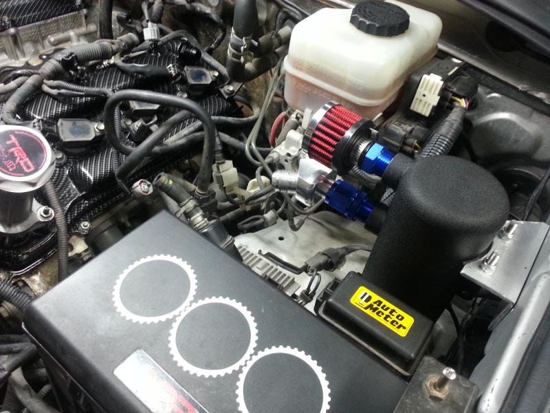

    I installed my can, WD-2 no vent breather since I have the SC, no major issues yet, not much miles. The far back in the corner behind the SC fitting came off easy and was easily reattached with new fuel grade hose. No CEL issues, checked connections every week while checking the SC cooling res (small leak) all is good.
    Making the custom mount to find a place was fun, but no worries. Not a lotta room in that engine compartment.

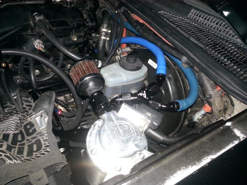

    This is what we accomplished on Lucario Runner's. Making the bracket, and making sure it cleared his OEM hood struts was the hardest part.
    His is setup like mine. Both covers feed into the can it vents to atmosphere. The intake manifold's port was capped, as well as the port on the intake tube.

    These AN fittings? We purchase them through www.Jegs.com or www.summitracing.com
    Lucario Runner ran -10AN to 1/2" NPT, on the can. The can's ports are 1/2"NPT.
    From the valve covers, we re-tapped the threads to 3/8"NPT, and used -10AN to 3 /8"NPT fittings. Then push lock fittings for the hose.
    I used -8AN.
    http://www.jegs.com/c/Fittings-Hose_Hose-End-Fittings/200705/10002/-1
    http://www.jegs.com/c/Fittings-Hose_AN-to-NPT-Adapter-Fittings/200709/10002/-1
    I actually prefer Summit Racing for the Eaton Aeroquip push lock fittings. Jegs fittings are Chinese. Summit has the Aeroquip fittings in black. http://www.summitracing.com/search/...4294920745&sortby=Default&sortorder=Ascending
