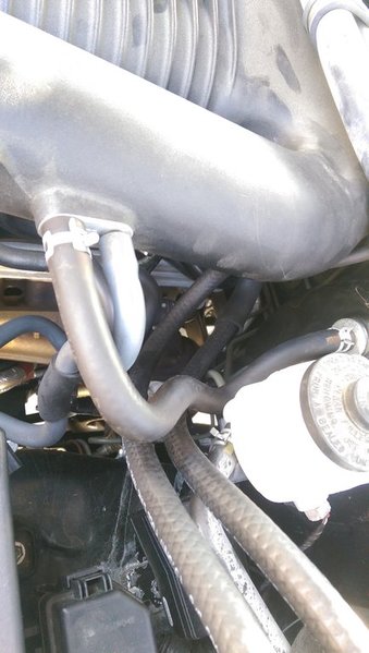

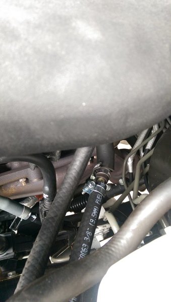

    Installed the catch today. Had to trim the dip stick cause it sat to high and I couldn't lower the bracket any farther due to the pump sitting behind it.
    Just joined the two hoes with a male to male adapter rather then try and get behind the engine to the port.

    Why not go directly to the motor? That's just an extra failure point you've created.

    I don't see how it would fail... And I will go all the way to the cover when I have more time to make enough space to get back there.

    How is not the worry, it's the possibility. Always easier to do it right the first time.

    So true you are. I have to get some fender clips (broke a few on dismantle) and I'll extend the hose when I replace the clips. Just wanted a closed loop for now.

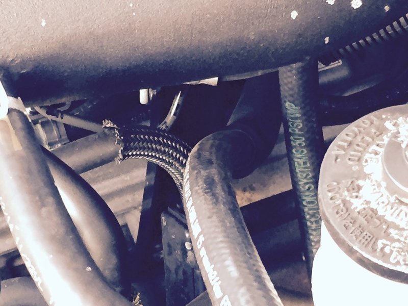

    Gaa that hose is so hard to reach. I didn't use a clamp, it's very low pressure any way. It slid on tightly, the original hose has that weak spring clamp, it slid right off.

    Tell me about it. That hose is somewhere under there.

    Fixed it

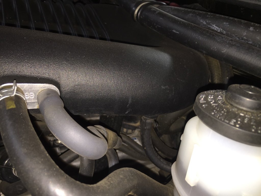

    Some of the things...
    My fat hands could barely fit so I just ran a hose coupler as well.

    I was bruised for a week getting that hose on. Needed one more joint in my arm.

    I think what helped me get it on the back port was my bumper. I was able to stand on the hoop and get up on top of the super charger.

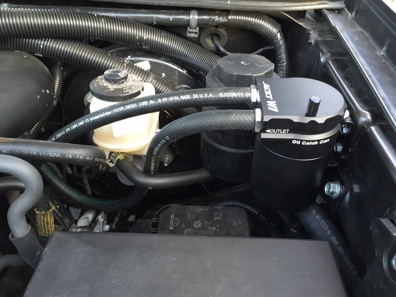

    Oil Catch Can
    35000mi update. Almost full bottle of PCV oil has NOT been recirculated into my Tacoma's intake. I interpret this as a Good Thing :thumbsup:
