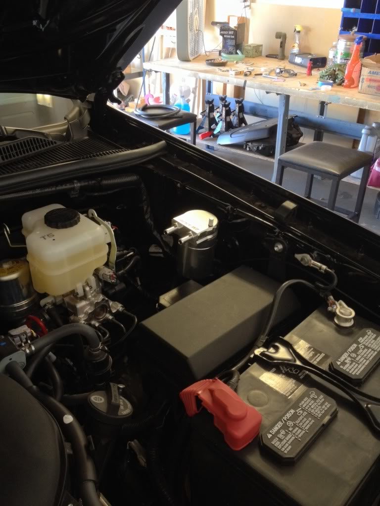

    Got mine mounted up. Didn't have room over the fenderwell because of the aux panel. Took a piece of 1/8 pre-drilled bracket from Lowes and bent an offset and mounted to the bracket. The dipstick has more than enough clearance despite how it looks.

    I ran a piece of flat bar aluminum from where yours is mounted and bent it so the can is next to the reservoir pictured.

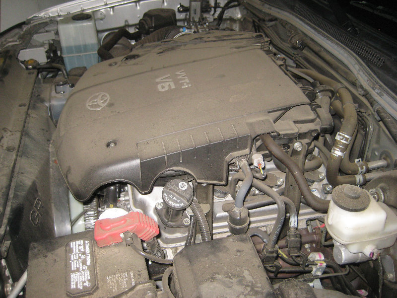

    I just scrolled spend 1.5 hours scrolled through 26 pages in this thread and not one single person has shown where is the PCV pipe I should remove from the engine to connect to the inlet :mad:. I mounted the can, only need to make the connections. Can anyone help? :confused:Put a picture or show me on the side of the engine which end to remove to connect TO the inlet? :angrygirl:

    In this pic, drivers side of engine, behind the bracket on the right side of pic. It's about an 8" long piece of hose

    On the drivers side, right behind the bracket that comes up off the engine onto the engine cover there is a hose that makes a 90 deg bend up into the intake. Follow that hose back down around the back of the engine about 8-10" where you cuss the engineer that knew he would never be reaching back there and that's the other end of that hose. That is your inlet to the catch can, outlet goes to where the 90 deg bend went up. Hope that helps.

    Can someone please draw an arrow or something? I see 50 hoses that fit the description.

    Out of those "50" hoses, how many of them go from the valve cover to the intake? 1 is the most likely answer......
