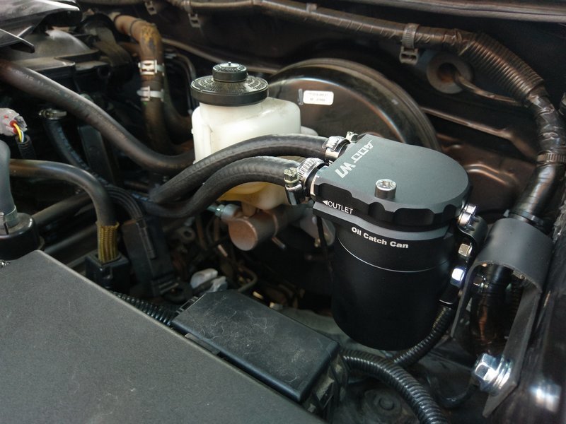

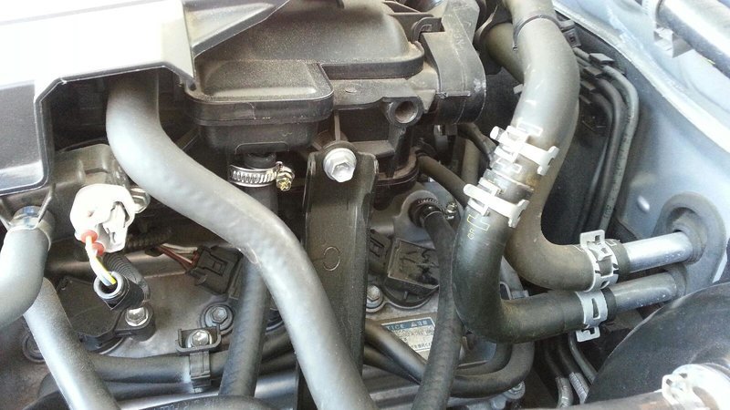

    Thanks so much @ThomasMore66 : So Is it this end of the hose where the arrow is pointing to?

    Yes that's it :thumbsup: Here's mind if it helps:
    Right tube goes to the PCV and left tube goes to the intake:

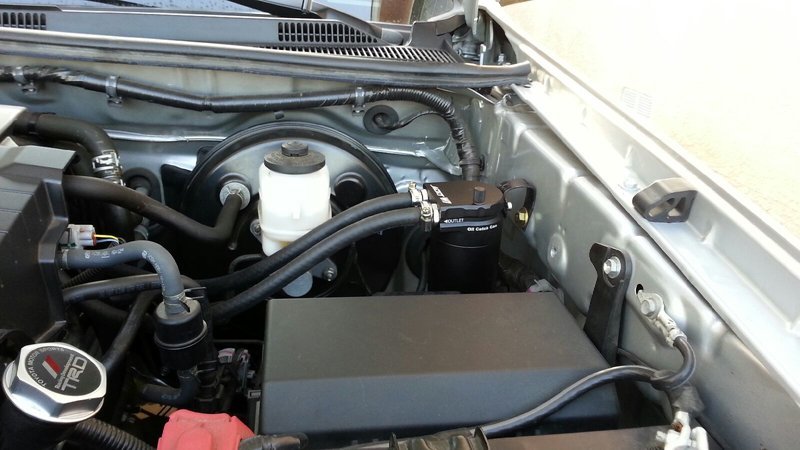

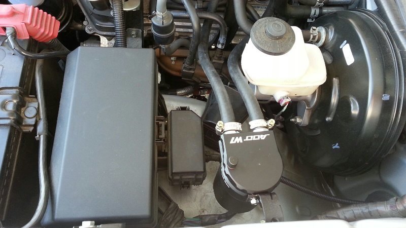

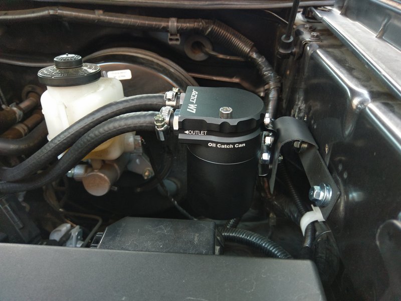

    This is what we installed yesterday. He got a corner bracket, drilled some holes in it, and then installed it a bit away from the wall, because the fusebox is also going where the two screws are. Looks neat. I took some snaps afterwards.

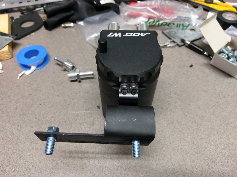

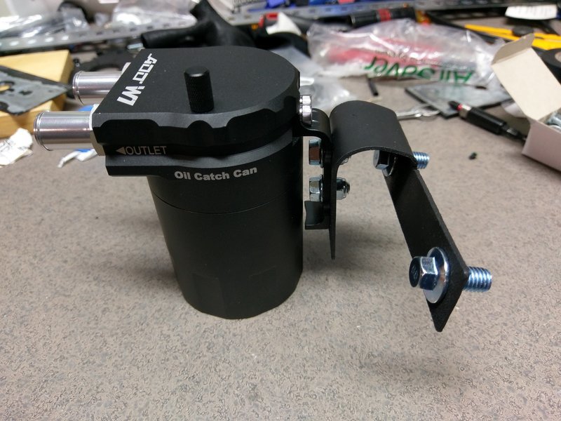

    Fabed up a bracket from aluminum stock at home depot. This will satisfy my mod bug for a week.

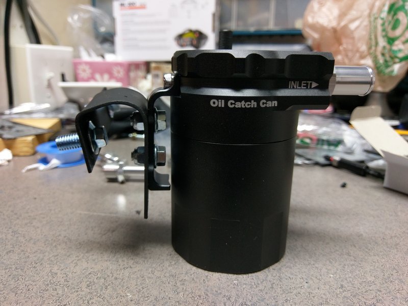

    Where could I get that little O-ring?, and what is the part number (if any), and additional tips would be helpful too.

    The plumbing aisle at Lowes or home depot, usually near the sink repair parts. There will be hundreds of sizes of little O-rings.

    Installed, pretty easy. I replaced the dip stick with a bolt.

    Why?

    I plan to empty the catch can every oil change and the dipstick is a potential air leak if no sealed. Some folks add an o ring, I just removed it and replaced with a bolt and Teflon tape.

    @itaro - Damn, thanks for the heads up. I just don't trust the dipstick to keep a good seal since you can't really torque it down.

    Put the wee o-ring on it and you won't have any problems.

    Its a B*TCH to get a hose to the PCV nipple with the SC in the way, I accidentally pulled it off when trying to connect it to the SC (and freaked out). Did anyone use a worm clamp (or any sort of clamp) to the PCV? The stock one that's on there now seems like its not doing a great 'clamping' job.
