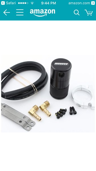

    Thanks everyone for sharing your experience with this Mod. I just ordered the Moroso Air/Oil Separator, Part# 85497 From Summit. I'm hoping it will
    Do the job. Here's a picture off Amazon.

    Can't go wrong with a quality brand like Moroso :thumbsup:

    Thanks Nick! It seems Well built. I'll be installing it soon!

    Need to see if I have to MacGyver a Bracket or not. If I do I want think out my best options.
    Next I want to research the size of the PCV hose barb. Thanks.

    It should be 3/8" for the PCV hose. That's what I used.
