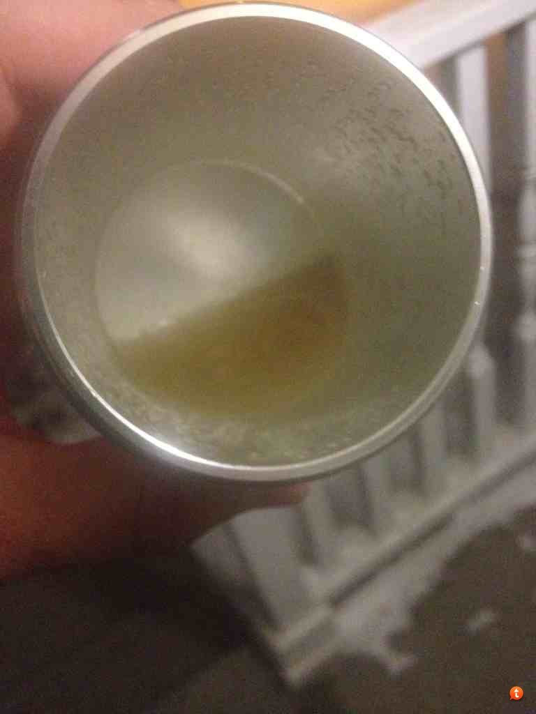

    Here is my can after 100 miles. Smells of fuel but I know it has fuel, oil and water vapor in it. A lot different than dans.

    Mine had a strong fuel odor to it, but was mostly oil.

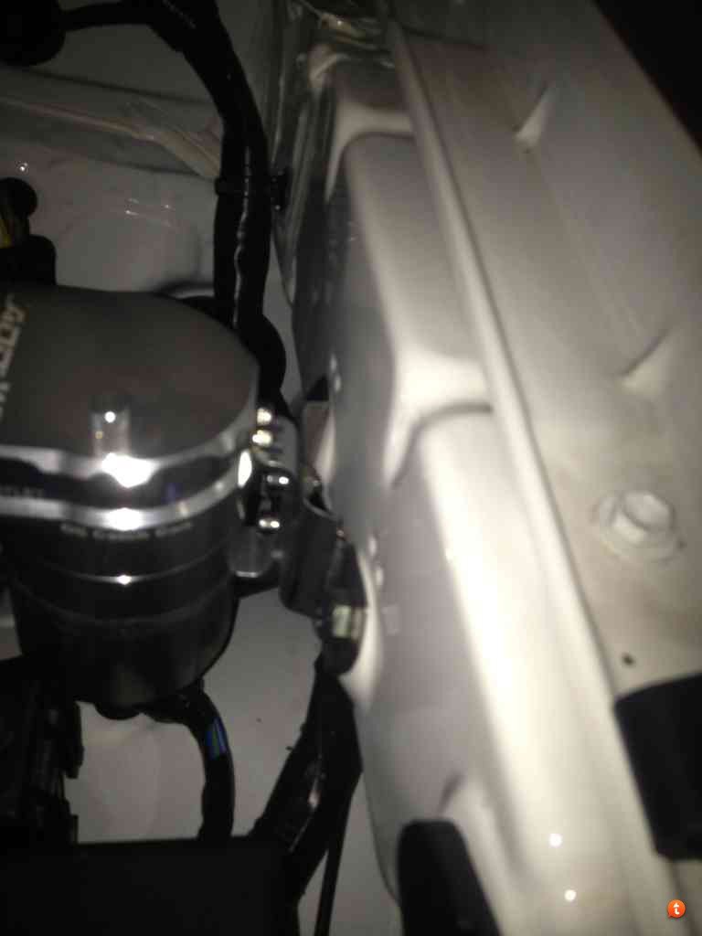

    Anybody have any mounting ideas I got a 13' 4.0 6speed the clutch master cylinder is in the exact place I was going to mount my can any help would be appreciated.

    Get enough fuel line and you can mount it damn near anywhere you want. Just make sure the hose doesn't sag too far or kink and you can put it in any open area of the engine bay

    heres how I mounted my can with a 6 speed 4.0 4x4 13' dblcab. And no CEL

    I used a piece of 1/8 flat stock that I had laying around and made the bracket to attach my can looks pretty good to me
