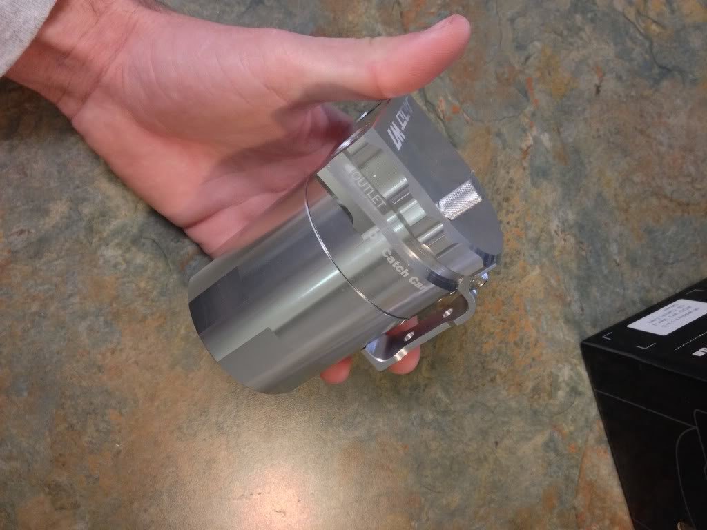

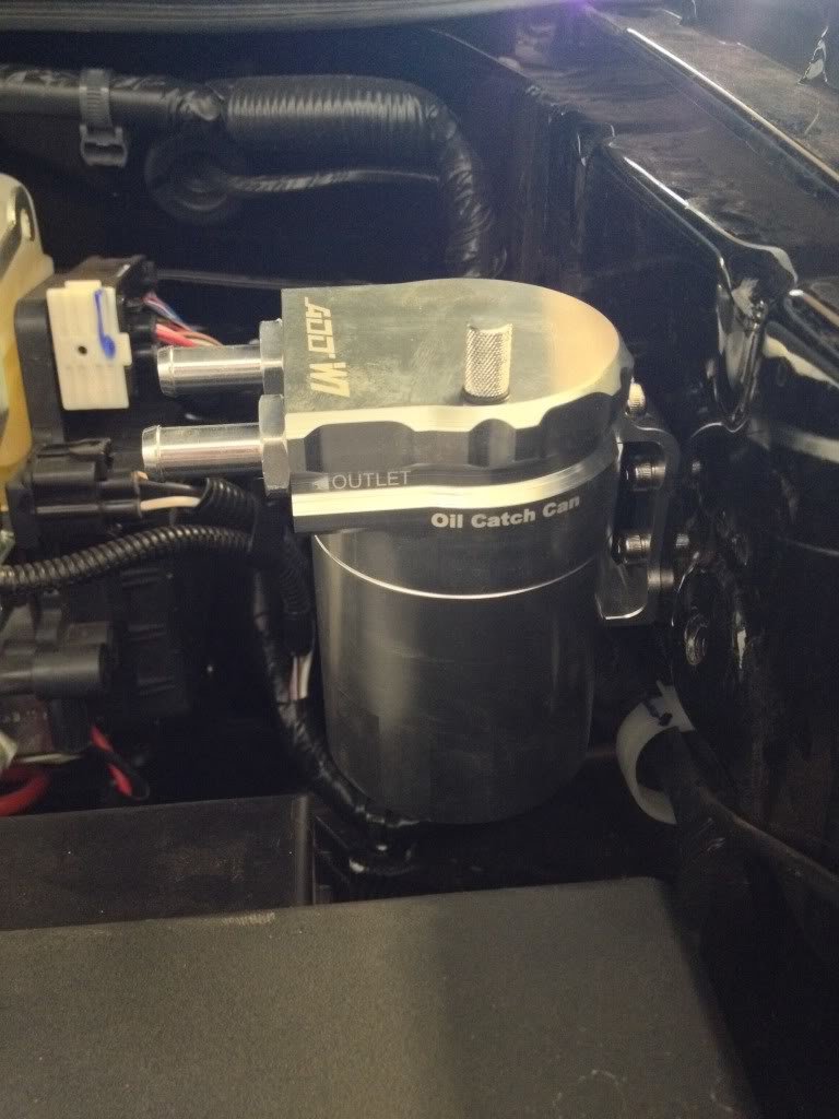

    Thanks for sharing, I'm going to pull the trigger on that one. What size inlet and out let fitting should I go whit?

    Your hoses are 3/8", so whatever they offer to work with that.

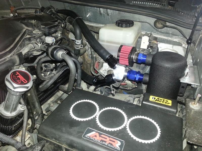

    When used in line with the vacuum routing, you do not want a breather on it. That would be a source of a vacuum leak.
    Those with a breather, such as myself, have completely changed the vacuum routing to prevent a vacuum leak.

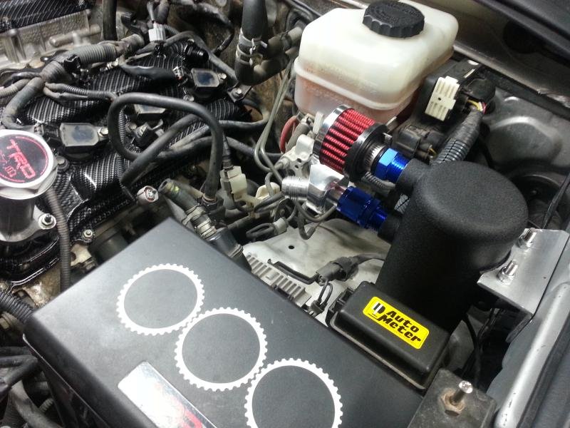

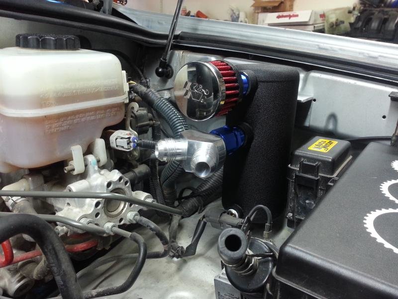

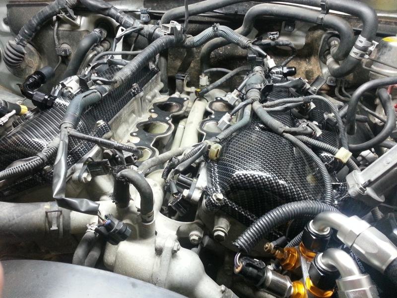

    "Taken from his build thread.
    Took just a few during our weekend's modding.
    These hydrographic covered valve covers look simply stunning.
    We modified the PCV ports so that they would accept 3/8" NPT to -10 AN fittings, for the catch can rerouting.
    Then came can installation and custom bracket.
    Here is how we did it to his."

    I guess I don't understand. It looks like you don't have Positive Crankcase Ventilation. Where is the return line to the intake?
  12. Oct 23, 2020 at 4:23 AM
    #632
    Torspd
    Torspd Tor-nication
    Sep 18, 2009
    #22958
    26,439
    Tor
    The Great America!
    MMVI 4.4L 4x4 Access Cab
    Torspd Custom Turbo kit [] Borg Warner 9180EFR Turbo [] Haltech Elite 2500 [] TiAL Q BOV [] TiAL V44 Wastegate @ 15psi [] CP Pistons [] CP Carrillo Rods [] ARP Head studs [] ARP Main Studs [] ARP Header - Head Studs [] Ported Heads w/ 1mm oversized valves intake/exhaust [] Brian Crower Forged Stroker Crank [] Darton M.I.D. Sleeved Block [] Kelford Camshafts [] Torspd 160* T-stat mod [] APR Large Fuel Rail [] Walbro 460 LPH E85 Fuel Pump [] FueLab FPR [] APR T56 Conversion Kit [] KP RACING Built T56 [] McLeod Racing Custom Twin Disk Clutch [] One Piece Aluminum Driveshaft [] MGW Shifter [] Custom lowering kit [] Ohlins Front Coilovers [] QA1rear shocks [] Custom Ron Davis Radiator [] Dual SPAL Electric Fans []
    There isn't one. The blow by from the ring gaps alone is enough to cause a pressure, which is then evacuated through each valve cover, into the catch can.

    And then vented to atmosphere? So you're relying on the positive pressure in the crankcase to push vapors out, instead of vacuum created in the throttle body/intake to suck it through?
  14. Oct 23, 2020 at 11:53 AM
    #634
    Torspd
    Torspd Tor-nication
    Sep 18, 2009
    #22958
    26,439
    Tor
    The Great America!
    Correct

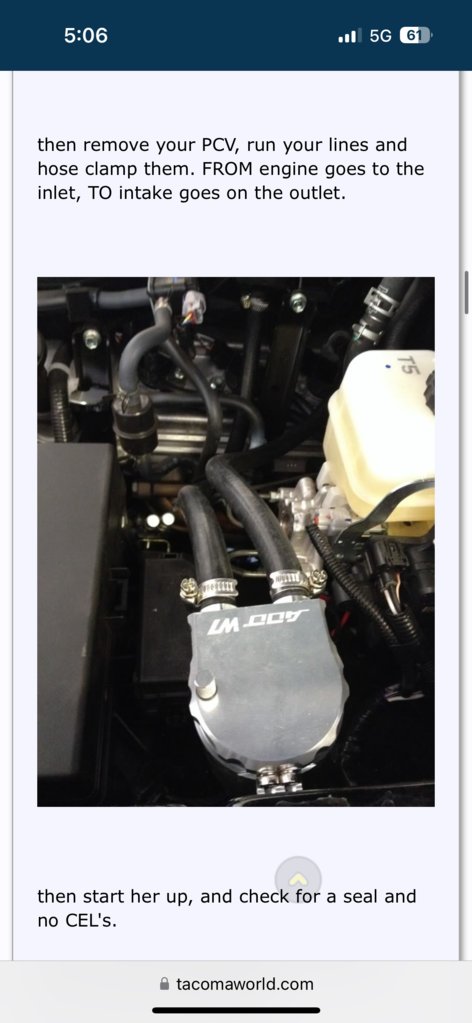

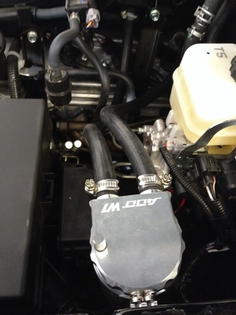

    where does the inlet come from and where does the out go to?
  17. Feb 12, 2025 at 5:25 PM
    #637
    Scott B.
    Scott B. Well-Known Member
    Nov 11, 2014
    #142118
    4,476
    Scott
    Georgia
    2015 ACLB SR5 4x4 Expo
    PCV -> catch can -> PCV port on intake manifold.
    You are tapping into the PCV -> intake manifold hose.

    im not boosted. I just don’t understand how a catch can works. Idk where the hoses have to go. I’m trying to figure that out because my intake was all gunked up.

    Installed in the PCV hose/line, a catch can separate oil vapors from the PCV system, "filtering" aerosolized oil from air before it re-enters the intake.
