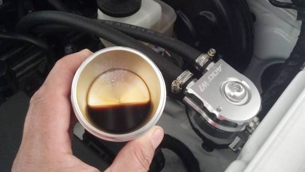

    The hose is good, let my truck run and checked if it could handle the vacuum and even squeezed it. I'm just worried about the length of it, but after 100 miles I had quite a bit of oil. Not as much as Dan had but close.

    I used Napa fuel line and it's good stuff I bolted the bracket I made using the existing bolt that hold the fuse block down to the top of the fender and it works perfectly. The can has been installed for 300 miles now and I opened the can and there was about 3-4 tablespoons worth of nasty coffee colored crap at the bottom so this can has paid for itself already in my eye's to bad I wait till 22,366 mile to do this Mod. I recommend this to everyone. :)

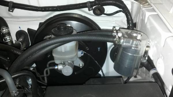

    First time posting. Installed the ADD-W1 last week. Used a single M8x1.25 bolt to mount to factory hole in bay, used Autozone 3/8" fuel line hose, placed an O-ring on the dipstick, stainless steel scrubber (not wool) inside in the baffle. Perfect install, no CELs. Checked at 400mi, already collecting, doing it's job. Worth the investment.
    Thanks Detective_Dan for the inspiration!
