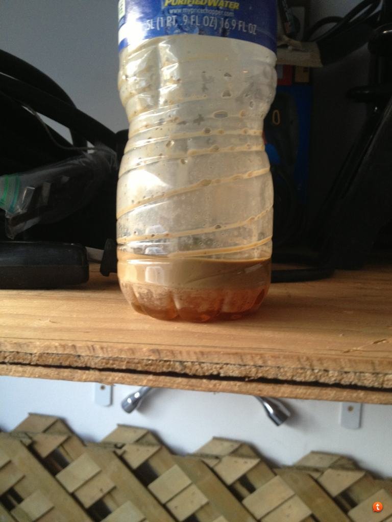

    I emptied mine today. Here is what came out.

    250 km and this is what I got in mine. Also for the install i used oil coolant hose instead of fuel line!

    whats curios to me is how some peoples caught oil looks like gross chocolate milk, but in mine and some others cases, it just looks like normal oil with a fuel oil smell to it. anybody have an answer for that?

    My fluid also had ice particles in it, as it is sub zero temps still, not sure if that had anything to do with the colour?!?!

    forgot to mention that all my driving is 98% highway! not sure if that has any affect on colour either! maybe it just condenses different at higher RPM's and temps!

    If something looked like that coming out of your engine, you'd think you had water in your oil or a head gasket leak. But what you're collecting is gasoline vapor, condensation, and oil mist that mixes together into a slurry that looks like stool.

    ok, i guess its just different engines do different things. mine just looks like regular 30w oil, with a gasoline smell to it.

    My old 5.4L use to do that. Take the oil cap off and it was milky white.

    I'm going to say moisture. You will get condensation everywhere depending on temperature differences. Colder climates might get a little more condensation.
