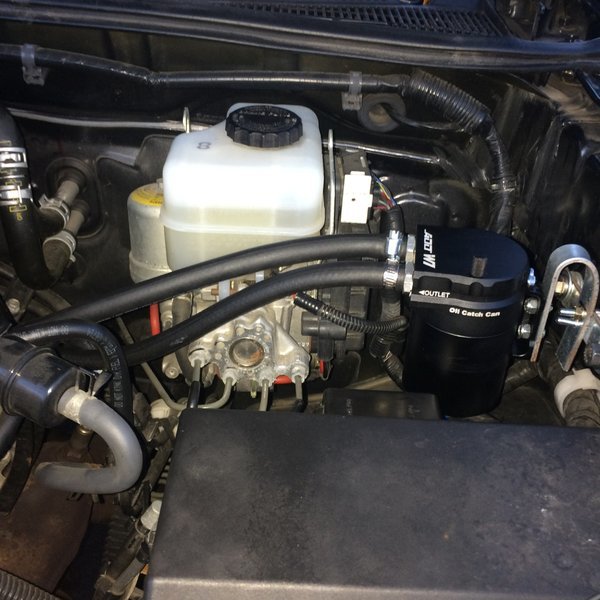

    What did you make your bracket out of? Mine below is hoakey but does the job for now.
    Installed!! Keep you guys posted on what I collect and mileage.

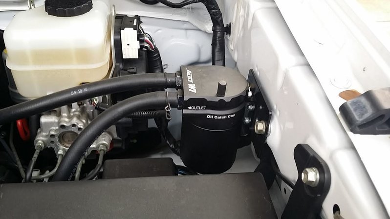

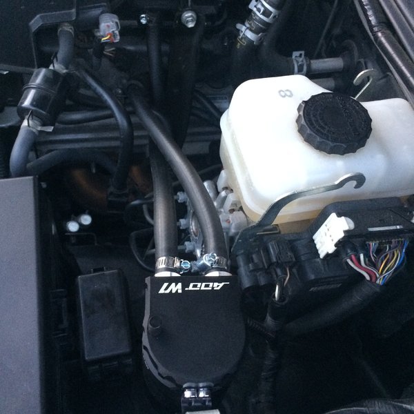

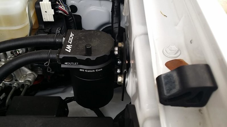

    here you go ,I"m going to paint the letters black , no chrome hose clamps , and also no ID stuff on the hoses . I do not want the Ca. SMOG MAN to see any PVC upgrade stuff !unnamed.jpgtttttttttt.jpg unnamed.jpg11111111111111111111.jpg

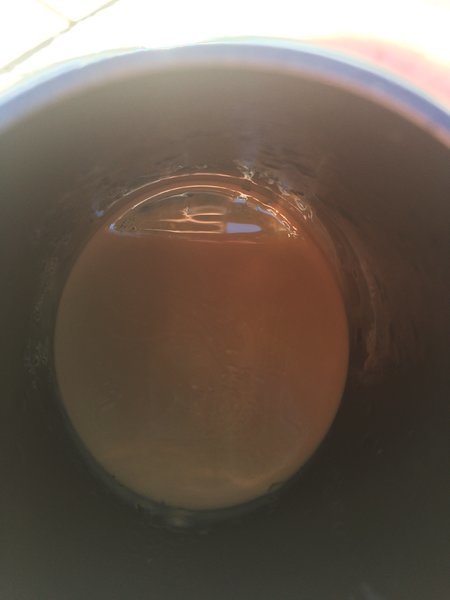

    800 miles, didnt measure nor empty til oil change. But holy cow!!!!!

    Where are the lines routed 'in and out'?

    So follow your egr hoses and the port coming out of engine block, back of motor, goes to the in side of catch can. Out side of catch can goes to in port of egr valve. Buy a good catch can, baffled preferred, good 3' of rubber hose, fuel line that wont collapse, and 4 hose clamps. Make sure hose clamps are good and tight so you dont get an air leak. The hardest part is mounting this thing, fabricating a bracket.
